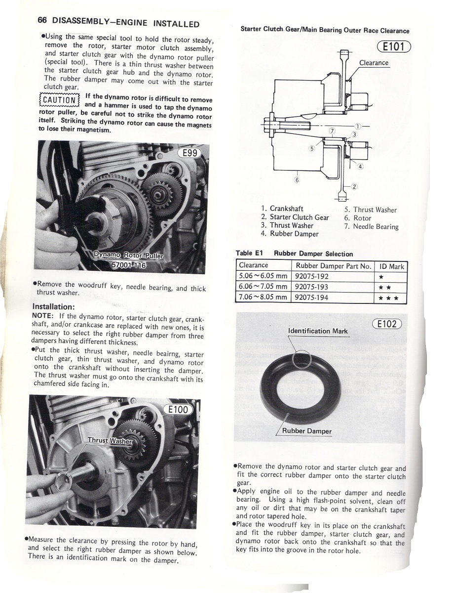

If there's too much drag it will spin the starter and you will hear the starter whining.
You shouldn't have to resort to going that far though if you use your judgement now while the cover is off.
If you can move the starter clutch gear anti clockwise by hand with fairly light pressure it is ok.
If it is very hard to move or locks solid when the rotor bolt is tightened then you need to reduce the thickness.
The damper is only there to keep the starter gear from floating about too much and rattling.
