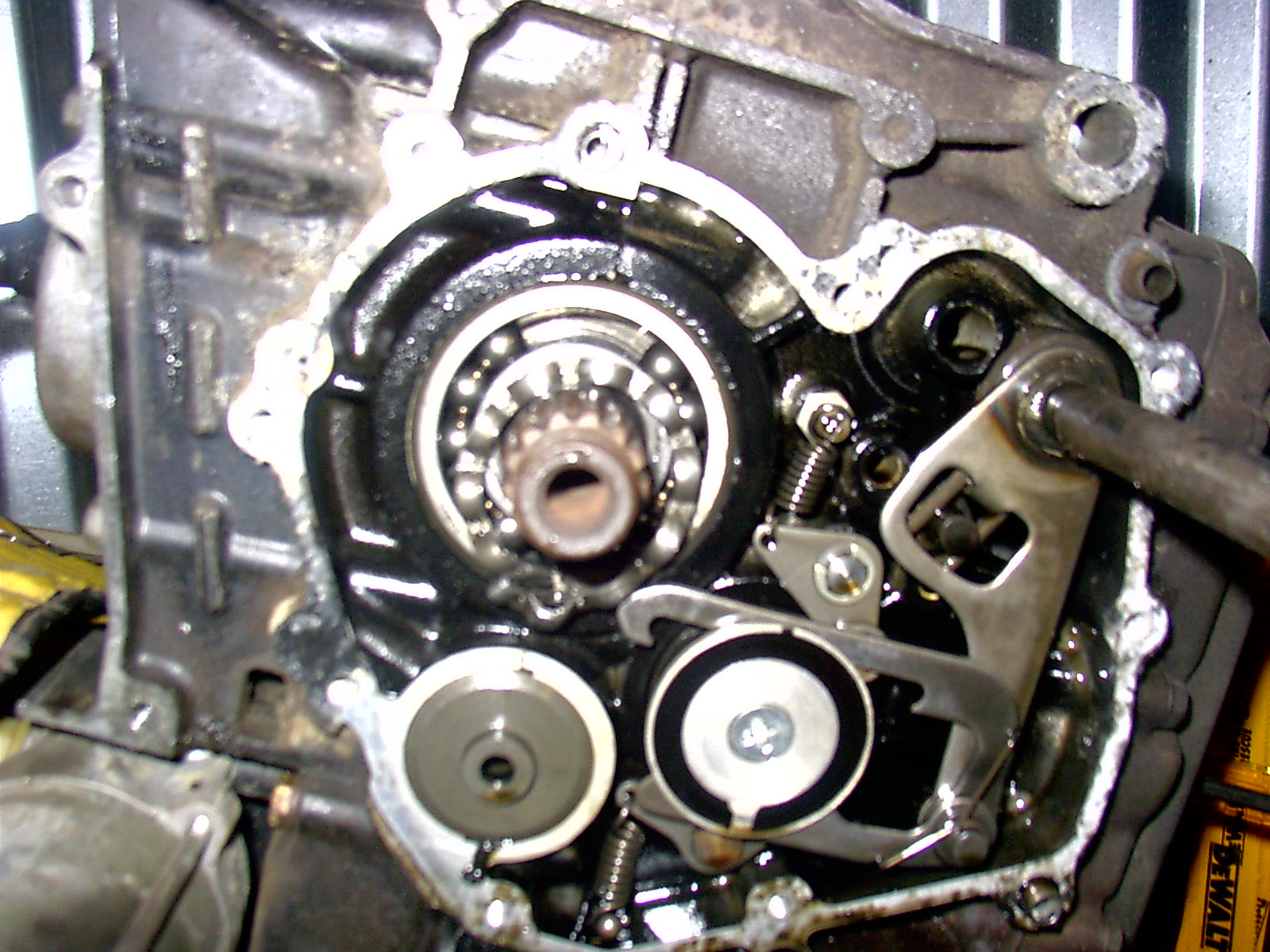

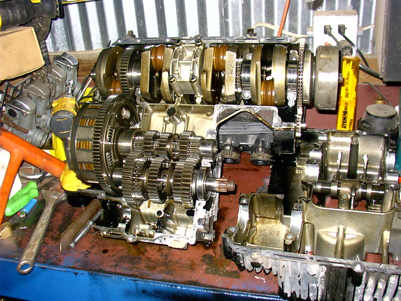

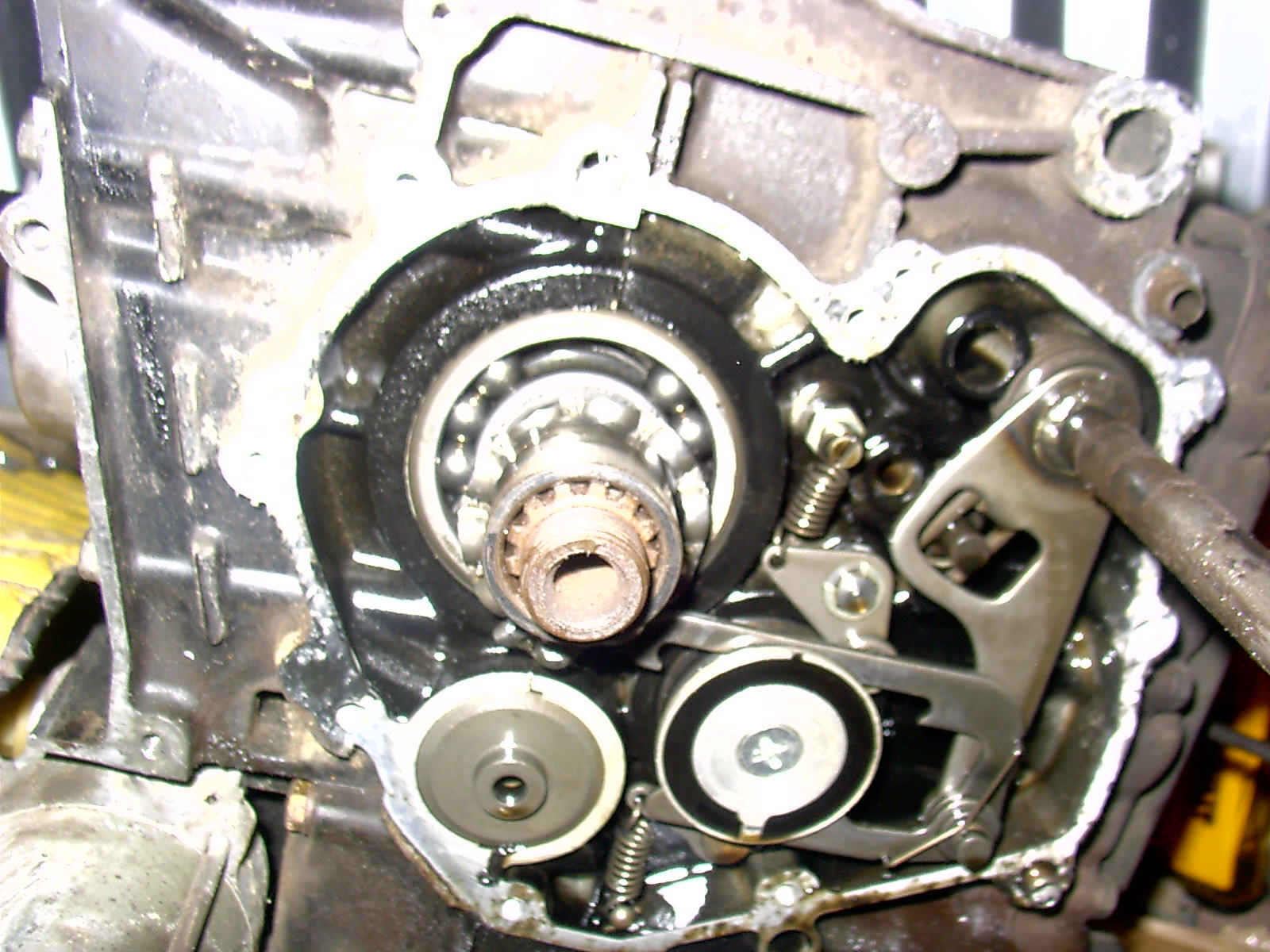

i hesitated to day anything earlier because i was hoping it would be something else.
and it may still be.
but,
i had a cage come apart on my output shaft bearing on my 80 z1r
and when the bearings roll over the top it gives this intermittant clicking sound.
i could roll my transmission through buy hand and hear it.
it still had the right amount of balls but it would let em all bunch up,which in turn gave the output shaft enough slack to jump around and cause some pretty violent reactions ion my drive line. :sick:
being as how i am posting pics here is the bottom end on my 80 all laid open.
but,

Thanks for posting that Leon. That could definitly be what it is. Did you have any problems shifting at all? Mine shifts fine but a little harsh.
That last picture is almost as good as a service manual. You really get to see how everyting works togther. I've got a chance to pick up a complete 84 gpz1100 so I might just swap engines and sell the other parts I've been collecting. What do you think a complete GPZ1100 engine is worth with high mileage?
