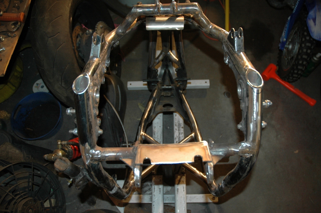

Here we go......

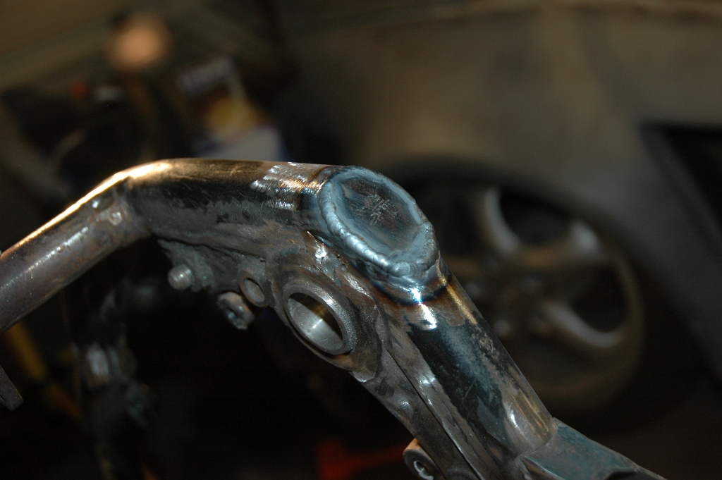

I wasn't real happy with my first bottom tube caps. They were more of a "I'll get back to these later" solution. Later has come and gone, and now that I want to paint my frame, I needed to take care of it. I sliced off the first hideous caps:

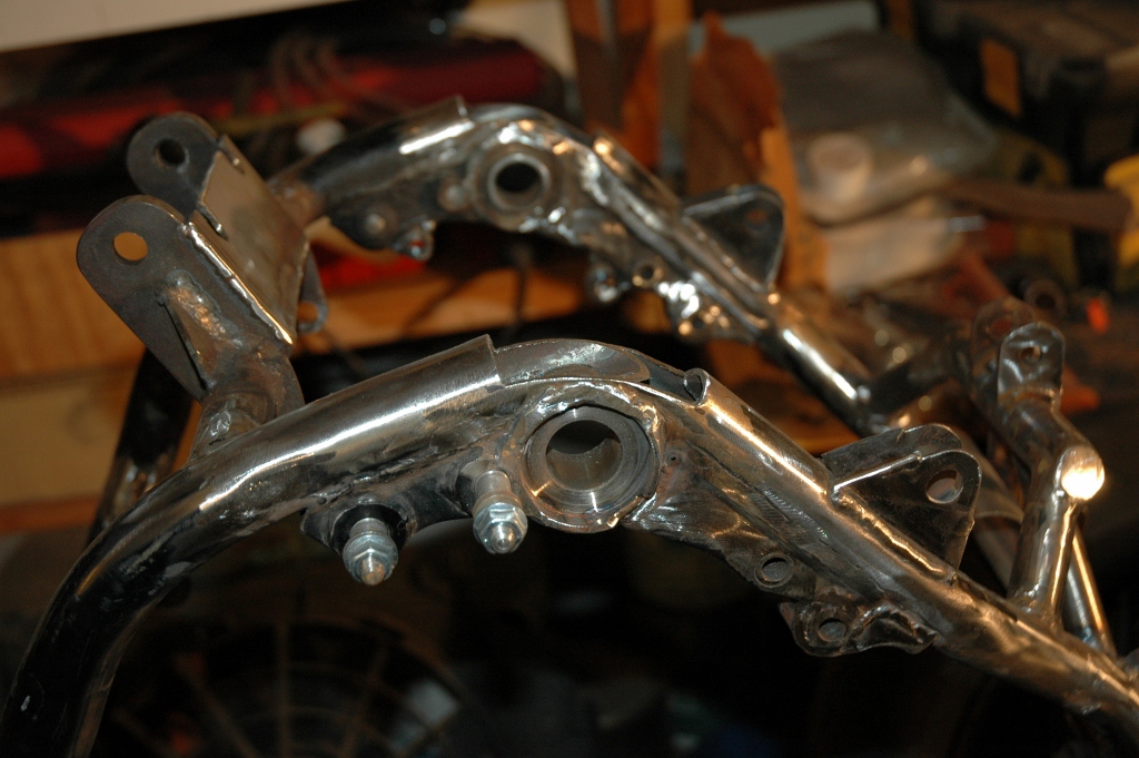

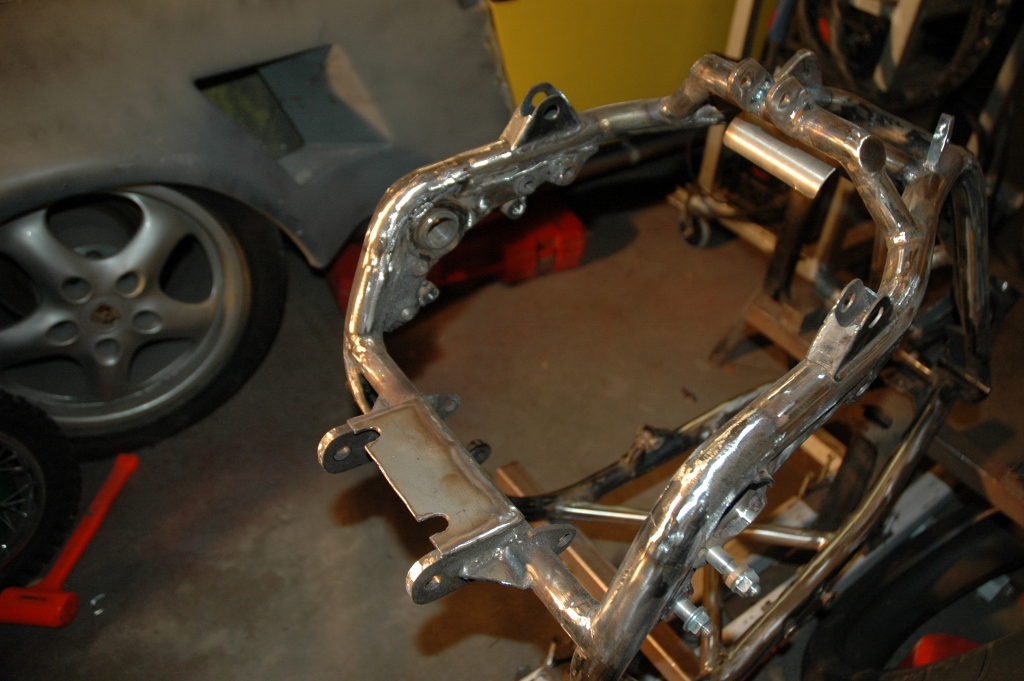

Then I cut out some new ones and welded them in place:
I wasn't happy about the outcome of these ones either, so I cut them off and made more room for a proper radius:

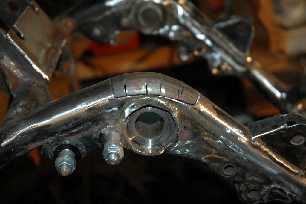

This allowed me to use some 1.5" tubing that I had run through a tubing roller, cut a piece out and then semi-sectioned it to give me a tighter radius.

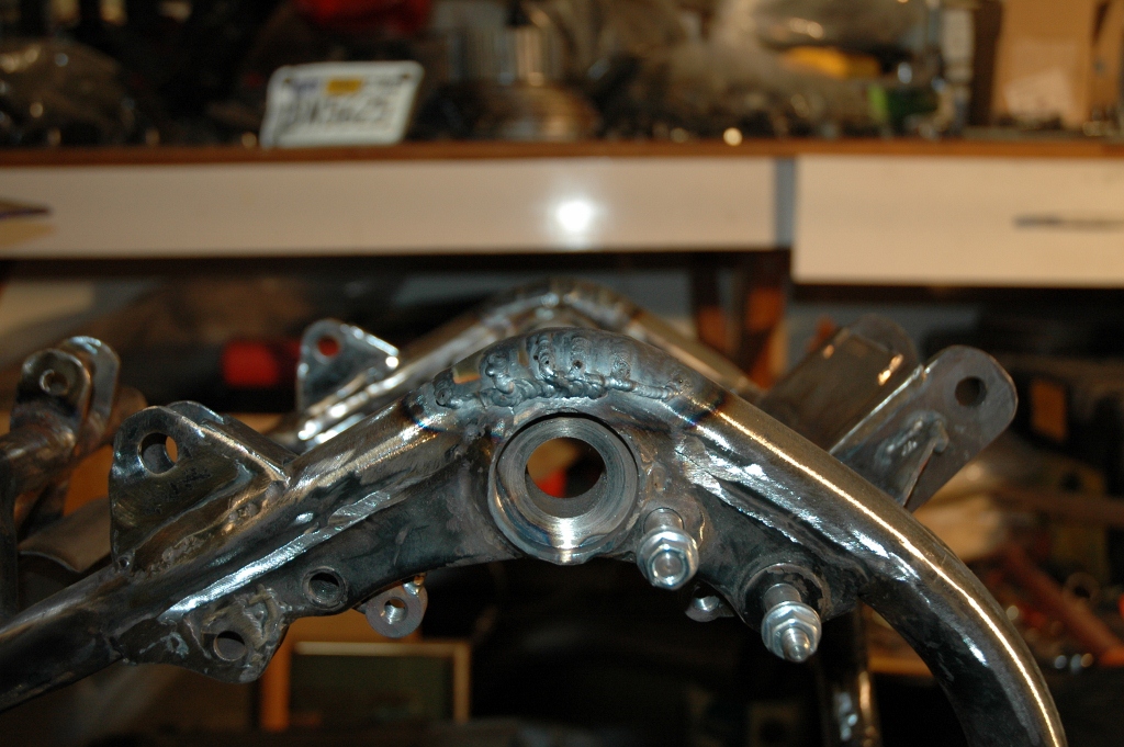

Much better! I welded them up:

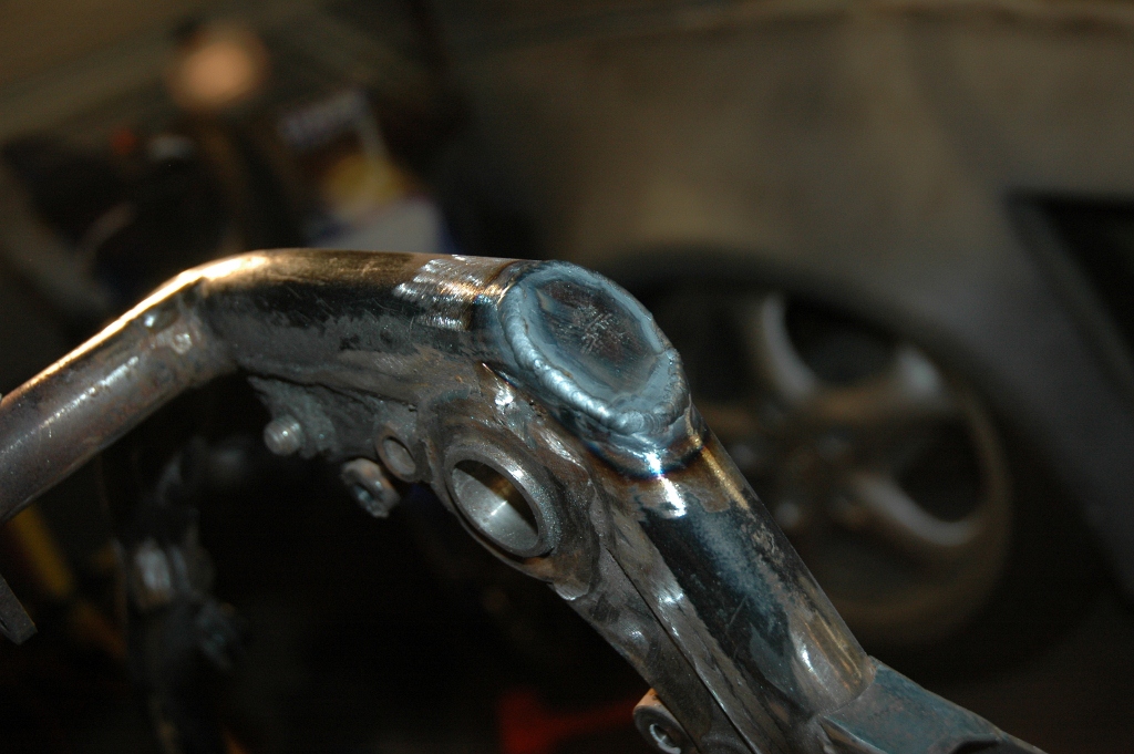

And then smoothed them out:
Now I can check that item off the list and move forward with stripping the frame for paint. About damn time too!
