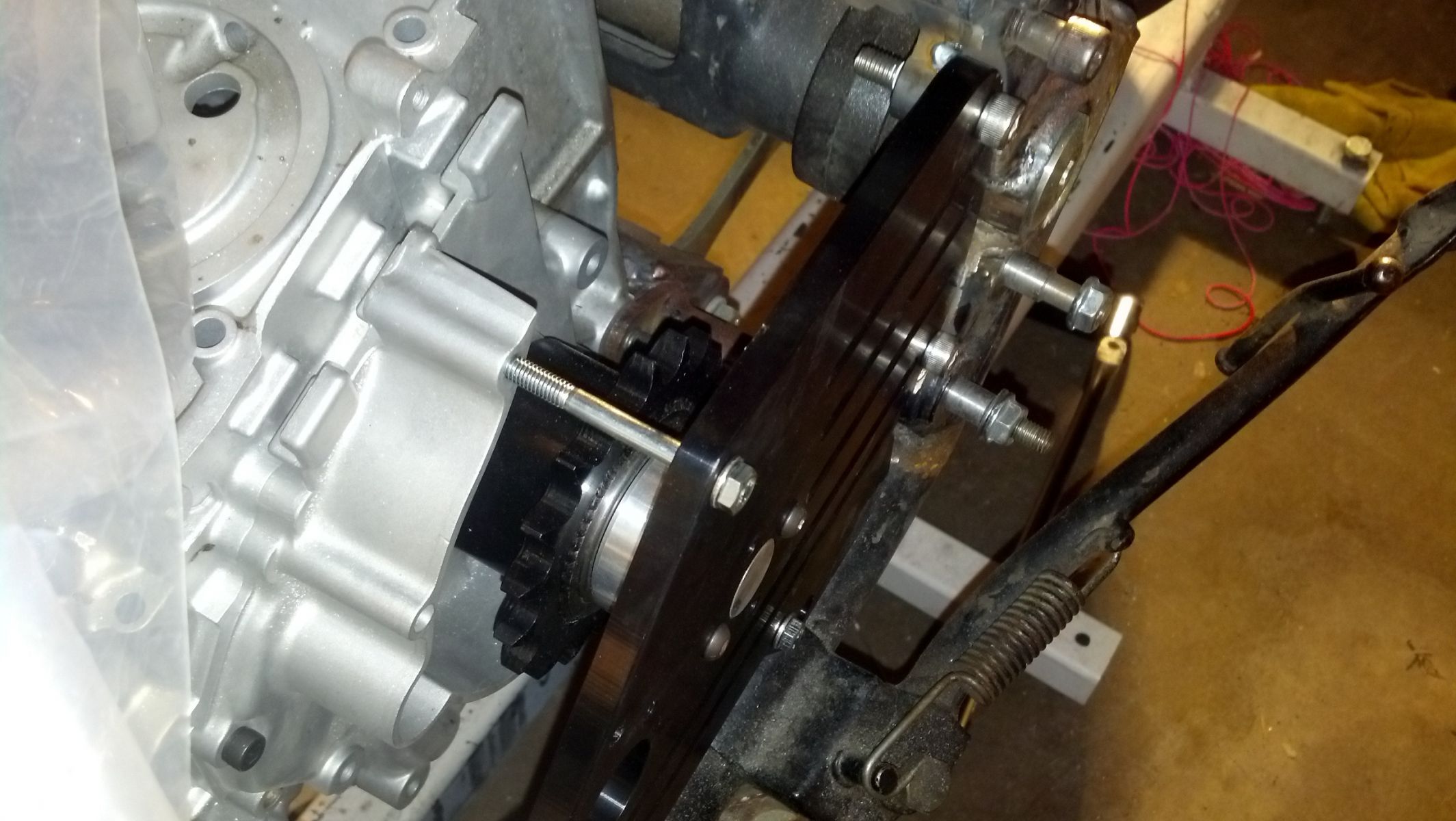

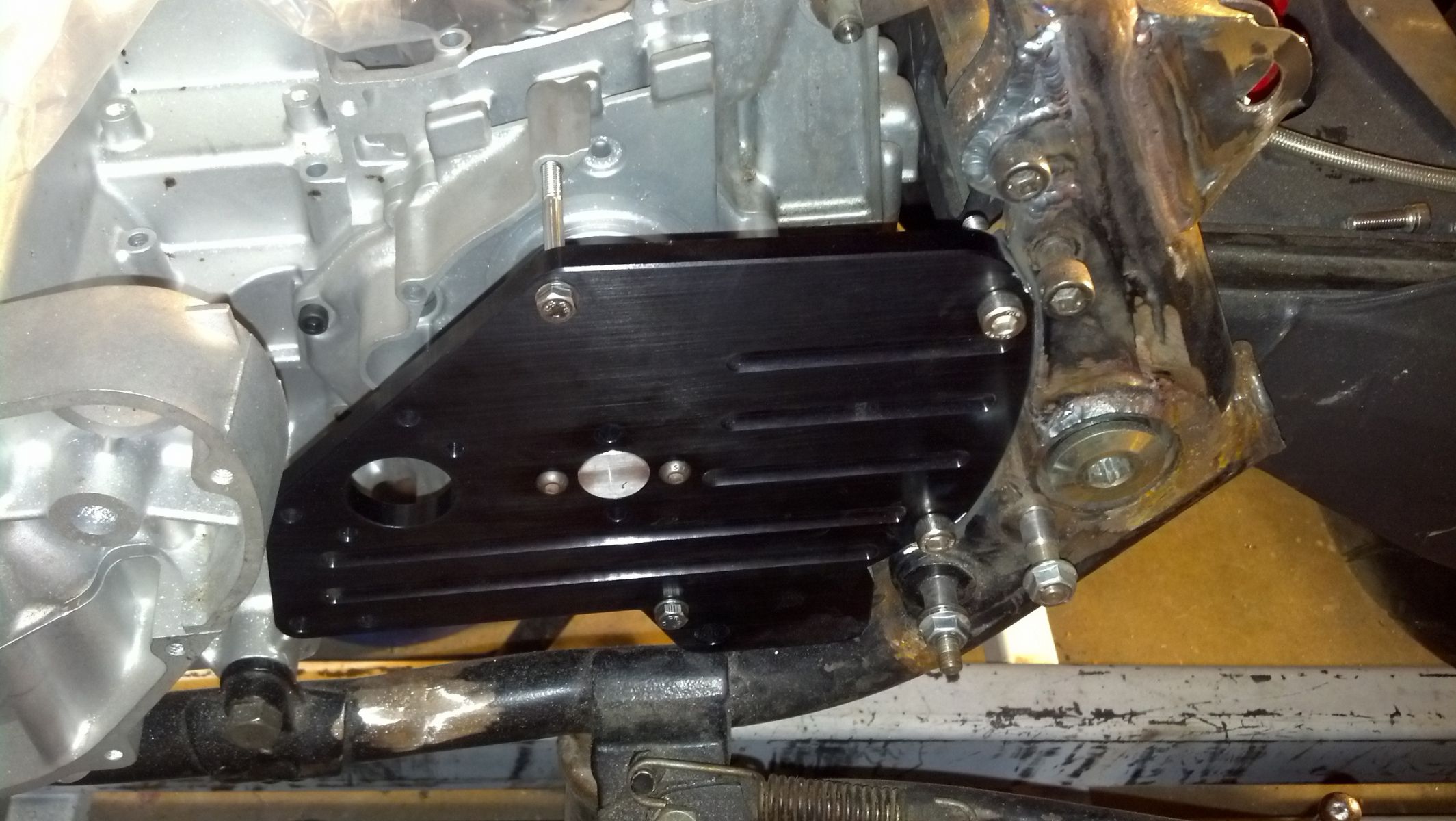

Holy crap it took waaaaaaaay too long to fit this damn support plate! :sick: I had to modify the plate to fit my frame, then I had to modify the lugs to match, blah blah blah. Finally, I got the plate fitted and the frame lugs welded :woohoo:
Now I can strip the bike back down to the frame, clean up the welds, strip the rest of the stock paint and repaint it. Now THAT will be a milestone
p.s. Sorry it took so long Leon

Must have missed it, but what is the purpose of the support plate? Is it basically another engine mount (located where all the torque is transferred from the engine to the chain)?

When running an offset sprocket, you are putting excessive leverage on the output shaft and the output shaft bearing. The outboard bearing support removes that leverage, or at the very least greatly reduces it. I needed it because my offset is so high. Now I get to start taking her back apart!

10 Jul 2012 15:34porchev914 wrote: When running an offset sprocket, you are putting excessive leverage on the output shaft and the output shaft bearing. The outboard bearing support removes that leverage, or at the very least greatly reduces it. I needed it because my offset is so high. Now I get to start taking her back apart!
Ahh ok. Didn't catch the large offset part. Back on track.

Yeah, that's the rub Mark. Most people running modern swingarms can use 1/2" or 5/8" offset sprockets. Those will still fit inside a stock cover with some tweaking. But 1.24" offset is considerably more than I want to subject my new output shaft bearing to, and i can't run the stock cover, so the decision was pretty much made for me

No worries! That seems like a very good idea for all bikes making 100+ horsepower. Along with the frame flexing, the tiny motor mounts in the Zs were a known weak area. The plate would eliminate the flex from the output shaft to the chain - so the horsepower would get right to the chain, right?

That's pretty much it Mark. You got it

its more a case of preventing damage to the shaft. nothing worse than a pain in the shaft.
