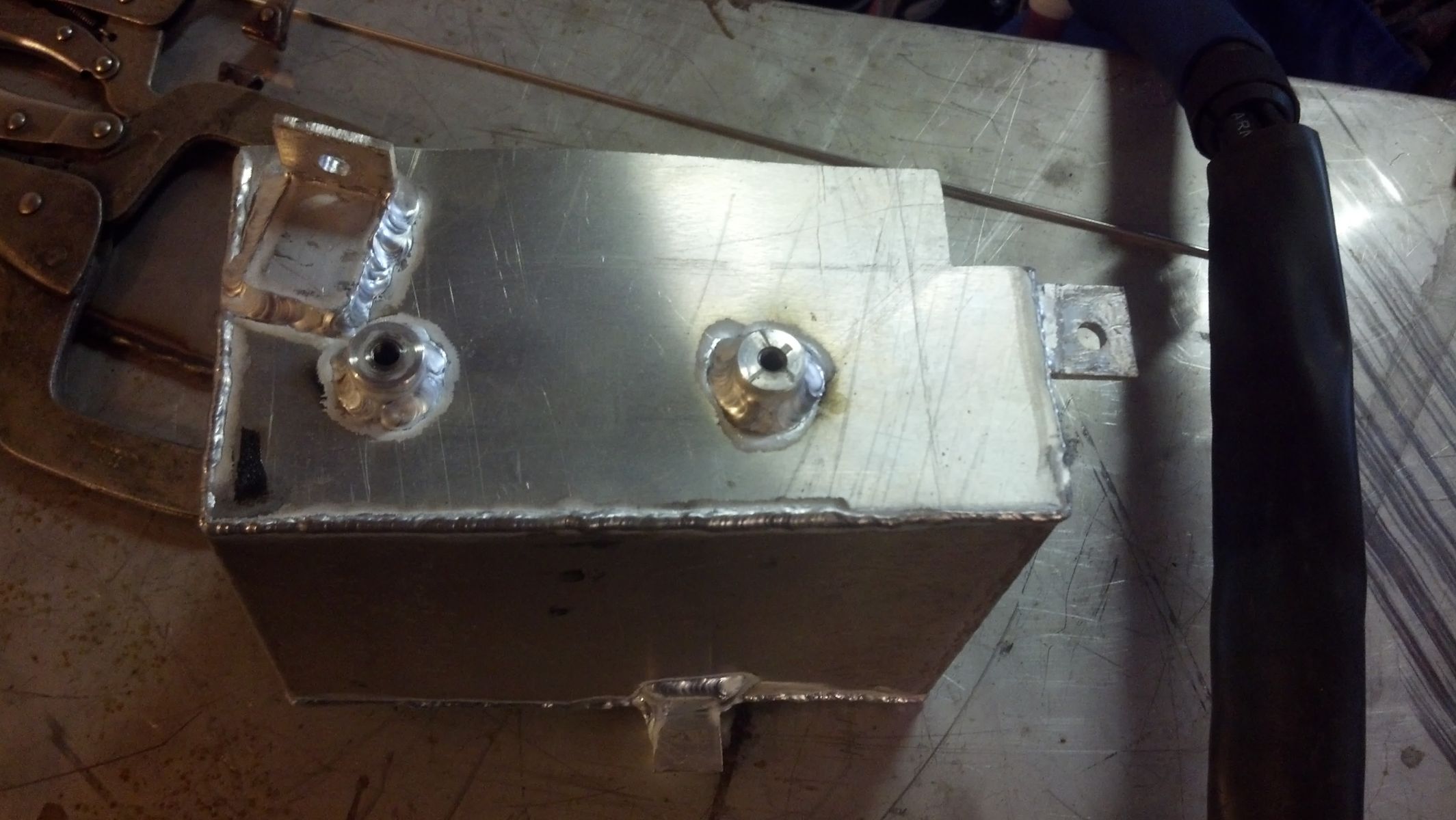

I finished machining some threaded bosses for the electrical panel and R/R unit, and welding them to the battery box. It was an exercise in heat control and torch angle due to the thin sheet and the thicker solid round.

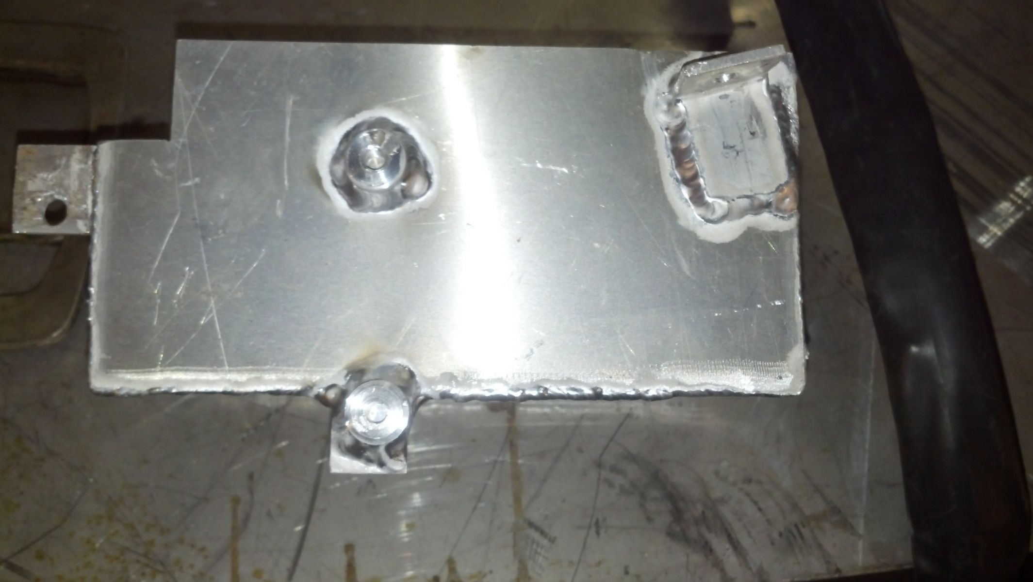

Above is the right side R/R mount. Below is the left side electrical panel mount. It needs a little more finishing.
