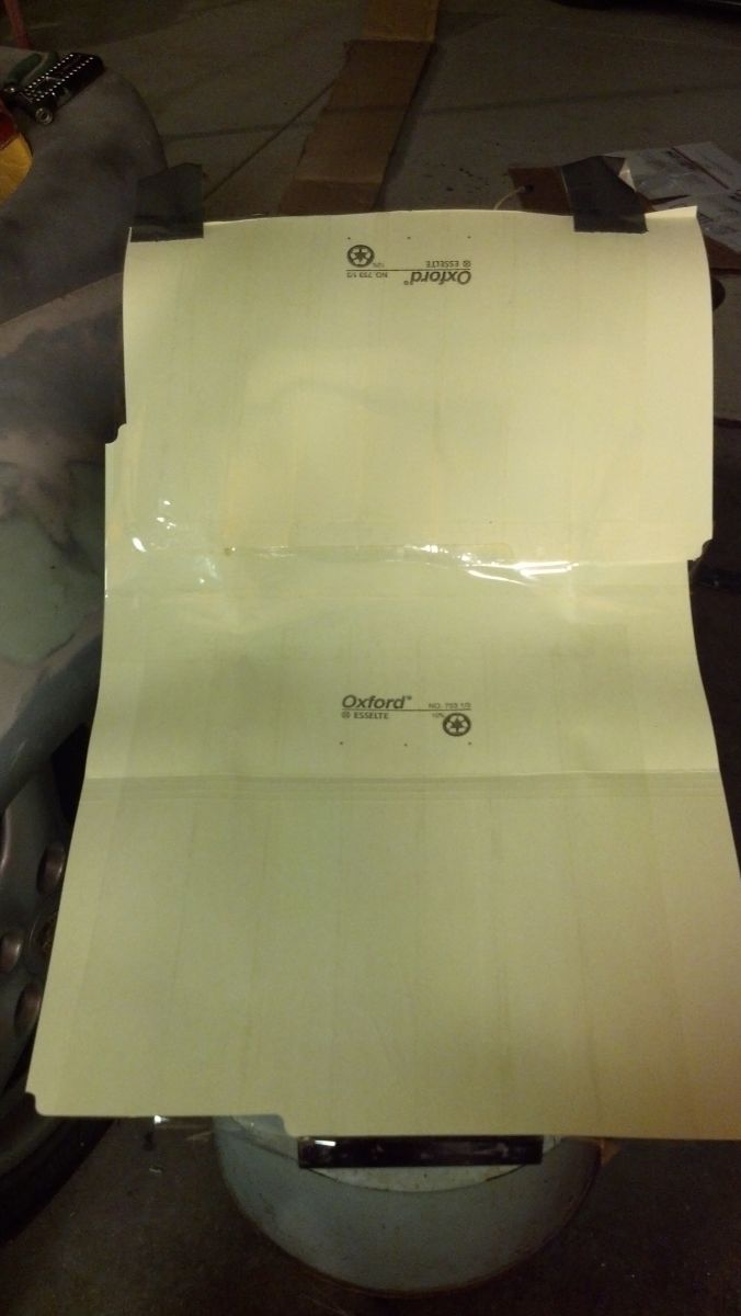

I started by using spray adhesive to glue card stock (file folders work awesome, are cheap and plentiful) to the bottom of the subframe, so that I have something flat that follows the contour of the tubes. Then I covered the folders with packaging tape.

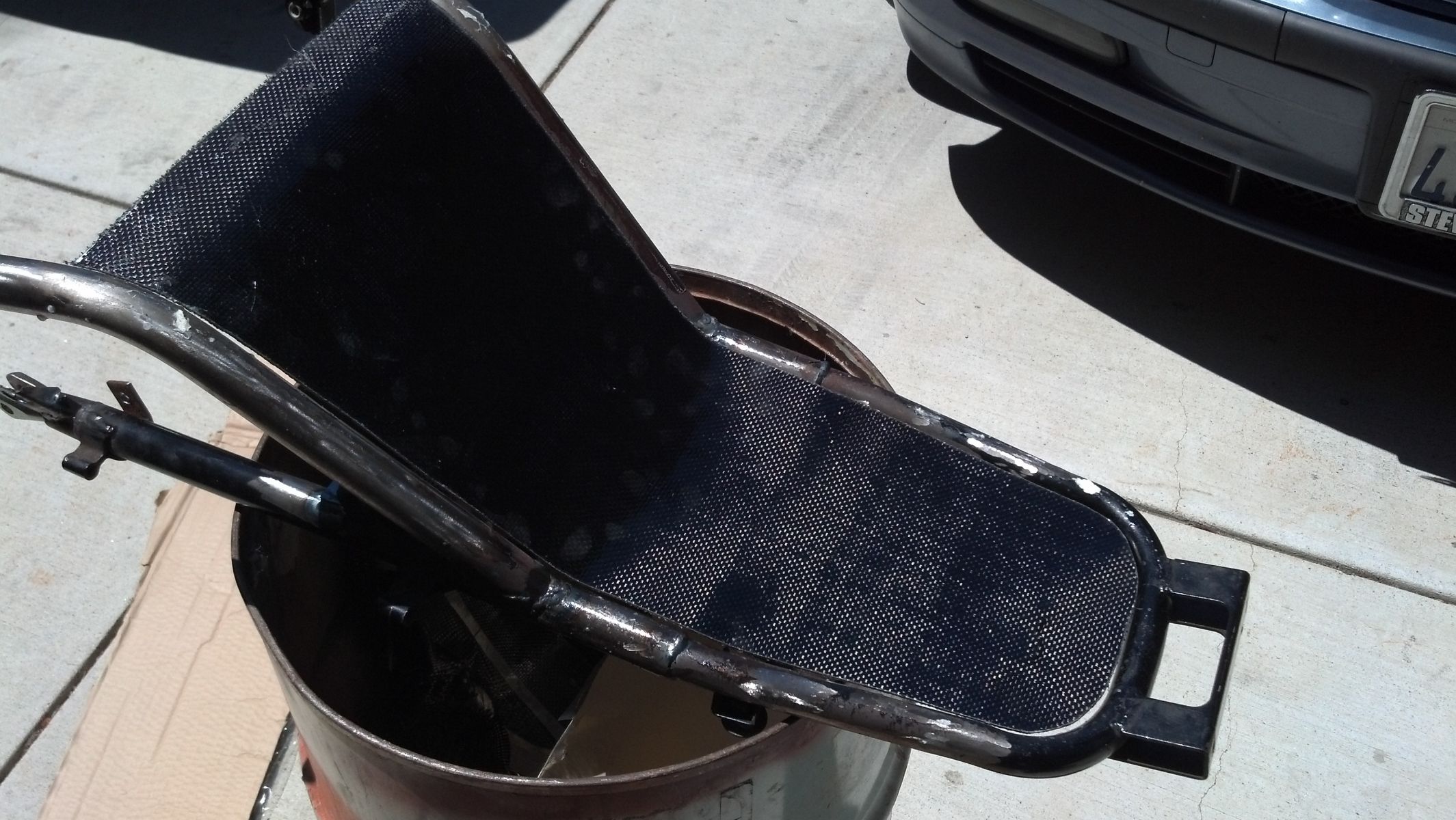

Then I laid the the first layer of carbon cloth over the "mould"

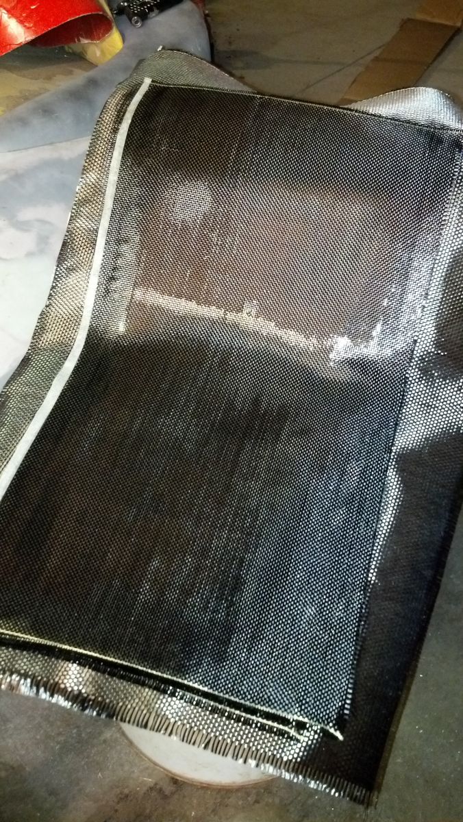

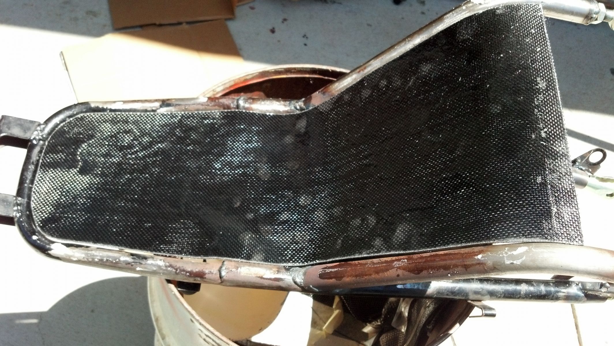

I mixed up some resin, coated the first layer of cloth,, then added 3 more layers for a total of 4. It doesn't need to be super strong, just keep the crud out from under the seat and tail. After the last layer it looked like this:
And there you have it, thats how you make a quick and dirty carbon fiber subframe panel.

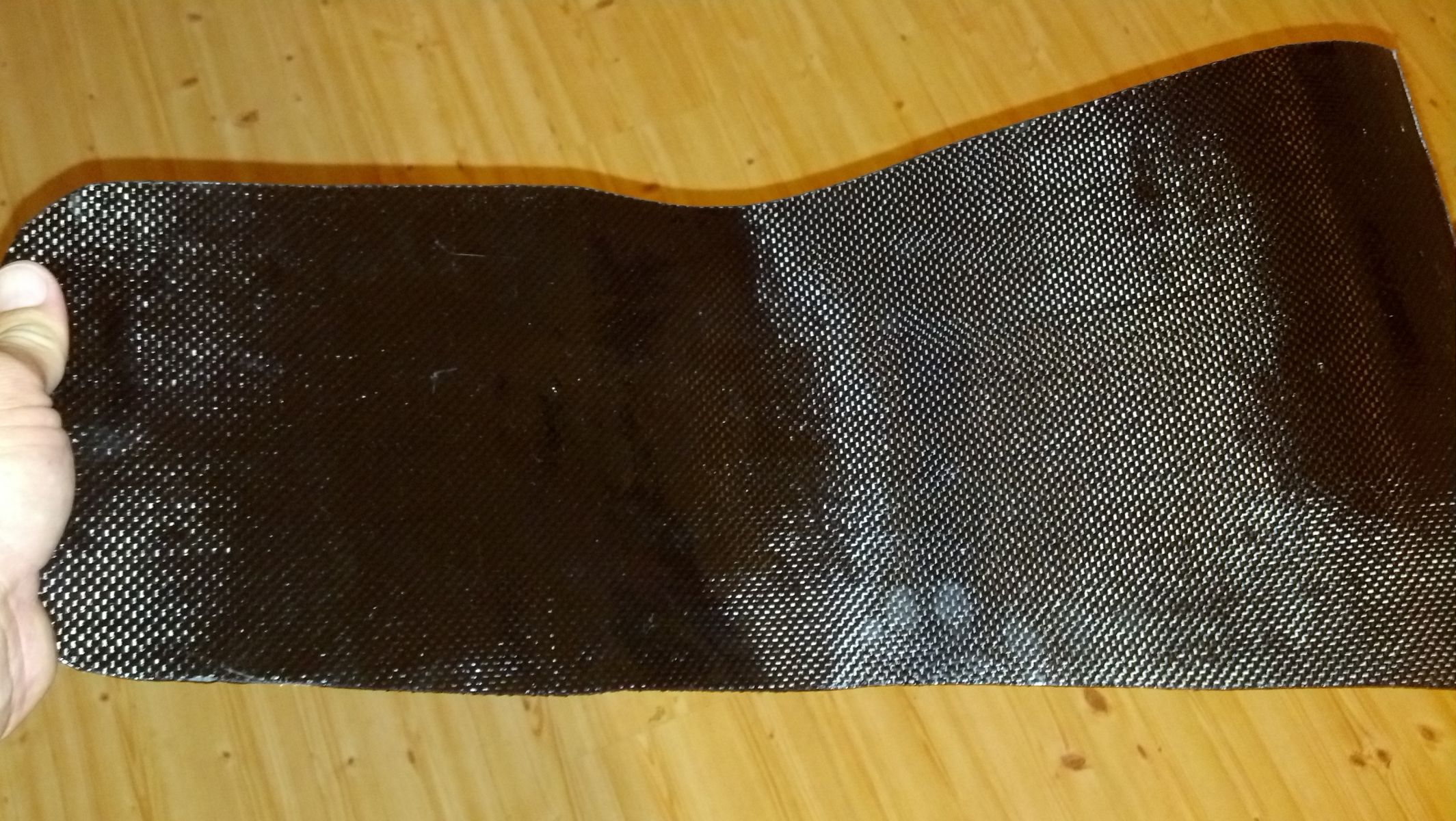

And viola! We have a rough cut carbon fiber undertail panel :evil:
forgive the fingerprints, the panel isn't complete yet. I have one more coat of resin to apply
