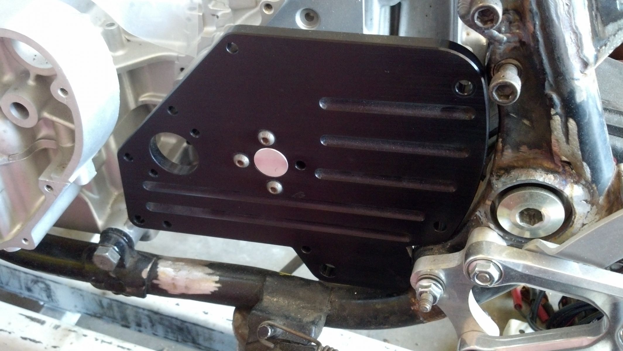

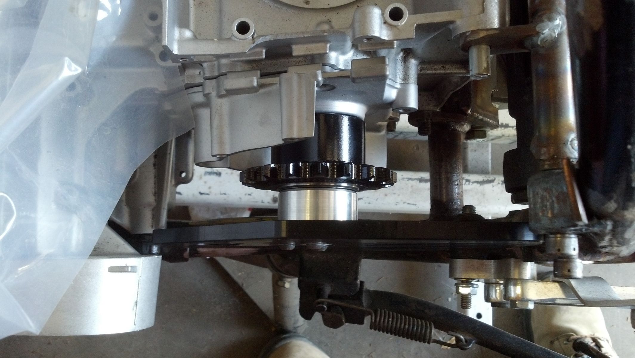

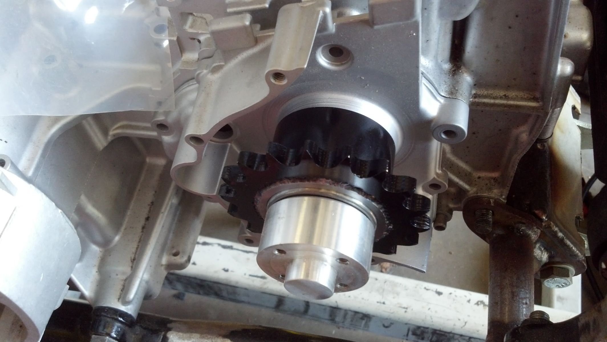

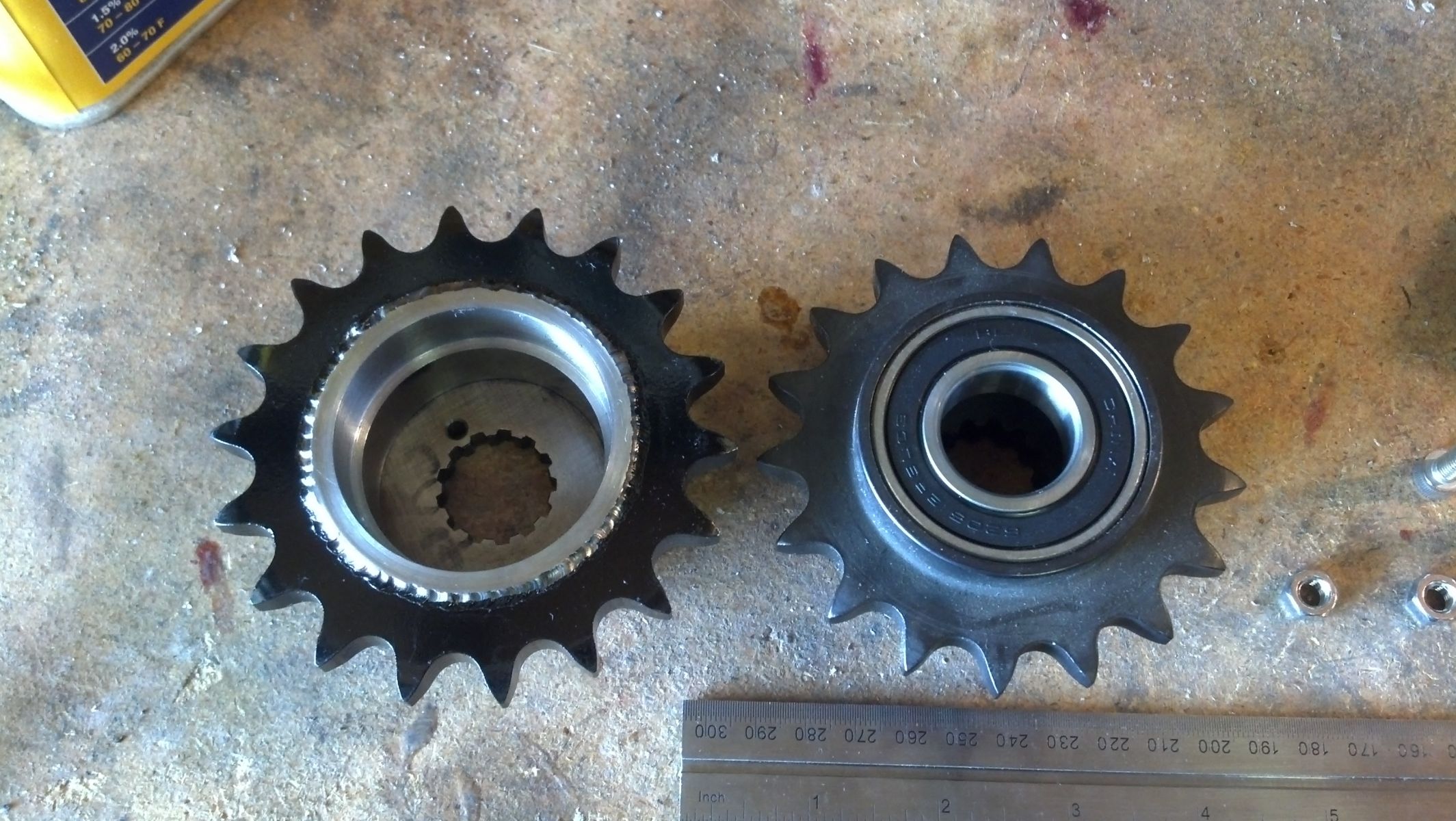

:woohoo: :woohoo: :woohoo: My D&G sprocket showed up today! It looks so big compared to the PMFR sprocket, but its an 18 tooth vs the PMFR 17 tooth.
Interestingly enough, the new D&G sprocket mounts the bearing support plate a tiny bit closer to the engine than the PMFR part. I know Doug was trying to keep it close to aid in making the clutch parts work, and keep it close he did. Sitting on the output shaft with the bearing support spud in:
The bearing support plate in place profile:
With the bearing support plate plan view:
Now, I have to massage the bearing support plate, to be able to rotate it clockwise ever so slightly. My frame mods have taken their toll on how things fit up :whistle:
