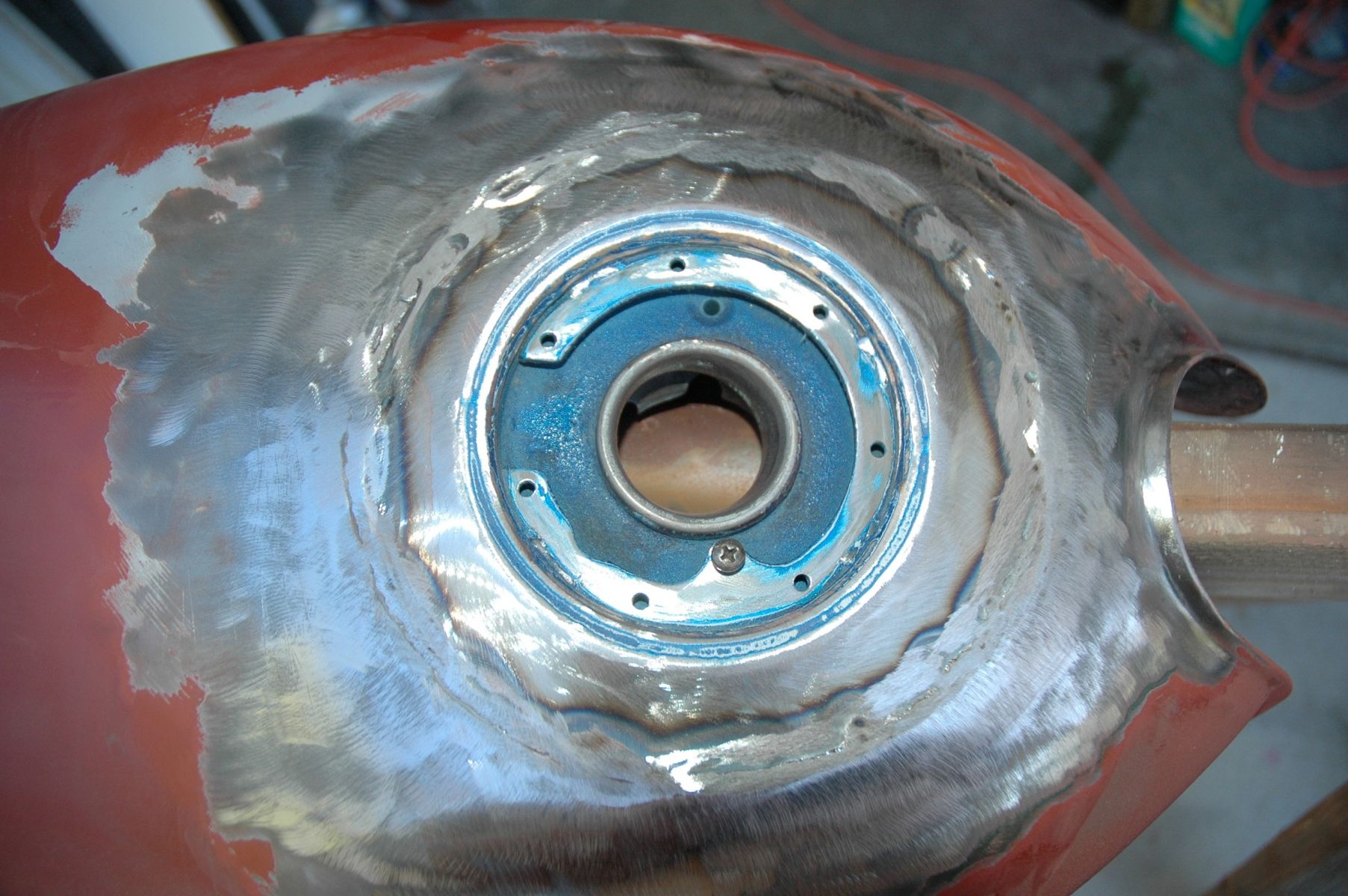

My circles never come out that good with a jigsaw. Need more practice I guess. :blush:
Wow that came out good!

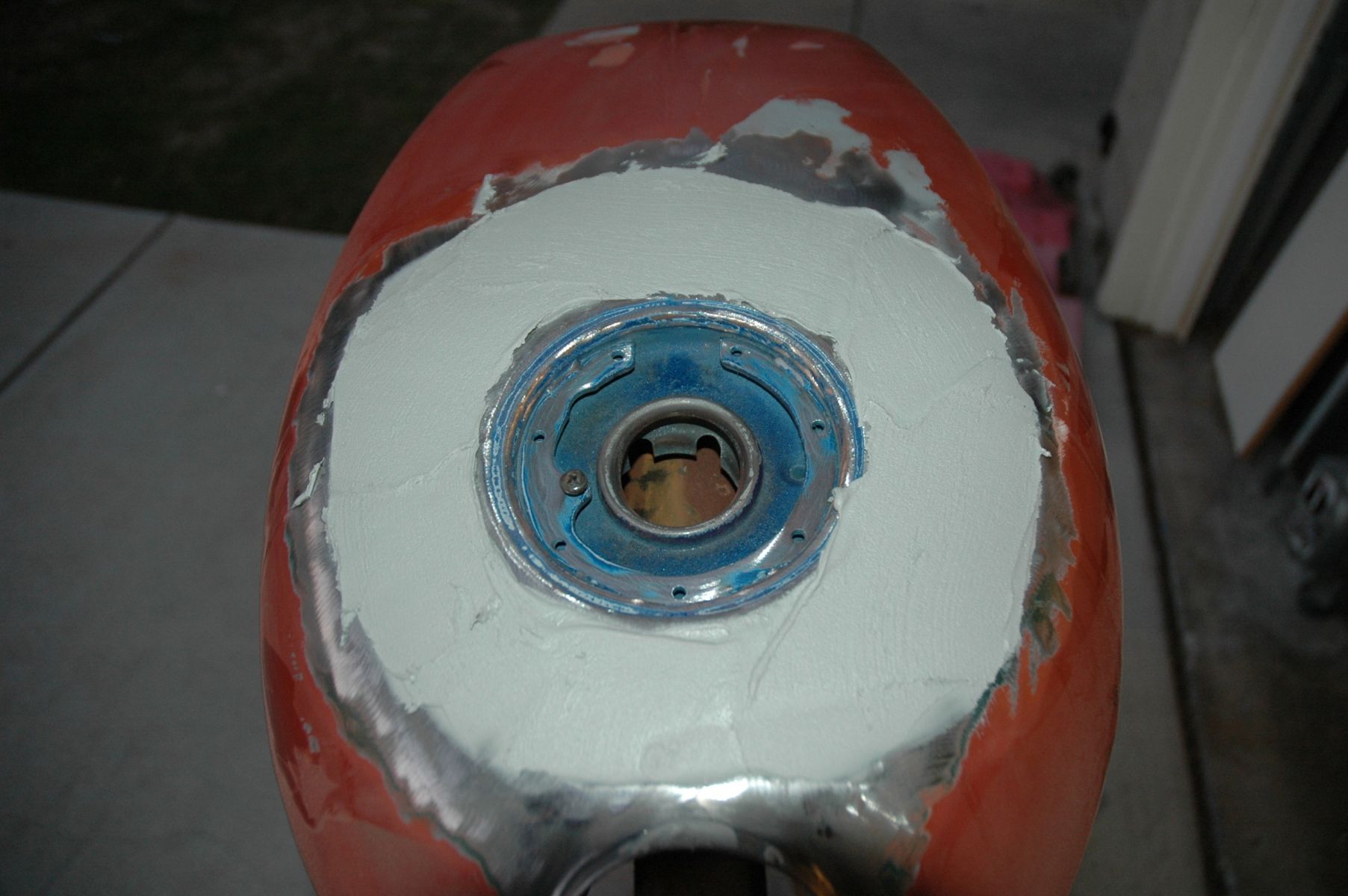

Thanks! Here is the tank with the weld ground flush, and a bit more of the older prep work removed for a wider band of body filler. Probably not necessary, but a precaution I took anyway.

Josh is right, I need to focus on the project(s) I have in front of me first :whistle: To be honest, it was easier and took less time than I thought!
Josh, I have a nibbler, and it makes more of a mess than anything....every punch makes a tiny 1/16" metal crescent, and they go flying EVERYWHERE. That, and its difficult to get a clean, straight line. To make a perfect sheetmetal butt joint I needed precision, hence the jig saw cut. I suppose I could have used the plasma cutter, but thats like bringing a bazooka to a knife fight, and I still wouldn't have gotten the accuracy freehand with the torch I get with the saw. Having a small lathe, a plasma and a tig welder is definitely sweet, but I still do alot of my fab work with a hammer, bench vise, bench grider, files and jig/hacksaws.

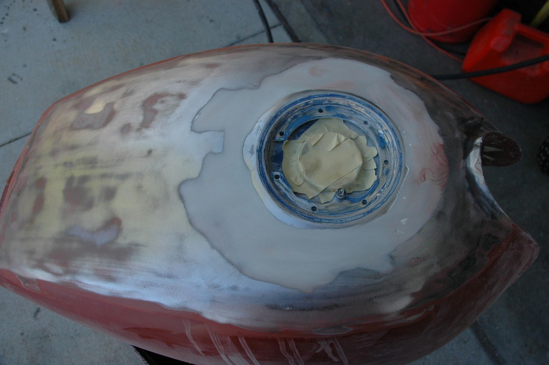

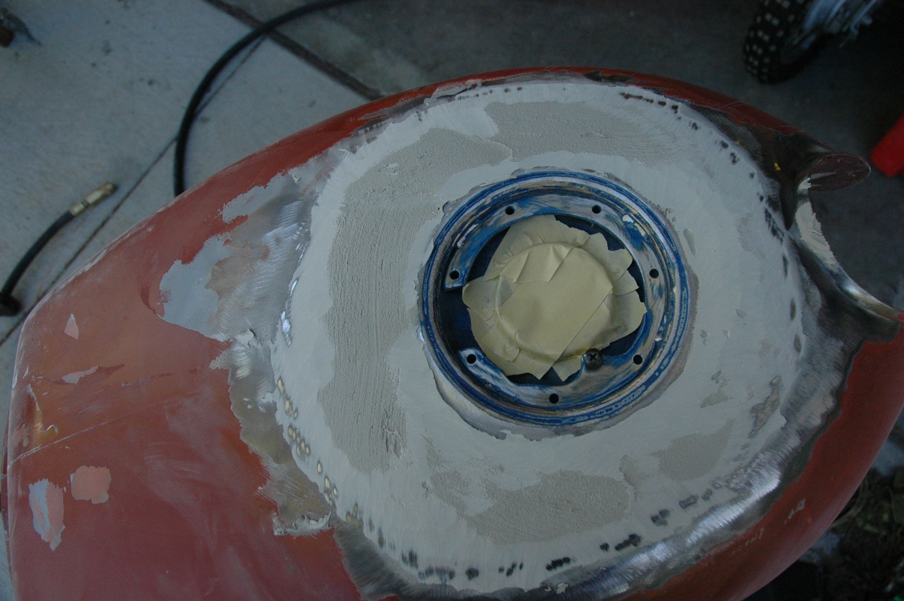

Little bodywork tip: after applying a coat of body filler, when you go back to sand it you always start by sanding down the edges back to the underlying panel. Like so:
I didn't have 36 grit on a 6" disk, and I damn sure didn't feel like doing it by hand (it was a late night with a fair amount of tequila....) so I used a 4" grinder. Not pretty, but it got the job done. Then I moved to 180 grit on a DA. Normaly I would have used 36 grit to rough it down, then applied a thinned out skim coat and switched to 80 grit then 180, but again, I didn't have any 80 grit 6" disks either. Its slower, but it sands the same. I still need to bring it down a little more, but this is where I left it before I left for a SB party.
Enjoy!
