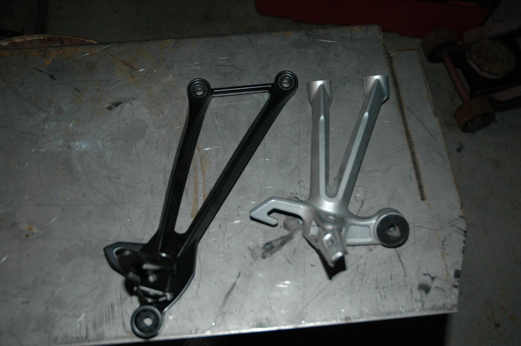

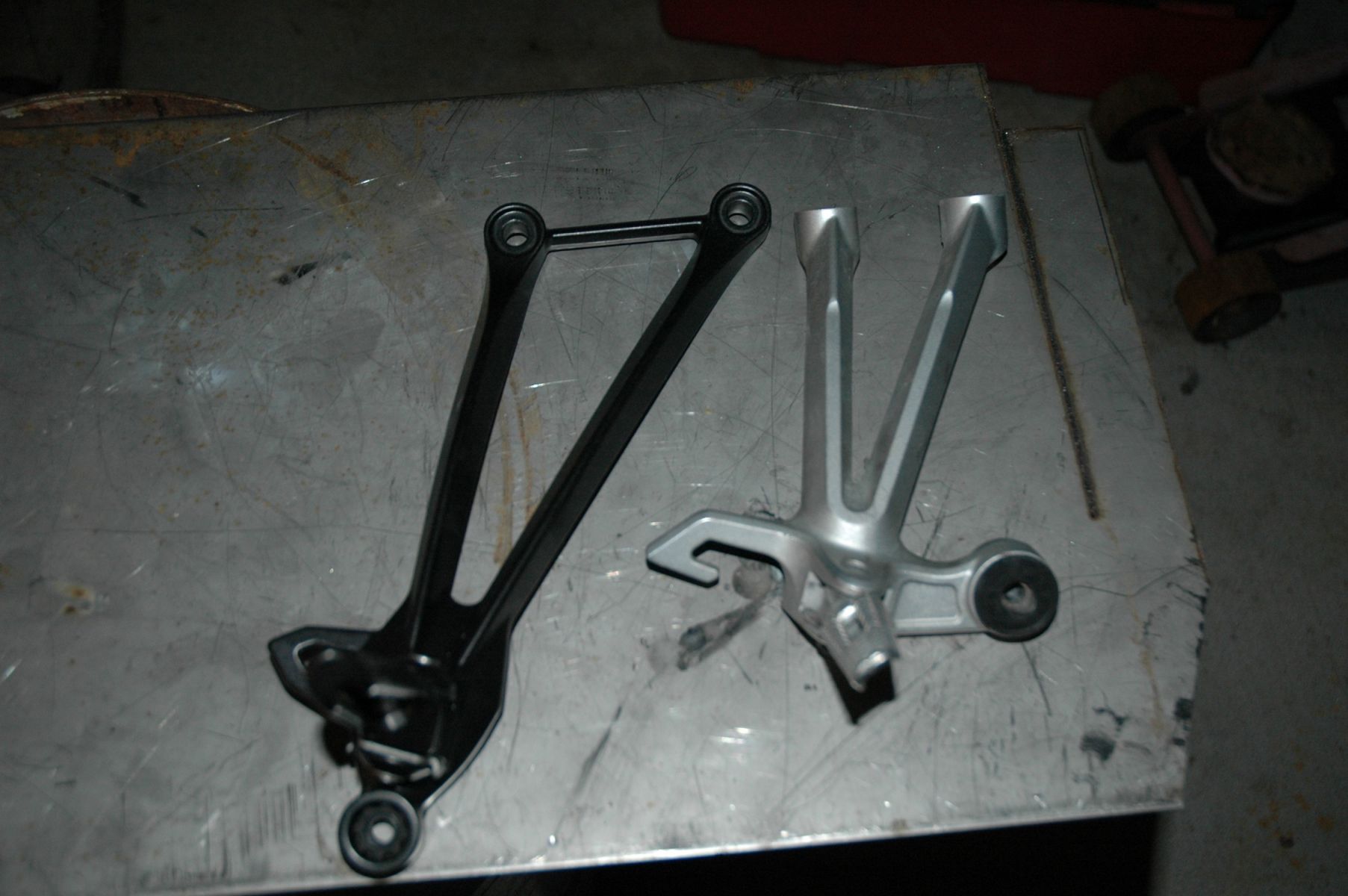

OK, The mail man brought the new passenger pegs, from an 08 GSXR 1K. They are shorter than the ZX10 passenger pegs regrettably, but the GSXR's under mount will serve the project better than the side mount style of the ZX parts. I'm sorry dear wife, your beautiful long legs will be a little more cramped, but its for the good of the project!

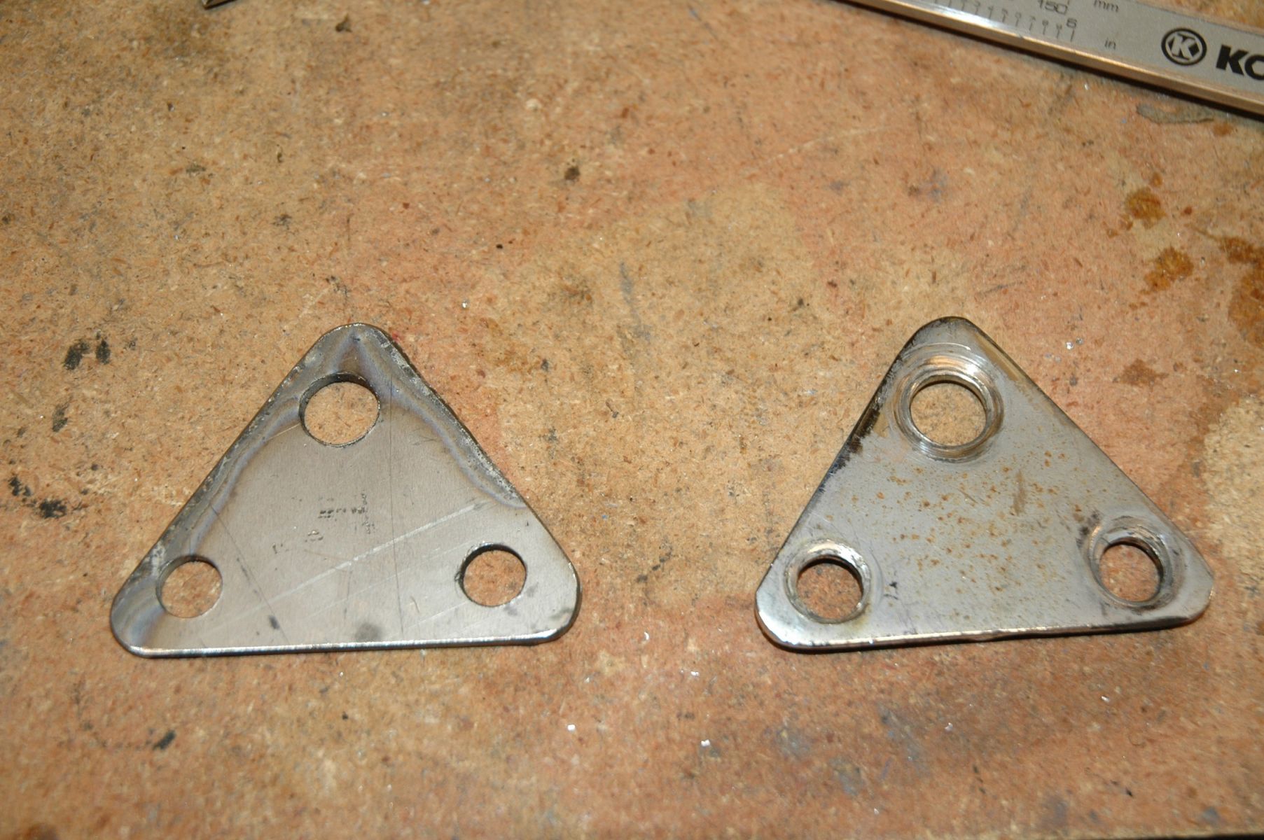

I also need to put the cases back into the frame to properly locate the outboard bearing support. One item I have been missing since I disassembled the bike is the lower right engine mount. I did not see the need to buy an entire motor mount kit for the one part, so like almost everything else, I elected to make one. I borrowed one from Supercharged (thanks Mike) as a template and marked one out on 1/8" CP2 titanium. CP2 is a commercially pure titanium that is easier to work with/machine versus a titanium alloy like 6AL4V. Even still, it certainly drilled a little harder than carbon steel, similar to stainless.
After I cut it out, I'll take the tig torch to a corner of the plate and see what it takes to bring a little of the oxidization color out of the material.

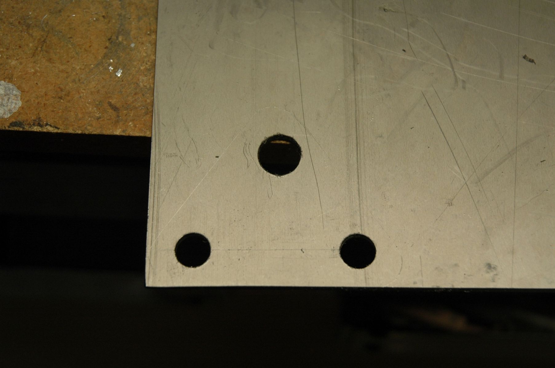

Incidentally, cutting the titanium was SIGNIFIGANTLY more difficult than drilling it! I started with a jig saw, and that didn't do much. Then I tried a fresh hacksaw blade, and that was even less effective. I think I spent 5 minutes and made a 1/4" notch in the Ti plate
OK, time to pull out the big guns! The plasma cutter made short work of cutting out the bracket, but it left a discoloration along the two edges I cut. Here is the rough bracket next to the template bracket I used. Ti on the left:
I will likely drill a .75" hole in the middle and scallop the edges in a bit between the perimeter mounting holes. We'll see.....

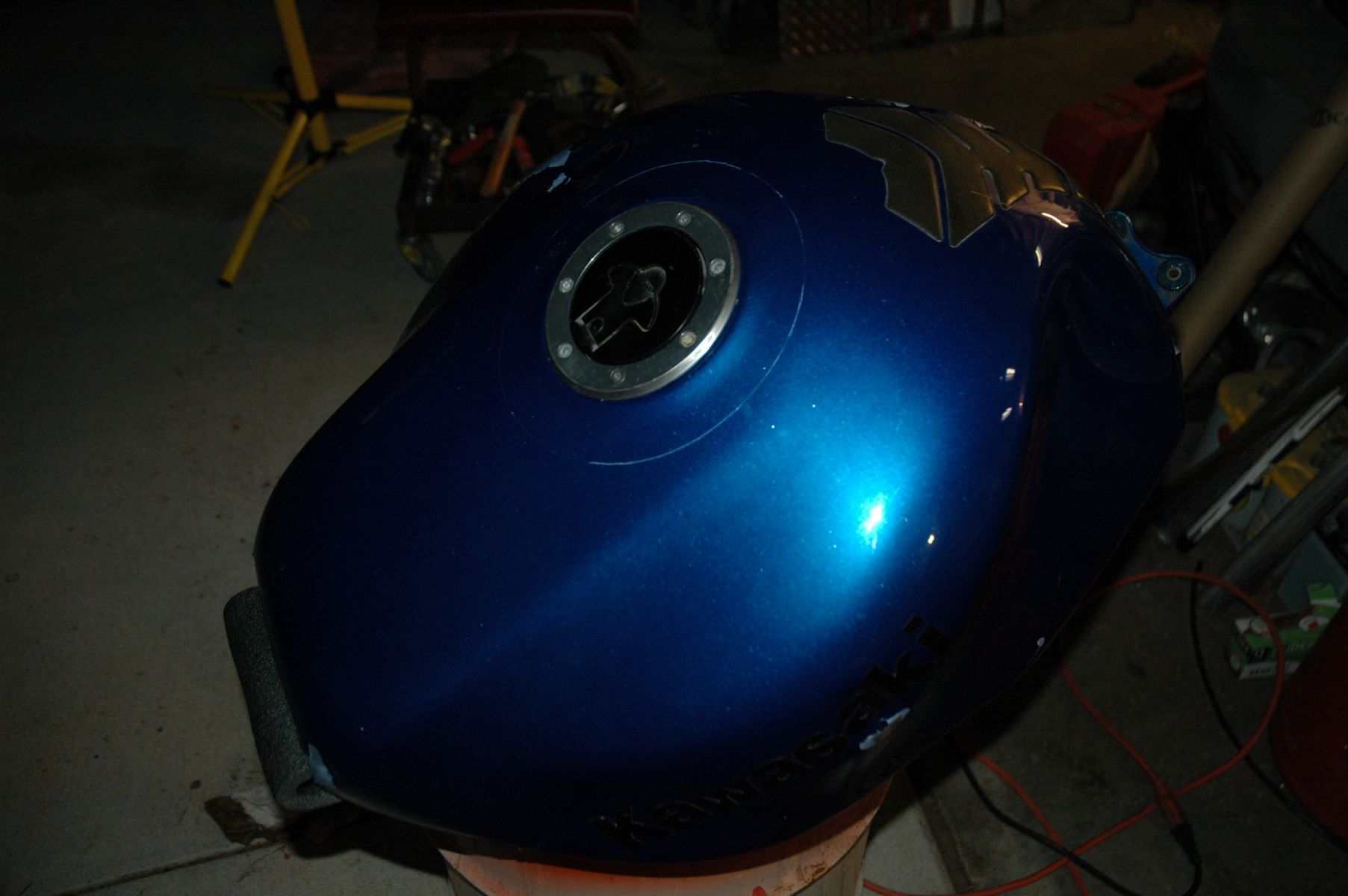

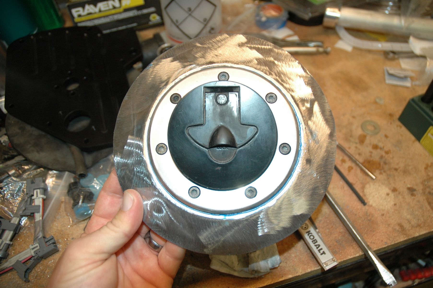

The UPS man brought another piece to the puzzel today. Many of you know I sacrificed a portion of my stock fuel tank to make the mold for the composite replica. I never planned to abandon my stock tank, and in fact I figured I would need to use it in the interum as I figured out how to make the composite version properly. So here and there I kept my eyes out for a decent modern donor tank for the fuel filler. Today, a '99 ZX9 fuel tank showed up
I had already made a card stock template to trace a circular line around the fuel filler with a 1.25" flange. I figured that should be plenty of room to graft onto the stock KZ tank. After a few minutes with a jigsaw, and a few more with a sanding disk I was left with this:
Now, we'll stick that with the stock tank for now, and move on to more important things

02 Feb 2012 00:36ramtough_63 wrote: Too cool i want that to be my next project bought a kz tank just haven't squeezed the funds for a donor tank yet
I have been looking for a mid to late 90's Kawasaki tank because I prefer the 7 bolt pattern (no fake bolts), the "tee" lock cover and the flatter area all around the neck. This particular tank was listed for $110 shipped OBO on ebay. I offered $50, he countered $75, I countered $60, he declined it, then 30 minutes later he took it. I didn't get a key with mine, but a new OEM lockset with keys for the tank is $34 from Kawasakiparts.net. When I took the filler apart to remove the original lock, it definitely needed to be greased on the inside after 13 years :laugh:
