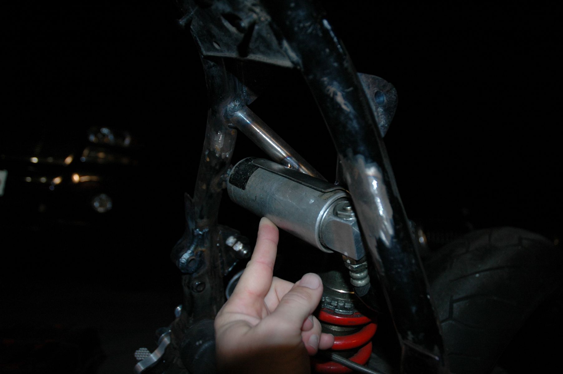

Thanks to Blackbanshee, I remembered I still needed to work out the rear shock nitrogen reservior mount. I contemplated doing the same thing Testerossa did, and mount it to the subframe, but my hose is shorter and it wasn't really working out like I wanted. I figured I'd measure the reserviours diameter (1.806") and get a piece of tubing that I could cut in half to serve as a mount. I scrounged up some 2" .60" wall stainless tubing, cut a 3.5" piece and then cut it in half lengthwise. It fit almost perfectly around the reservior.... but with a little bit of play. Then I wondered if I should have some isolater or dampner so the reserviour isn't rubbing/vibrating against the stainless tubing. I grabbed a chunk of 1/16" EPDM rubber mat I had laying there and presto! It was a perfect interference fit. I don't get lucky like that very often, but I'll take it.
So now, where to mount it? Well, how about the hollow area under the upper shock mount bracing? Its close enough, the hose isn't kinked in some weird way, it looks clean, and it sits back behind the main frame down tubes so i shoudn't have any air filter clearance issues. Whadya think, weld it up?

I really don't see what your hose length has to do with where you mount your reservoir? LOL :silly:
:laugh: :woohoo: I say Tack it for now and see where the rest of the build takes you. It looks good so far.

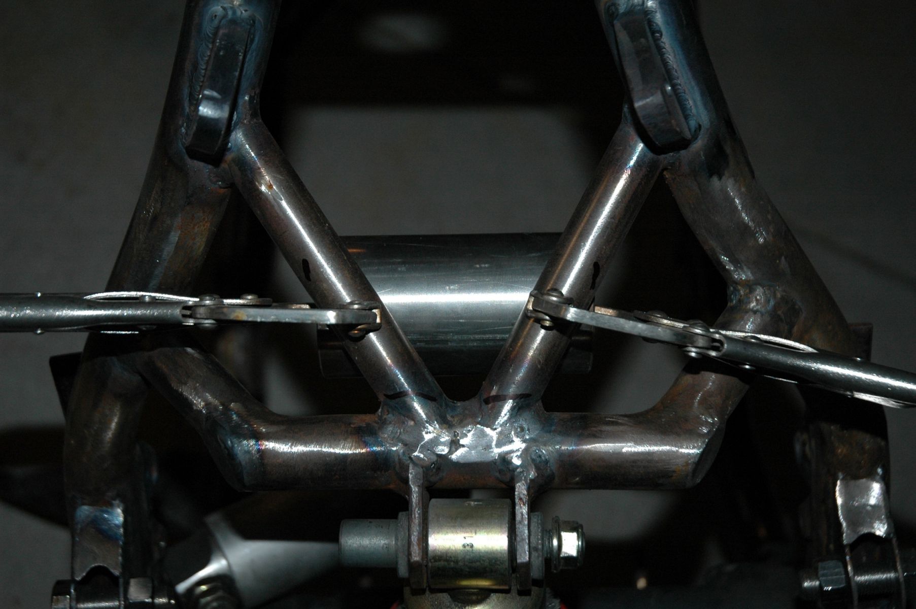

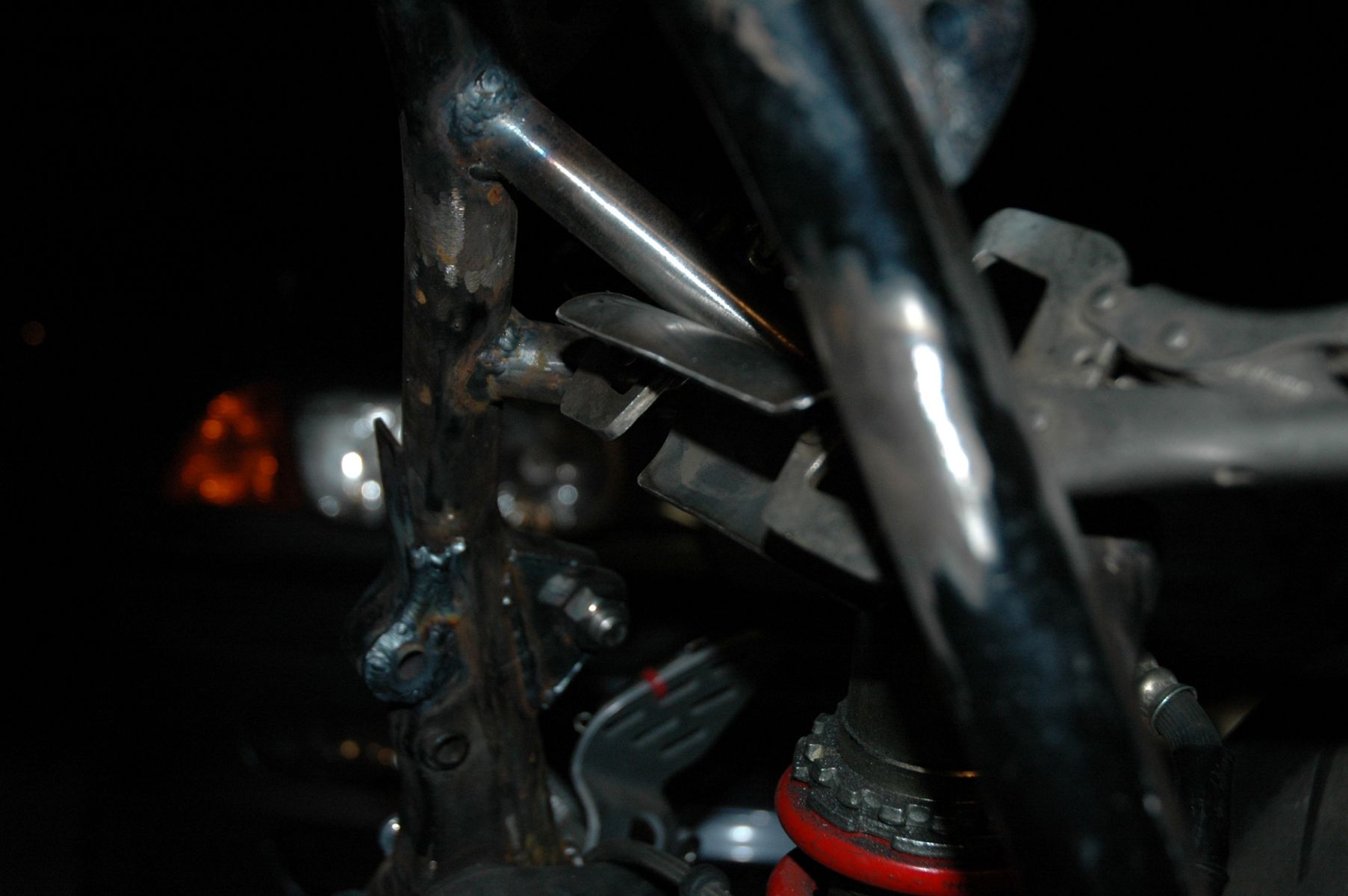

While elfmagic was busy coming up with a wity comment about my hose :ohmy: :laugh: , I was outside tacking the tube section to the frame:

Nice work on the jigsaw puzzle pieces on the side of frame. I'm impressed with your patience. I woulda done the easy thing and gooped it up with body filler. But maybe you plan on powder coating, dunno.
Perhaps the reservoir should be as low and forward as possible for weight reasons. Of course you won't feel the diff, but what the heck, every little bit helps. Or if the reservoir looks cool, hang it on the side of frame somewhere and bling it out!

No Nelson, I'm not powdercoating (they couldn't do the color I wanted), I wanted to afford the frame as much strength as I could. Those being the rear motor mount points, the least I could do was replace what was originally there.
