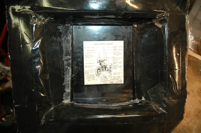

05 Oct 2011 02:30trianglelaguna wrote: a carbon fiber tail tray would make a nice stocking stuffer....sell em like hot cakes
Gotcha covered bro
FRANKEN Z!
1978 KZ1000 A2A with 08'Speed Triple SSSA and '06 GSXR1000 front end
- trianglelaguna
- Posts: 8019
- Thanks: 236
Re: '78 KZ1000 makeover
05 Oct 2011 09:04
no no i mean to sell em...folks are cheap but if the part is sweet it sells ...moriwaki points covers...ect...i was thinking of all the folks around the world with that nice stock outside colors and trick, or trick one offs that retain that cavity still...you tell the guy looking at the bike ...hey wanna see the original tool kit...dont mention the tray...then pull out the owners manual to show him and the carbon fiber shows...sell em like hot cakes...little finish to all those bikes done already....

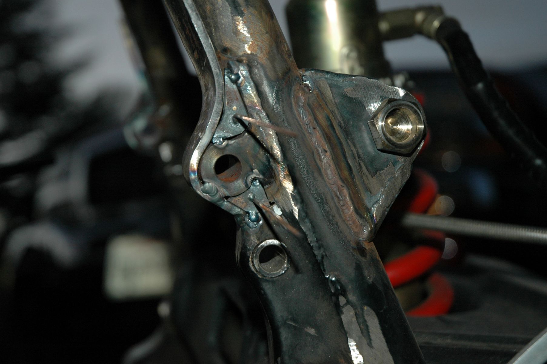

Ugh, has it been 3 months since my last post??? :blush: I squeeked out a bit of progress this weekend. Detail work really, but time consuming and a little tedious which is why I think I was procrastinating :pinch:

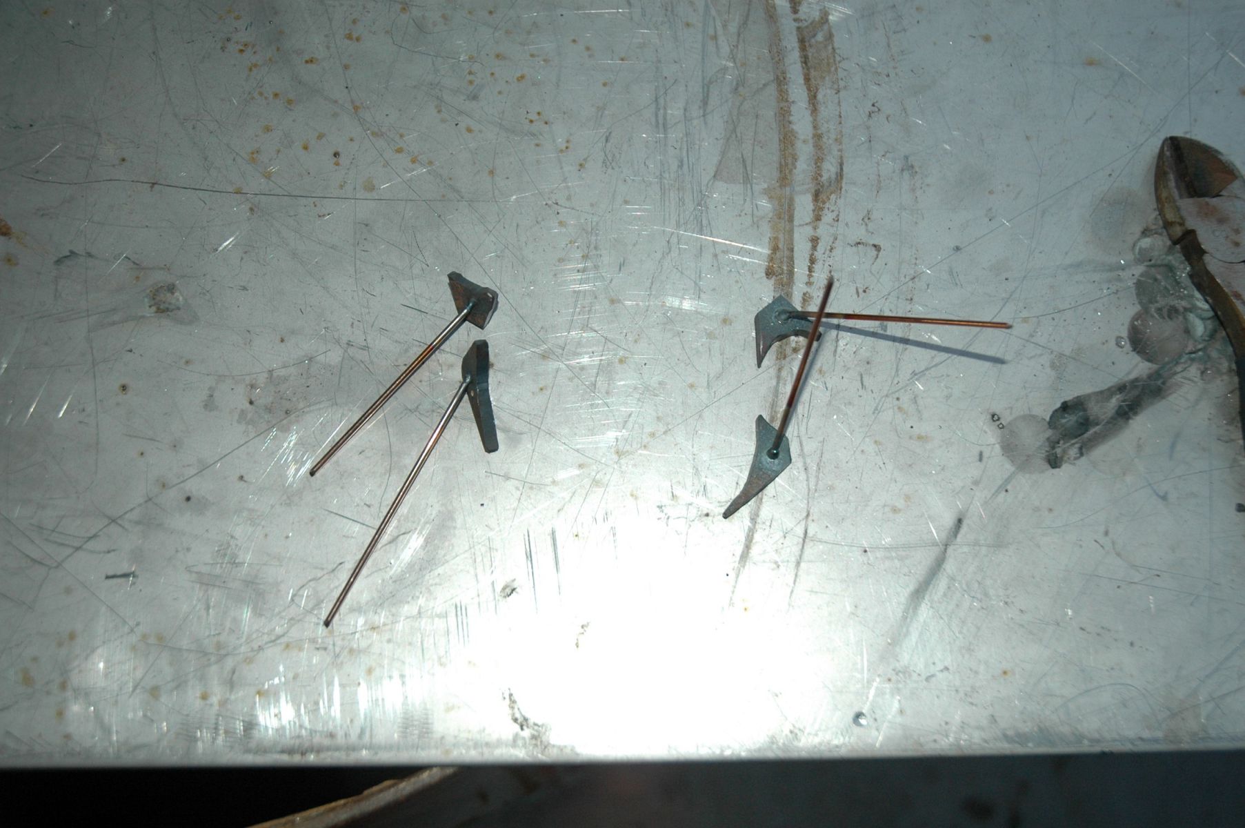

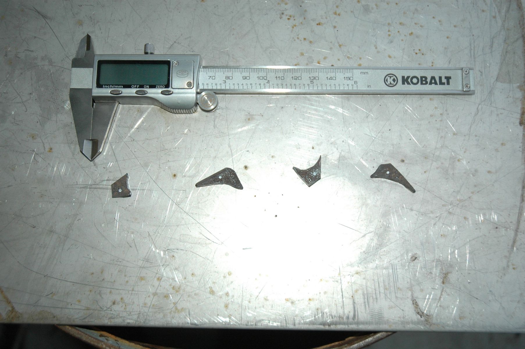

Once upon a time I had to modify the rear motormount gussets above the swingarm. While figuring out the easiest way to repair the destruction, I had left off with some gaps on either side of the gussets like so:
These little "gaps" are much too big to fill in with welding wire/rod, but are small and asymetrical enough to be a big PITA to grind out each individual puzzle piece. But today I did just that!
You will notice the tig rod I tacked to the center of each piece. Thats for me to hold it in place while I tack it to the frame like so:

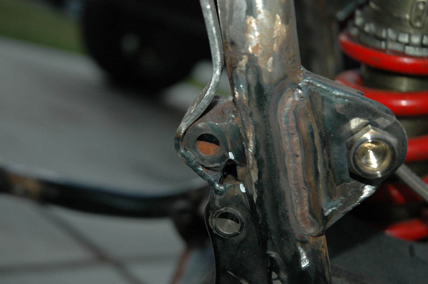

Then tacked to the frame:
And finally, fully welded:

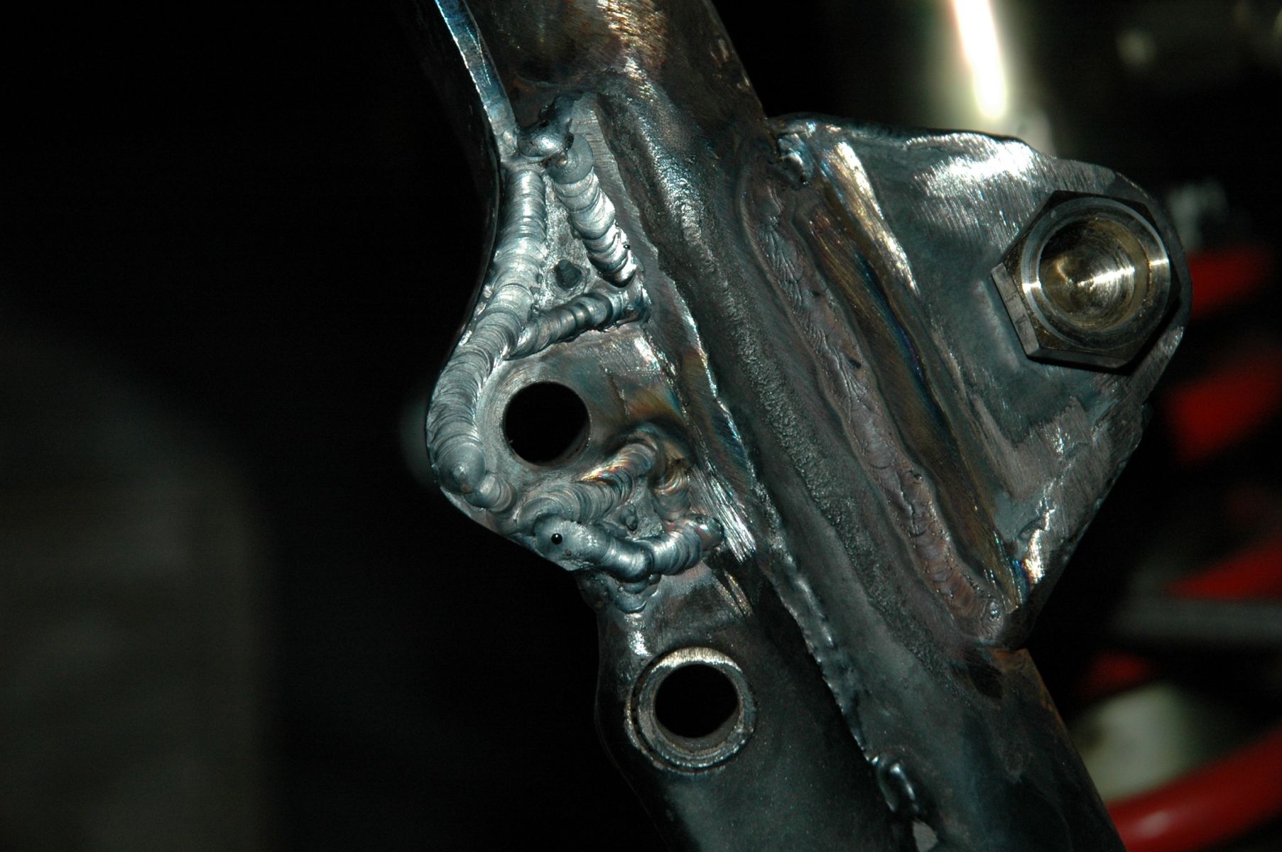

Its nice to get that out of the way! After this post I'm going to go out and finish welding the top subframe mounts, and the main frame will be complete, and ready for weld clean up and paint prep. The subframe is nearly complete as well, still needing passenger peg mounts, and possibly a bracket for the tail light. I have some late model ZX10 passenger pegs, but after some studying, I don't think they will flow right asthetically, so I got some GSXR1000 pegs and see what I can make of that. I'll post pics of each so you all can see and offer input as well.

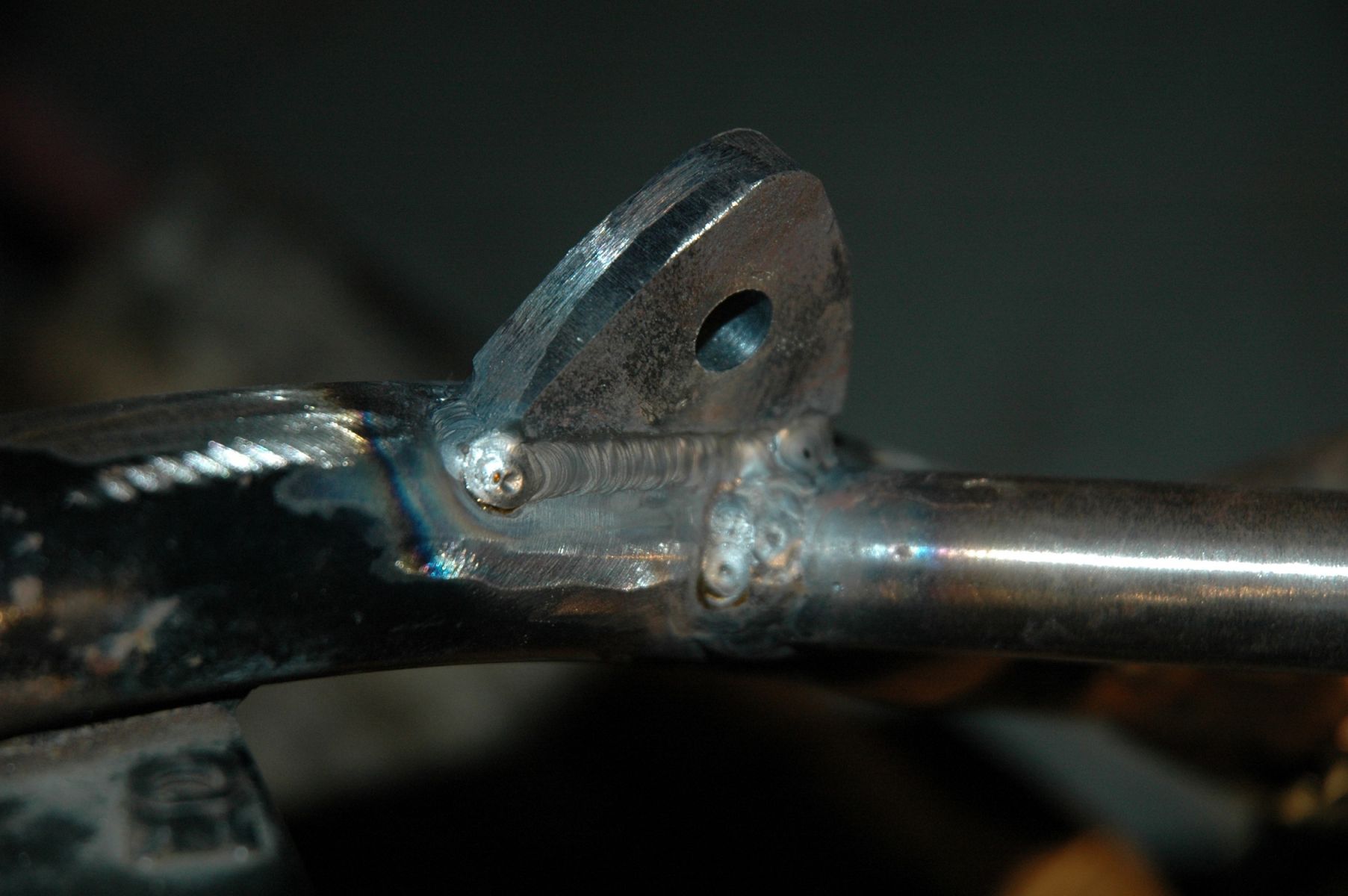

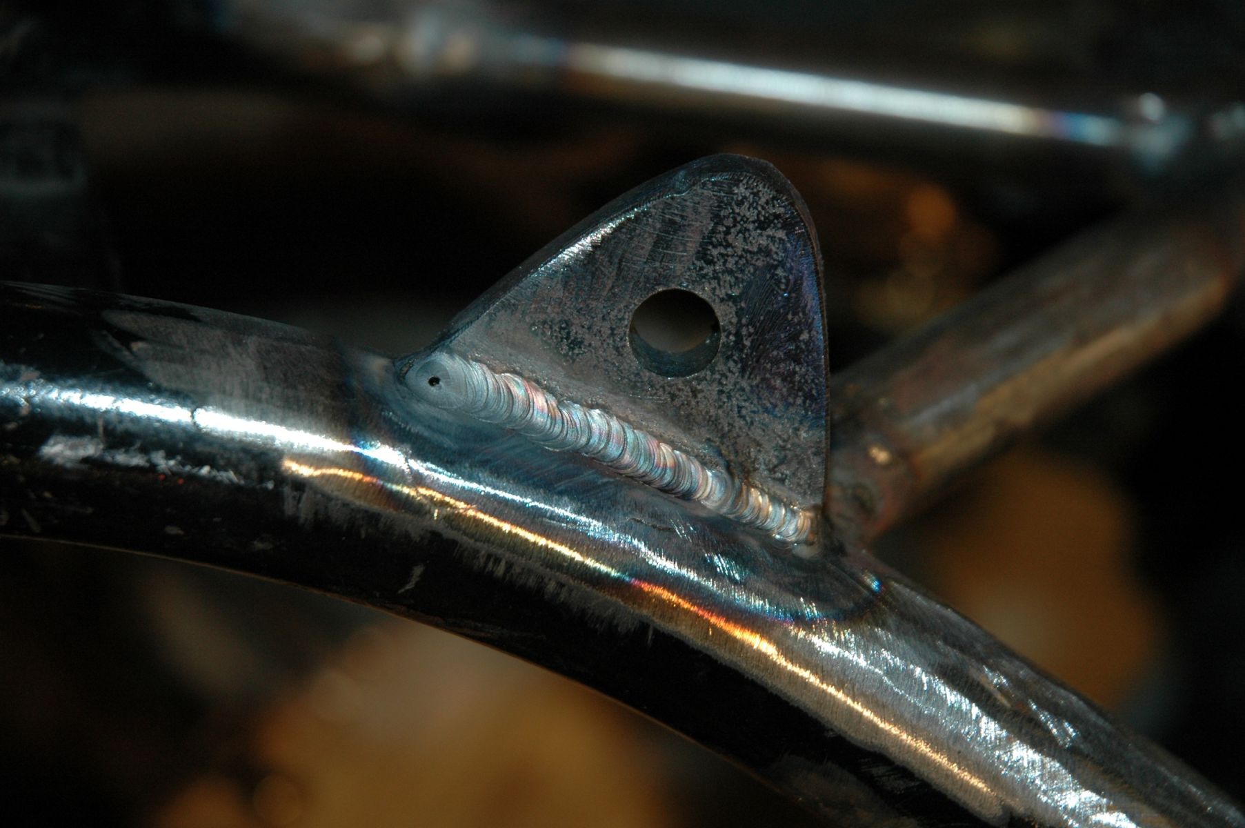

Finished welding up the top subframe mounts, and snapped a few pics. Damn, I think these are the prettiest welds I've done on the whole bike!!! :woohoo:
Of course, thats not saying much considering the company we keep on this forum, and the master fabricators that put my work to shame :whistle:
The top left side outer:
The top right side inner:
Now that those are welded up and the swingarm/upper rear motor mount gussets are repaired, I can start grinding and sanding to clean it all up! Now I'm waiting on the new passener pegs to get the mounts figured out. Baby steps.....slow and steads wins the race. I need to jump back into this one.
