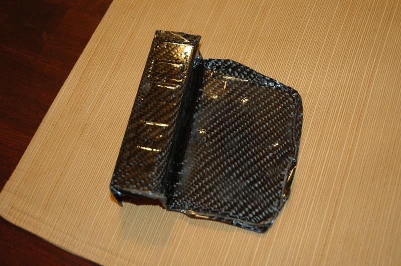

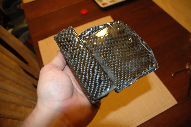

Man, I wanna know what epoxy resin you used Josh, because my stuff is pretty mild. Its the polyester stuff that kills me. I didn't want to fight with demolding this little panel after it was fully cured, so I stripped it out while it was still green.
Note: any of the pearls or glow in the dark powder doesn't work well in carbon laminates.

I started with West Systems, and ended up with some sort of 2:1 epoxy that was locally available.

I prefer the 2:1 and 3:1 epoxies over West Systems 5:1 products as they are more tolerant of minor mix ratio errors, are cheaper, and are water clear. I'm not a fan of West Systems products...mostly their pricing though :whistle:

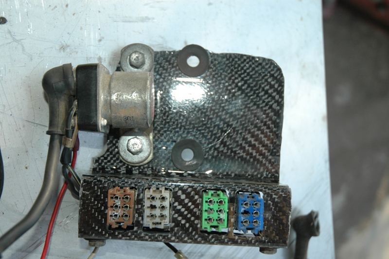

Could be worse! Could be better too though. I can live with it. Tomorrow I will get it mounted, as well as make another flat carbon panel for the other side to mount the reg/rec unit. Perhaps I should make a set of sidecovers tomorrow too.....I need a clean, usable set for mocking up

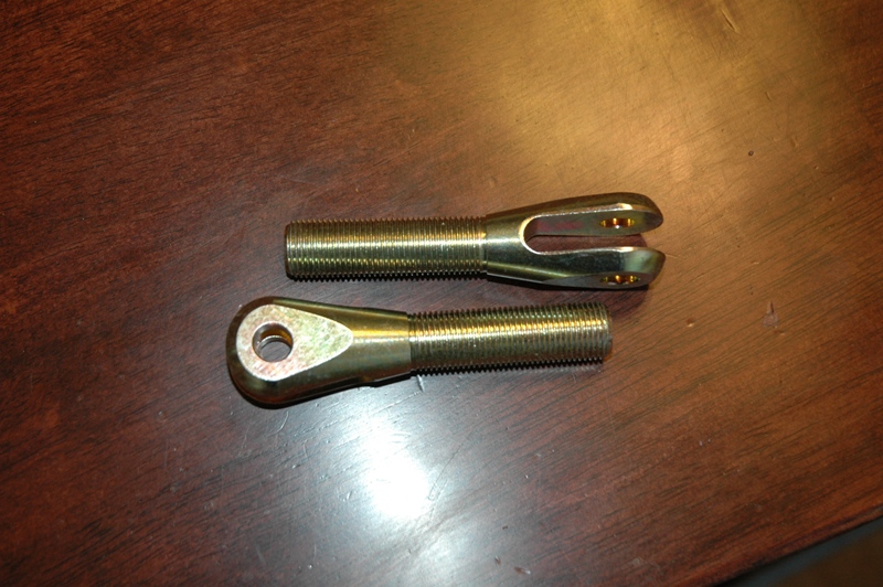

They came from different sources; The tube adapters are scheduled to arrive Wednesday

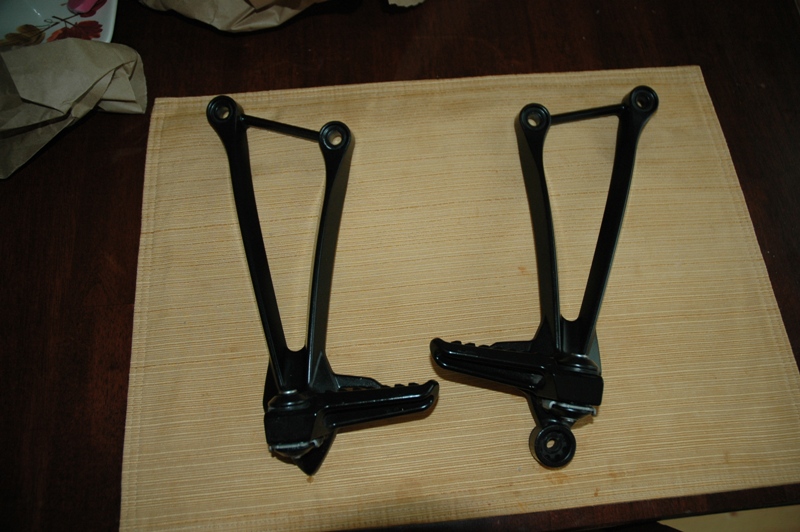

porchev914 wrote: Looks good Leon, just about ready to ski behindI got my passenger peg brackets in today :woohoo: From an '08 ZX10R:
9.5" distance from centerline between the mounts to the peg. 5" offset from the mounting face. I'll put the seat on this weekend and have the little woman see where they feel the most comfortable, then get to work on the mounts
