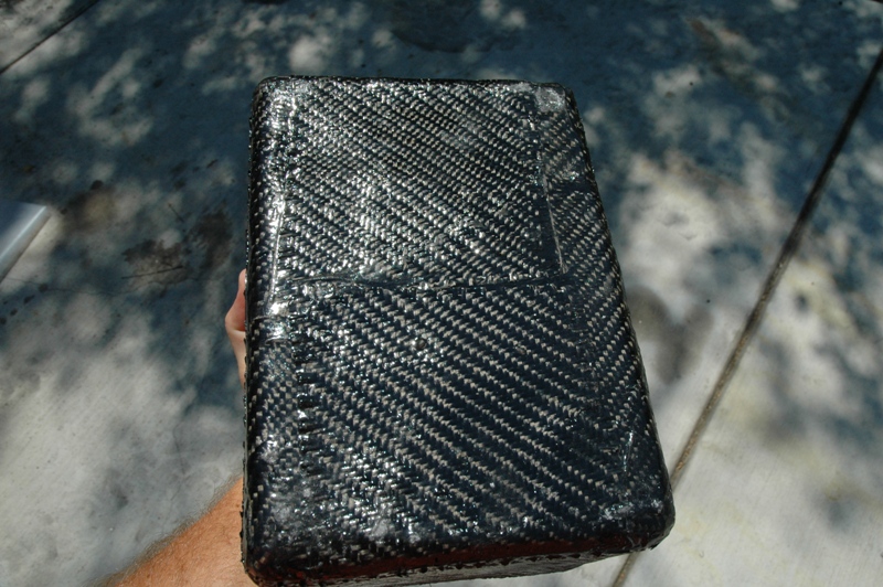

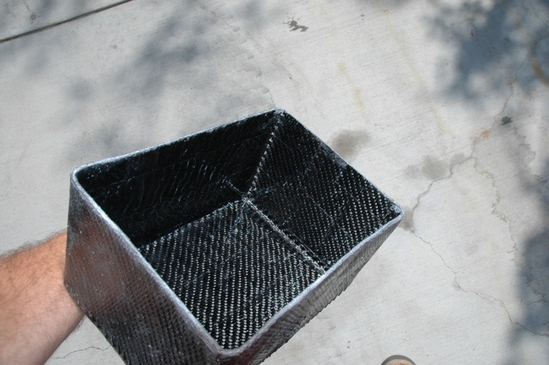

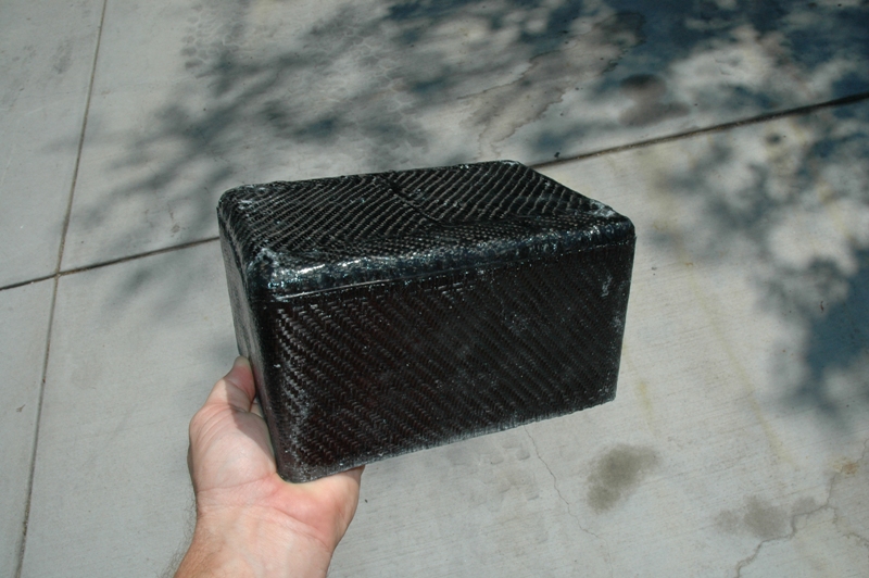

Here you are Mark, my failed attempt at a carbon fiber battery box :sick: I gotta warn you though, its rough looking. No smooth molds or vacuum bags, just down and dirty wet layup over a block of styrofoam

thanks for the pics. they tell me what i thought i would see. i didnt think it would look too smooth, which it does not.
good enough for a bat box though.

Nope, not smooth at all. The best way to get it smooth without sanding is to wait until the last coat of resin tacks up, then add another coat to fill in the fabric weave. The problem is the resin is heavy. Another solution would have been heat shrink tape; wrap the block after the layup and turn a heat gun on it to compress the laminate. That would have smoothed things out.

sure many could make a case for all items being GP team finish... gonna be tight finish .....on your bike for sure .....but that item...to me...looks right...it looks right to me...couple nice finished mount holes nice .thing is one off nice...
