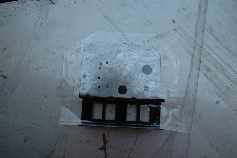

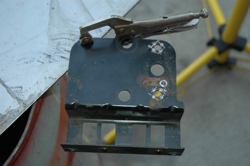

I ended up having to drive out to Fontana in the early afternoon to do some QC work at a precast concrete manufacturer, and didn't get home until after 12 am. Before I left I did get a chance to dissassemble and clean up/prep the electrical mounting bracket. I cut off the welded nuts, wire ties and the fuse box mount. Cleaned it up with a sanding disk and covered it in packaging tape. It won't be perfect, but its a one-off bracket that no one but me will see. Slowly.....much too slowly sometimes :pinch:

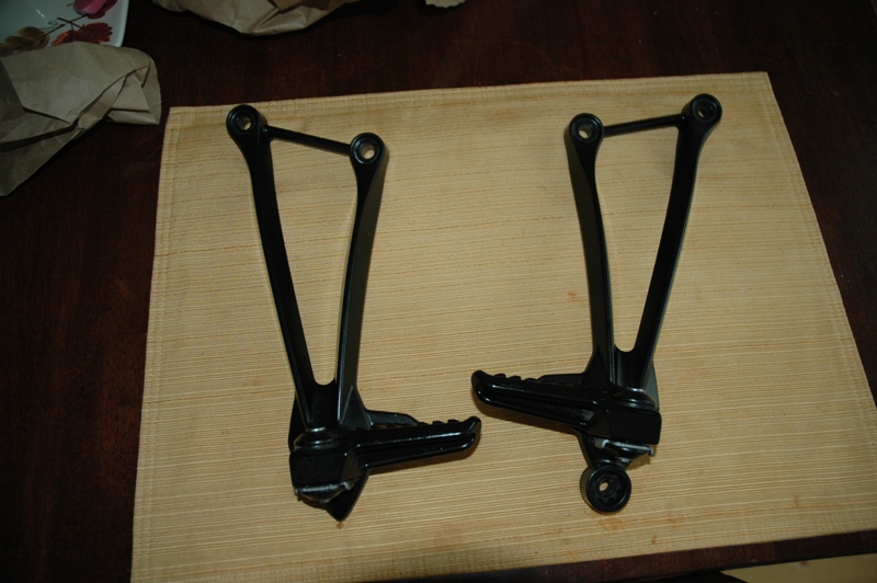

I got my passenger peg brackets in today :woohoo: From an '08 ZX10R:
9.5" distance from centerline between the mounts to the peg. 5" offset from the mounting face. I'll put the seat on this weekend and have the little woman see where they feel the most comfortable, then get to work on the mounts

On the electrical panel, I stripped the back:
Then I went over it with a sanding disk to clean it up and covered it in packaging tape:
Time to cut some cloth out, mix some epoxy and make a new plastic bracket

What is wrong with me? I mixed some epoxy resin, cut out 5 patches of carbon cloth and did a wet layup. Heck, I even threw in some glow in the dark powder in the resin, just to see what it would look like. But after I was done with the "simple" copy of the steel bracket, I couldn't leave it be. I figured I'd get a better product if I vacuum bagged it, so I rushed to throw a bag together get the part in and pull a vacuum before the resin started setting up (I used fast activator) So now the bracket is on the bench under a vacuum, and I hope my rash bagging won't backfire on me and necessitate redoing the part. Ahhh, such is life, eh? I should go put my forks and wheel back on, bolt on a carbon sidecover and the seat so I can better assess the passenger pegs.

I meant to tell you that the third gen zx-10r passenger pegs seemed longer than either of the two that I have. That tail keeps getting higher on that bike. Looks like you figured that out on your own.
