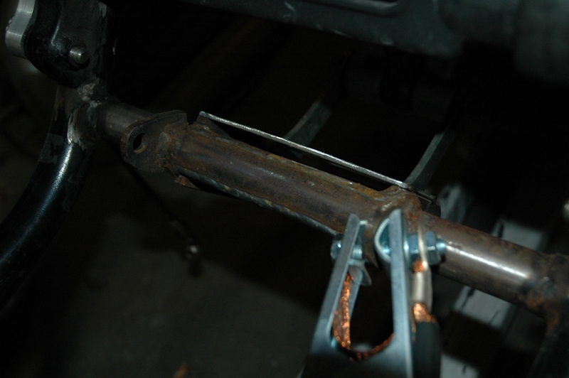

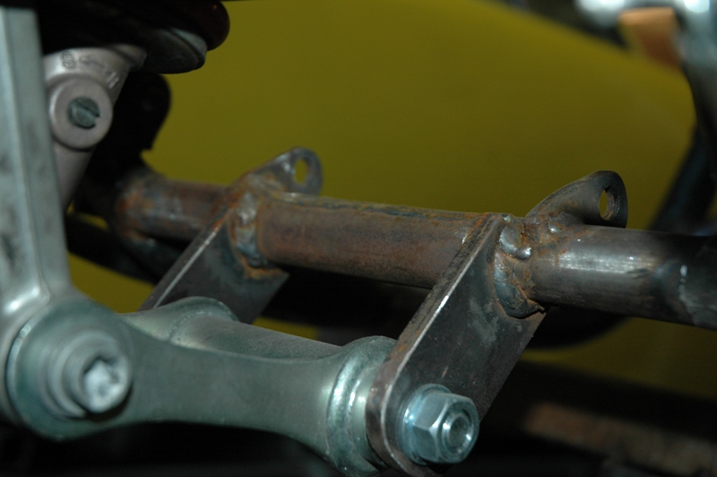

Miracle of miracles, I worked on my bike today :pinch: I had wanted to add some lateral and shear bracing to the bottom shock mount, and I never got around to it till this afternoon. The bottom shock mount before I did anything looked like this:

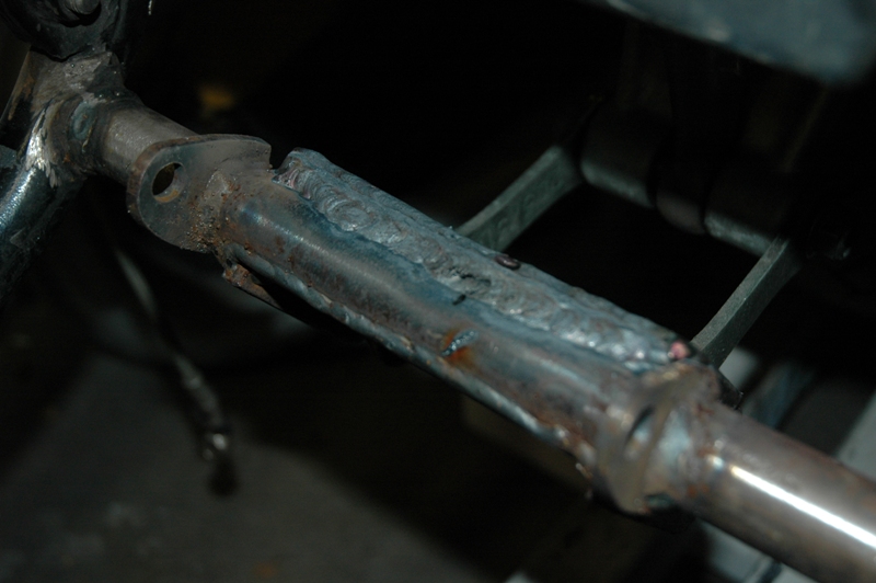

I added a top shear plate to keep the mounts square, but it left a small gap at the front of the plate:
I filled the gap by cutting a strip of metal, and TIG welding it top and bottom. It's not pretty, but no one will ever see it when the bike is assembled

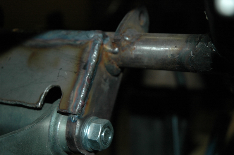

Then I wanted to put in some corner lateral bracing on the outside of the mount ears. Nothing big or heavy, just a little extra to keep those ears from wanting to move side to side. Without the corner bracing:

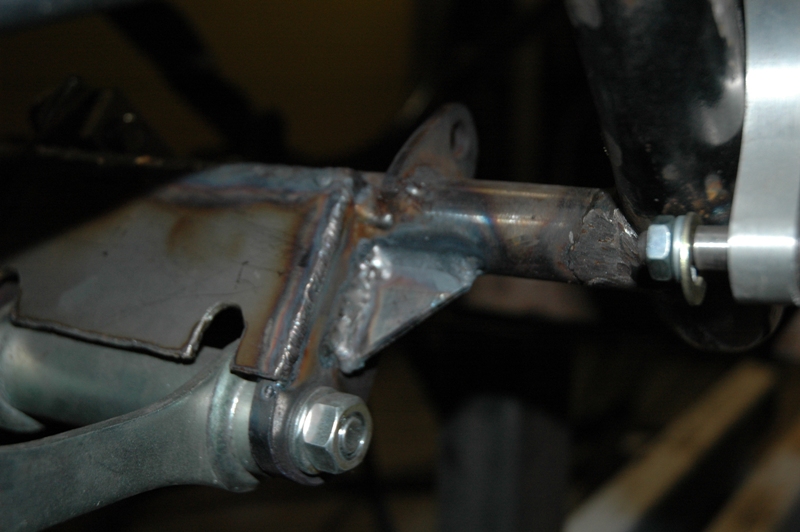

And with the 1.5" braces:
I can definitely tell that my tig skills need some work, especially in the hard to reach spots! Tomorrow I plan to get some of the electrical stuff mounted, or at least some of the electrical mounts installed.....perhaps I'll start working on the battery box if I have time.
