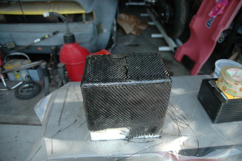

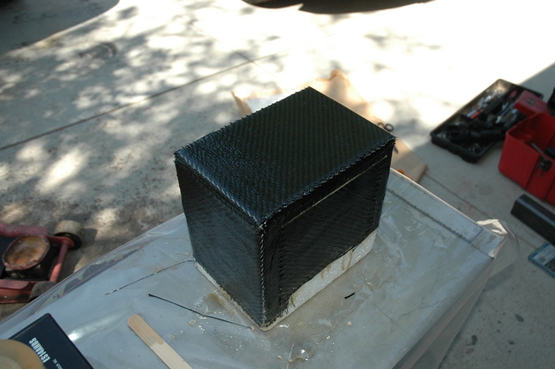

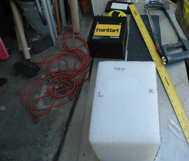

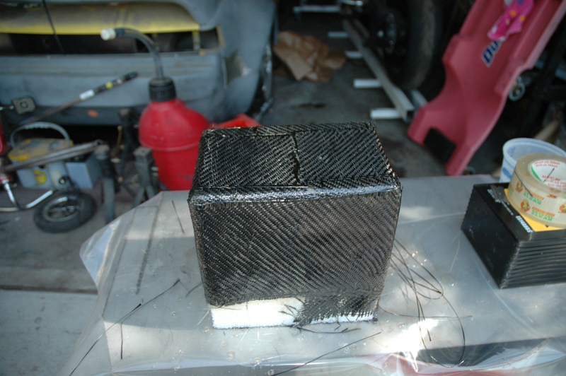

So there I was, staring at my bike, wanting it to be done. I was thinking about paint, and the few tidbits I needed to finish the engine. But reality sunk in, and I realized I still had fabrication work that needed to be done before I could think about cleaning up the welds and painting the frame. Namely, I still had to make a battery box/mounts, electrical mounts, tail light, passenger peg mounts and outboard bearing support frame mounts. I bought a used '05 CBR1K tail light ($9 shipped) to see if I can make it work ok. I bid on some '05 GSXR750 passenger pegs, hopefully I'll get those for the $10 opening bid. I removed the stock electrical panels from the factory battery box, and set them aside. I need to make the battery box and mount the battery, then see how I want to integrate the electrical components. So this weekend, it comes down to the battery box. I had visions of titanium battery boxes, but I want progress so I settled for less exotic materials.
I started with a block of styrofoam and cut it to fit the battery plus a little for some foam padding. Nothing fancy, I used a straight edge, a sharpie and a hacksaw. I used a styrofoam block instead of the battery as a mold so that I could make the box deeper than the battery, and trim it to my desired depth.
I wrapped the styrofoam in packaging tape to keep the resin from sticking to it and make demolding easier. I picked up a different type of resin that I wanted to try on some other parts, and figured I'd try it out on the battery box. The new resin is vinylester, kinda in between Polyester and epoxy. Close to epoxy strength, but closer to polyester cost. It is catalyzed the same as polyester with MEKP, so it stinks, but its viscosity is much thinner than polyester, and thats what I was looking for.
The first layer of fabric
Then after a few layers of chopped strand mat, extra corner and edge reinforcing, a couple more layers of carbon fabric on the outside
Now I'll let it cure, check the battery for fit, trim it and see how I want to mount it. Then I'll mold in some brackets that will bolt to tabs I'll weld onto the subframe, then I'll weld a couple more tabs for the electrical mounts. I should dig my engine out of the rafters and bolt it into the frame and get the outboard bearing support mounts sorted. Details........

I wasn't super happy with the asthetics of the last layer of CF, so I sanded the outside of the box real quick and wrapped it one more time. After letting it cure I cut the top half off and dug out the styrofoam. I tossed in a piece of the foam padding and the battery to make sure it fit :whistle:
It could be worse. I certainly could have made it thinner and lighter, but it's holding a 10 lb hunk of plastic, lead and acid. I'd rather it hold up.......... Tomorrow I'll stick it in the frame and see where I can put the mounts to hold it. Perhaps I can even get the mounts cut and welded/laminated in place. That would be something

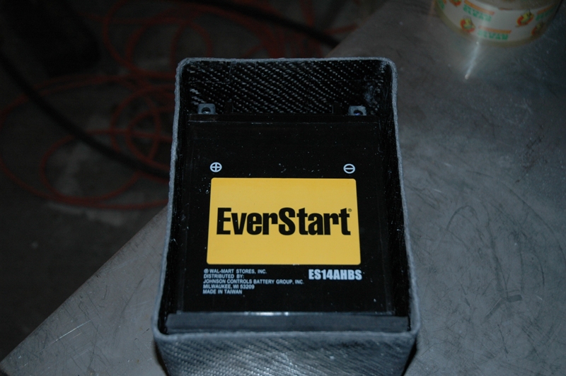

Nevermind :sick:
:blush: I tried to fit the box in and......no go. I made the box wide enough to fit some 1/8" foam padding in on each side. That, plus the thickness of the laminate and the box won't fit between the frame rails. Now I have to make the battery box out of metal. Now I have an interesting carbon fiber box that, well, I can't do much with. Oh well, these kinds of things are to be expected. I'll make the next box out of aluminum, what the hell! :laugh:
