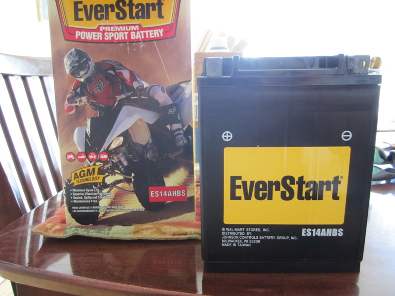

I FINALLY got a battery. $75 at Walmart. Now I can make a battery box, and more importantly, the mounts for the battery box in the frame. That is one of the last frame fabrications I need to to make, besides an exhaust mount.....and passenger pegs...and I'm sure I'm forgetting something else :pinch:
I can not for the life of me find any CCA #'s on this battery or packaging. Wierd...

09 Apr 2011 14:20i got my battery from interstate for a little over 50porchev914 wrote: I FINALLY got a battery. $75 at Walmart. Now I can make a battery box, and more importantly, the mounts for the battery box in the frame. That is one of the last frame fabrications I need to to make, besides an exhaust mount.....and passenger pegs...and I'm sure I'm forgetting something else :pinch:

This particular battery is distributed by Johnson Controls (Interstate) but it's still made in Taiwan :blink: What kind of battery did you get for $50? This battery is a Sealed AGM battery. The last battery I got for this bike was a standard vented unit, and it was $45. I need to be able to lay it flat, hence the more expensive sealed unit. If you got a sealed AGM Interstate for $50, I'm taking this thing back and buying from your supplier!!! :laugh:

09 Apr 2011 14:41just a normal batteryporchev914 wrote: This particular battery is distributed by Johnson Controls (Interstate) but it's still made in Taiwan :blink: What kind of battery did you get for $50? This battery is a Sealed AGM battery. The last battery I got for this bike was a standard vented unit, and it was $45. I need to be able to lay it flat, hence the more expensive sealed unit. If you got a sealed AGM Interstate for $50, I'm taking this thing back and buying from your supplier!!! :laugh:

Yuasa shows 14bs batt's at 200 to 210 cca.
i would encourage u to compare the dimensions of yours to the yuasa's most popular 14's and if needed make your box slightly larger to make sure it fits a yuasa. this will give u more flexibility when the time comes to replace your bat .
if yours is the same dimension, u r golden.

Damn, and here I was hoping I could save $25!

You are right Mark, it looks like it would behoove me to make my battery box an additional 1/2" longer to fit a wider range of batteries.
