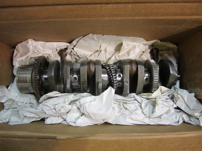

Awww hell, I've got nothin' substantial. I have done a little cleanup on my frame welds, but I need to pick up some more primer and spay the areas I have completed to keep myself from going back to the same spot. But, if I must, I did get this crammed in my mailbox last week:
While I still need to donate $140 to my aging tranny, a battery is my next purchase to that I cam make the box and more importantly, the mounts in the subframe. That way I can finish up any welding and get it painted.
