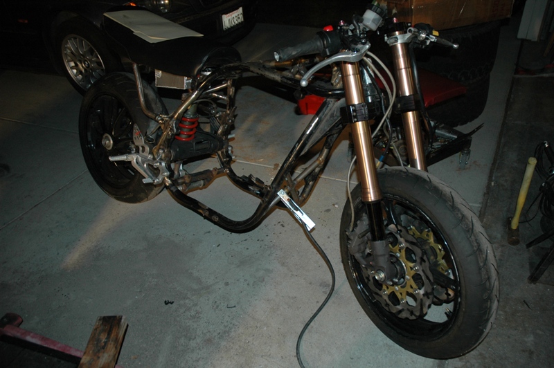

I was working on some tid bits this evening, and thought I'd snap a pic. Just because. I haven't taken a full bike pic in a while. Not much has changed since the last time I took a full bike pic except for the battery box.
One thing I had to accept this evening is that I can't use the R6 rearsets
The master cylinder mount doesnt clear the frame, and I'd have to space it out too far to make it work. So I'm back to the drawing board on the rearsets. Fortunately, it shouldn't affect my time table (as if I have one) for getting the frame finished and painted.

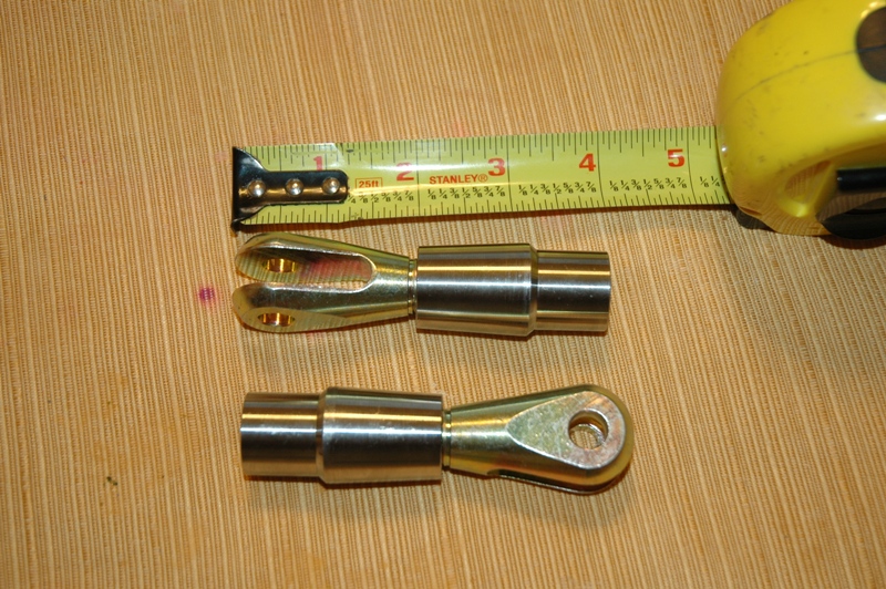

Here you go Leon, those tubing adapters showed up today :woohoo:
I didn't anticipate the adapters to be so long! 4" is alot of realestate at the front of the subframe. I'll definately need to remove and reinstall the right front sidecover mount, maybe the left; haven't checked yet. Oh well, whats R&Ring a small bracket for a nice clean clevis mounted connection? One of the few corners I cut, and LEON calls me on it

I can't tell about the tubing adapters, but the clevis's definitely look cadmium plated to me. Make sure you have adequate ventilation if you are welding on that stuff. The vapors ain't gonna do you any good.

I know, I'm bummed about the rearsets too, as well as my contraband holder
The clevis's are cad plated, but they won't be welded on, thats what the tubing adapters are for bud
The clevis threads into the adapter which is welded to the subframe, and bolts to a small 3/8" bracket welded to the main frame. Simple and clean.

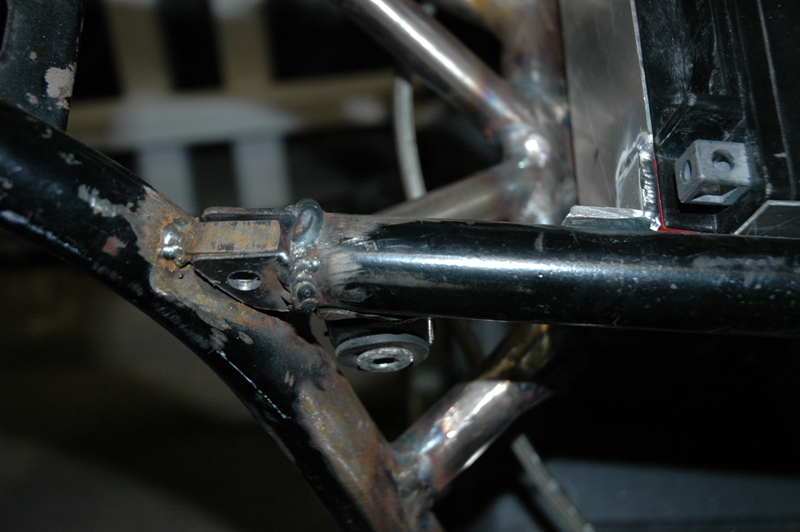

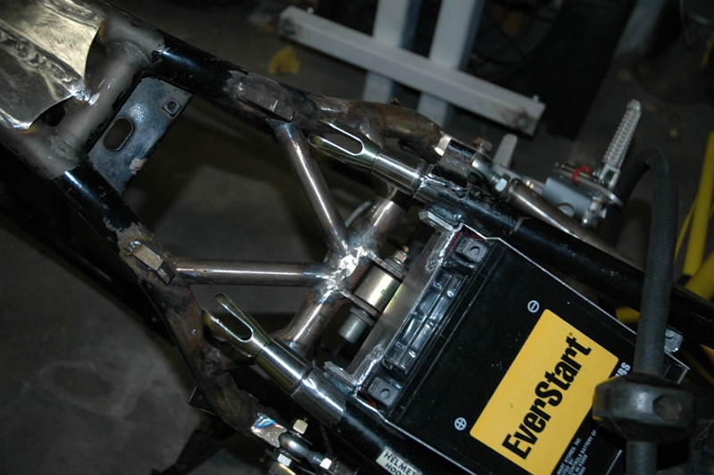

Top subframe mounts; The UGLY right side:
The BAD left side:
The GOOD replacement tubing adapters and clevis's
Hopefully tomorrow I'll get the adapters tig welded to the subframe and the new frame tabs cut and shaped.

The BAD left side:

the clevis's and tube ends give it a nice clean look.almost like you meant to do it that way from the start
