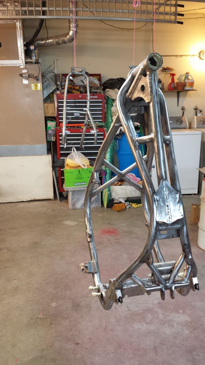

So, I hung my frame and subframe from the rafters in my garage, and cleaned them off with a wax/grease remover and then a tack cloth. Though considering I'm painting in my garage, the tack cloth step was probably a waste of time :whistle: Old habits die hard though~
1st coat is an acid etching primer. Over that goes an activated sealer, then a single stage metallic copper. Lets hope its as understated as I had envisioned..... we'll see soon!!

28 Jul 2013 22:52 #598797 by porchev914
Replied by porchev914 on topic '78 KZ1000 makeover
Main and sub frames ready for primer
