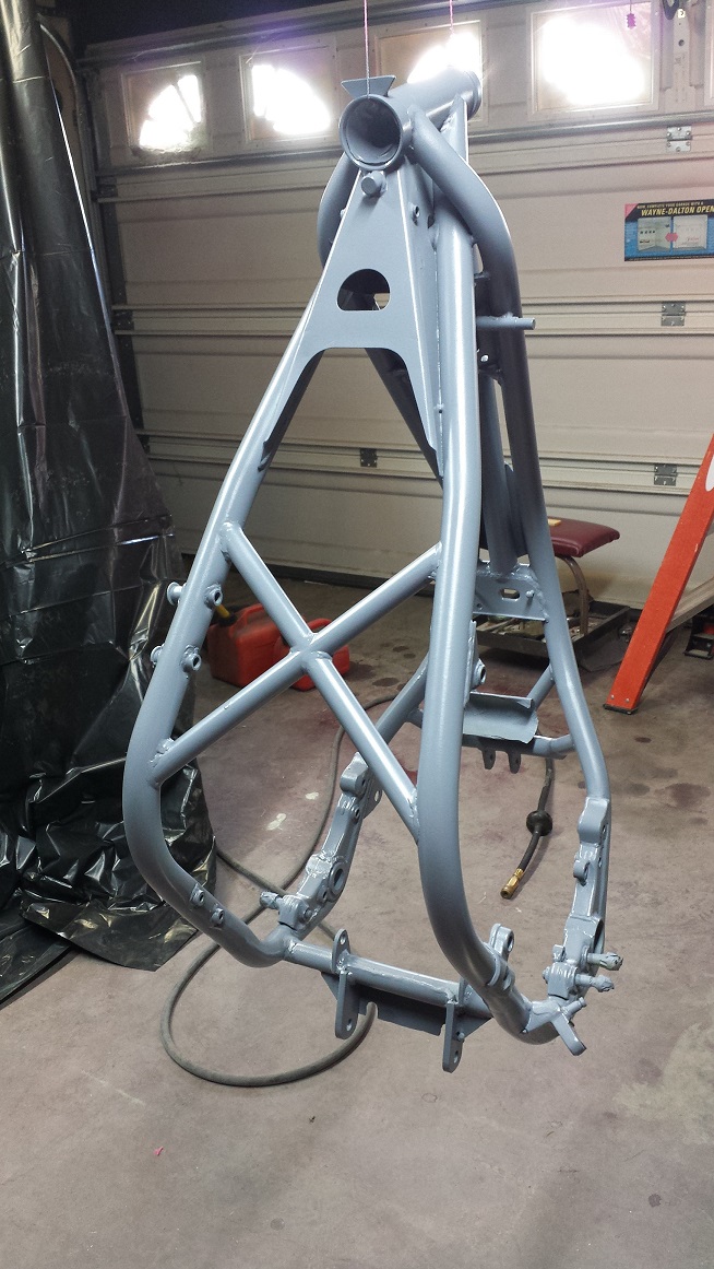

Main frame in that oh so elegant green etching primer

Ask and ye shall receive
Was this fast enough?
I'm going to go put on the second coat, but it's not going to look any different. Some of those tubing joints are a PITA to get to!!!
