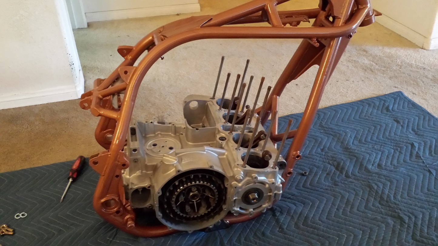

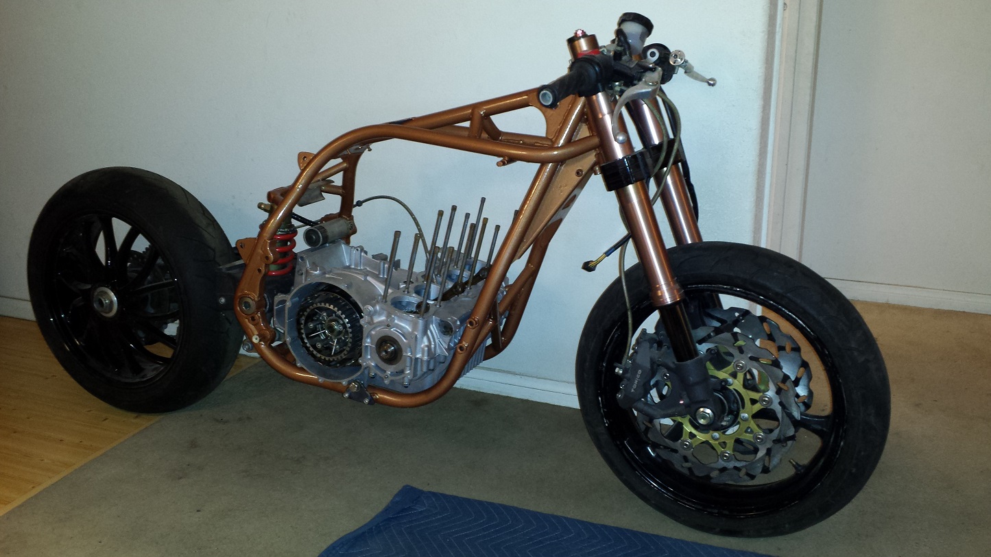

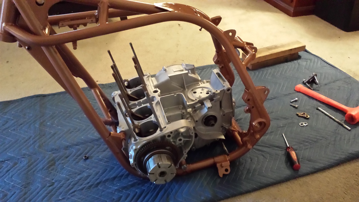

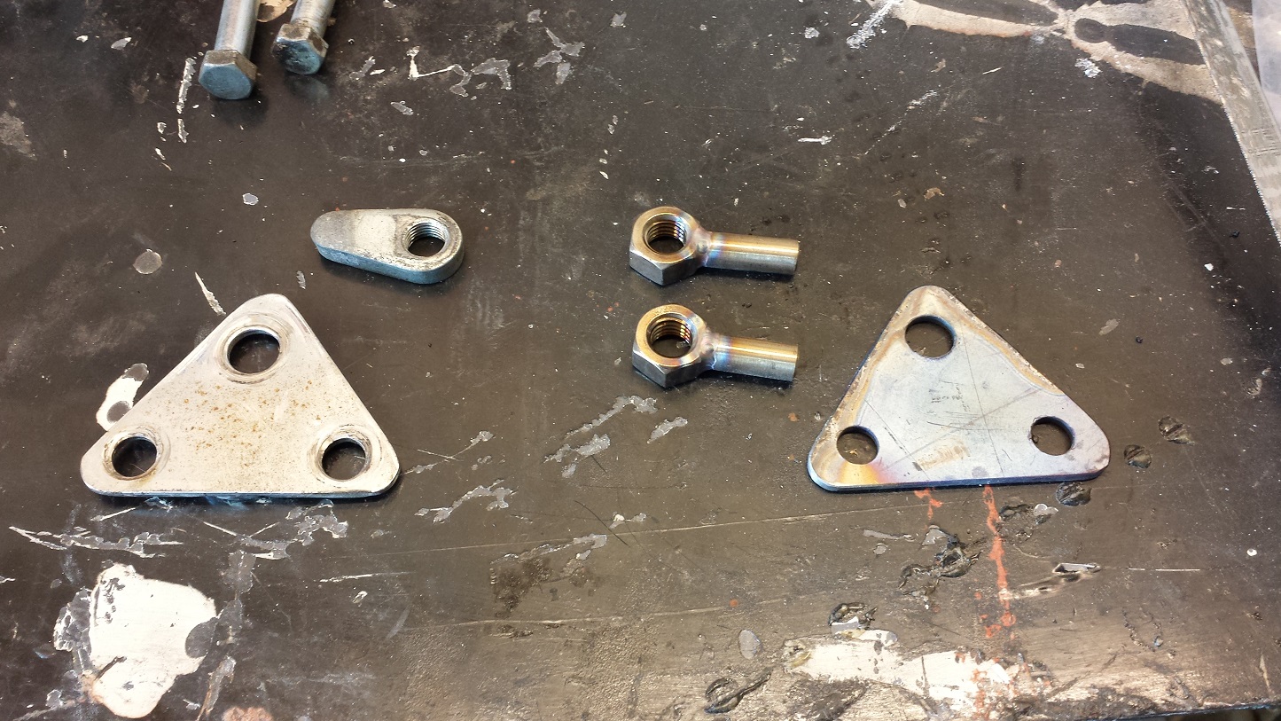

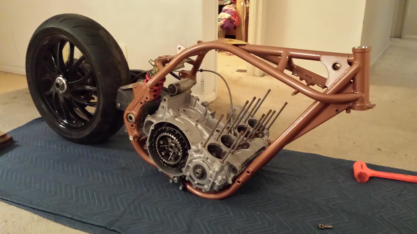

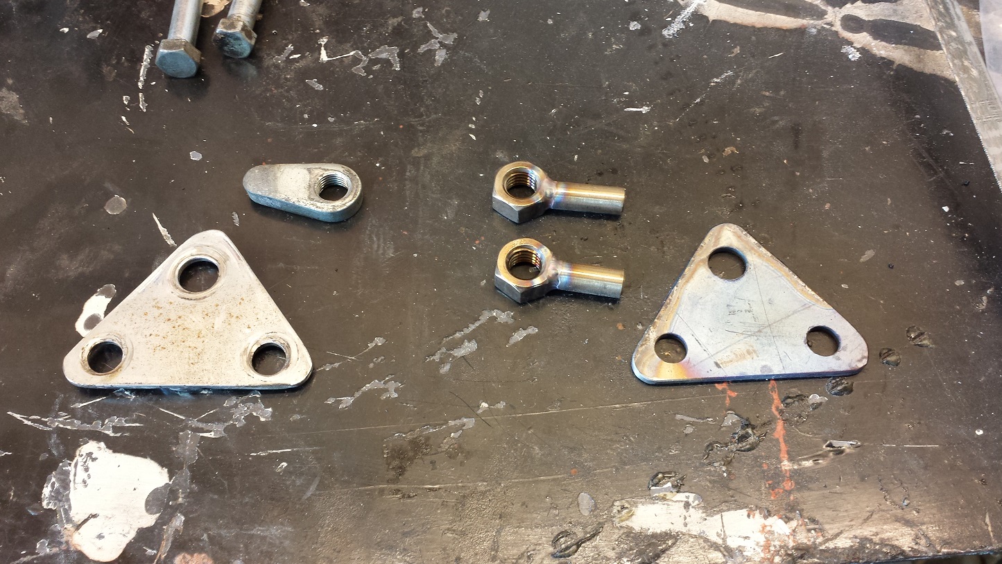

05 Aug 2013 02:21 #599898 by porchev914
Replied by porchev914 on topic '78 KZ1000 makeover
I drug my freshly painted frame into the house and laid out a harbor freight $6 moving blanket and wend to work this afternoon :woohoo: First went in the assembled bottom end:
I seemed to have misplaced some of the bottom motor mount hardware, so I made some new ones out of stainless nuts and some 1/4" stainless rod. Stock on the left, my stuff (including a titanium motor mount plate) on the right:
Then I got the rear suspension bolted up:
Followed with the front end:
