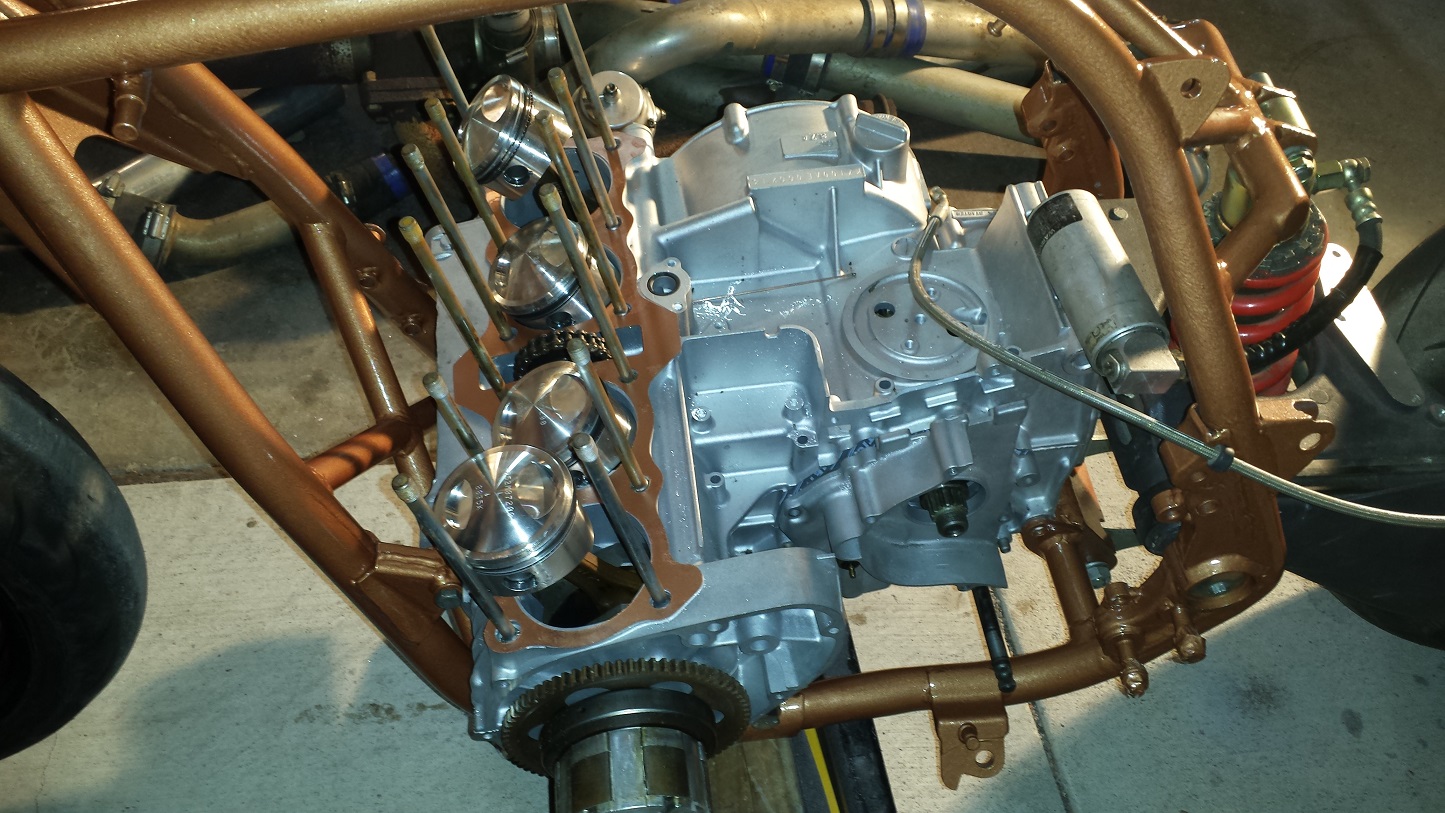

OK, pistons on:
I did copper coat the base gasket, and will likely treat all the gaskets the same.
Then went on the cylinder, which by the way, was a PITA. I put the head on just to keep it closed up. I did lay the tank back on it to see how it would look.
I didn't take pictures, but I replaced the center cam chain roller in the block and its rubber dampers with new OEM parts. I also replaced the rubber tensioner roller and the front plastic rubbing block with OEM parts as well as the idler gear rubber dampers. I did not replace the idler gears, as they seemed to be in good condition with no slop and smooth bearings.
The head is going to come apart so that I can replace the valve springs and stem seals. While its apart, I will clean up the intake ports a little and smooth out the exhaust a touch. Just blend things in a little, nothing crazy or drastic.

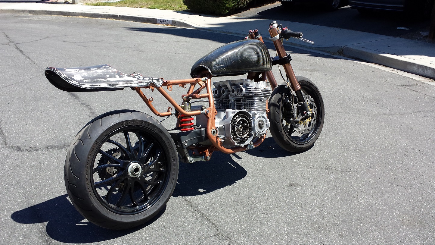

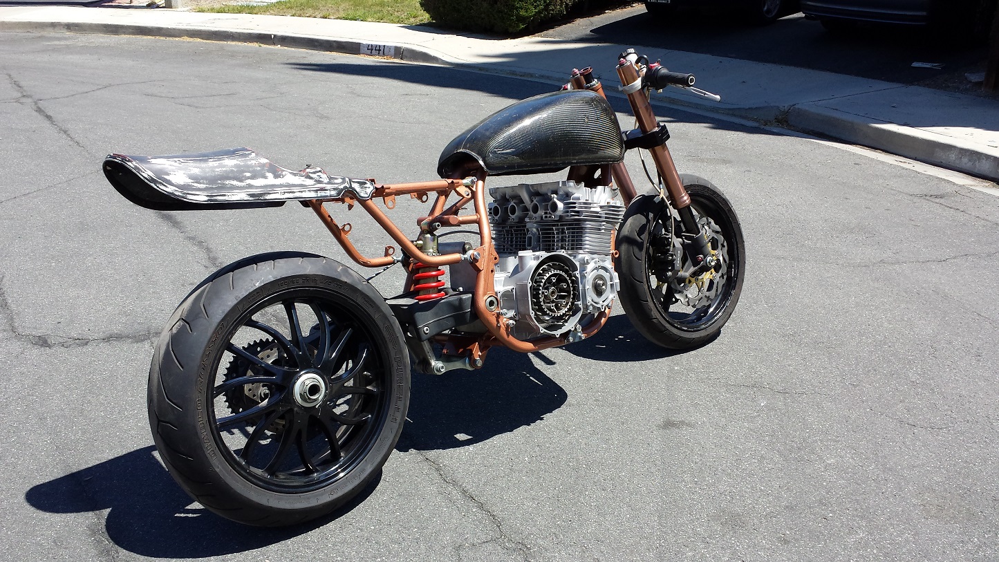

08 Aug 2013 16:52Maybe Leon....just maybe...531blackbanshee wrote: like pics with the sub frame and tailpiece sitting on it maybe ? :evil:
The ugly left side (the tank that is)
Right rear view
Right side view
I did not modify the kickstand or the mount in any way, and the amount of lean on the kickstand isn't far from stock. Overall I'm pleased
