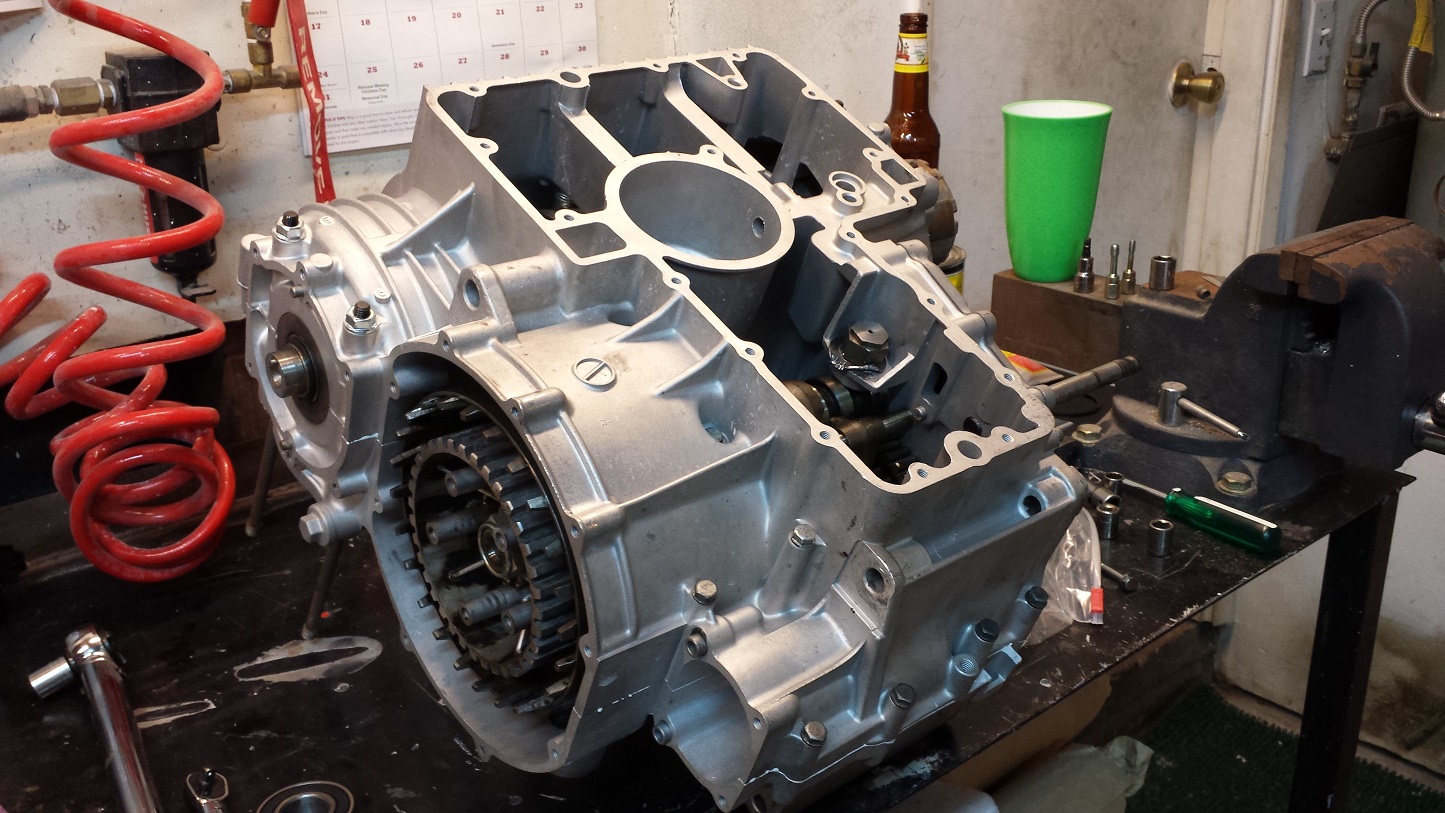

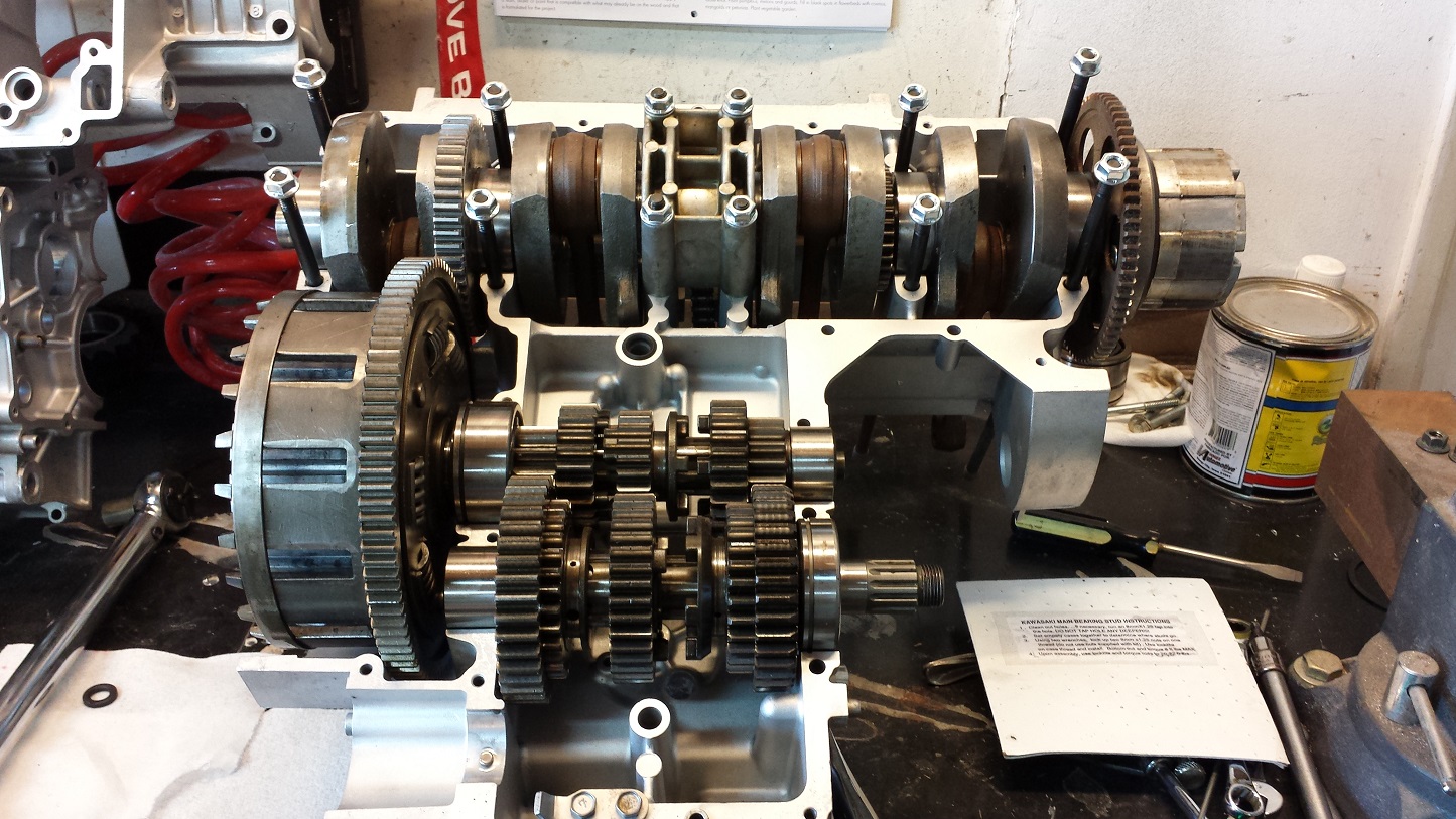

No worries, I did get a little excited for a second though :laugh: So I got the top half of the case put together and the center main bearing support torqued down:

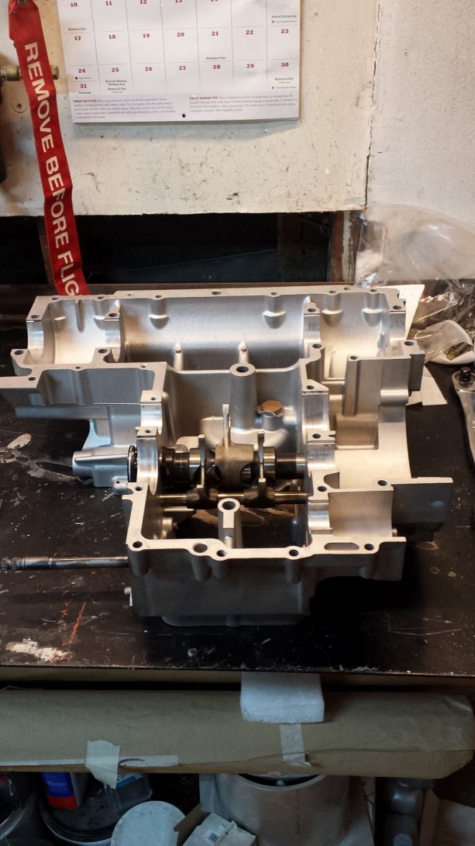

I got the shift drum and forks set in the lower half of the case:
And then put the two together, cleaned up my stock hardware with a wire wheel and torqued it all down:
