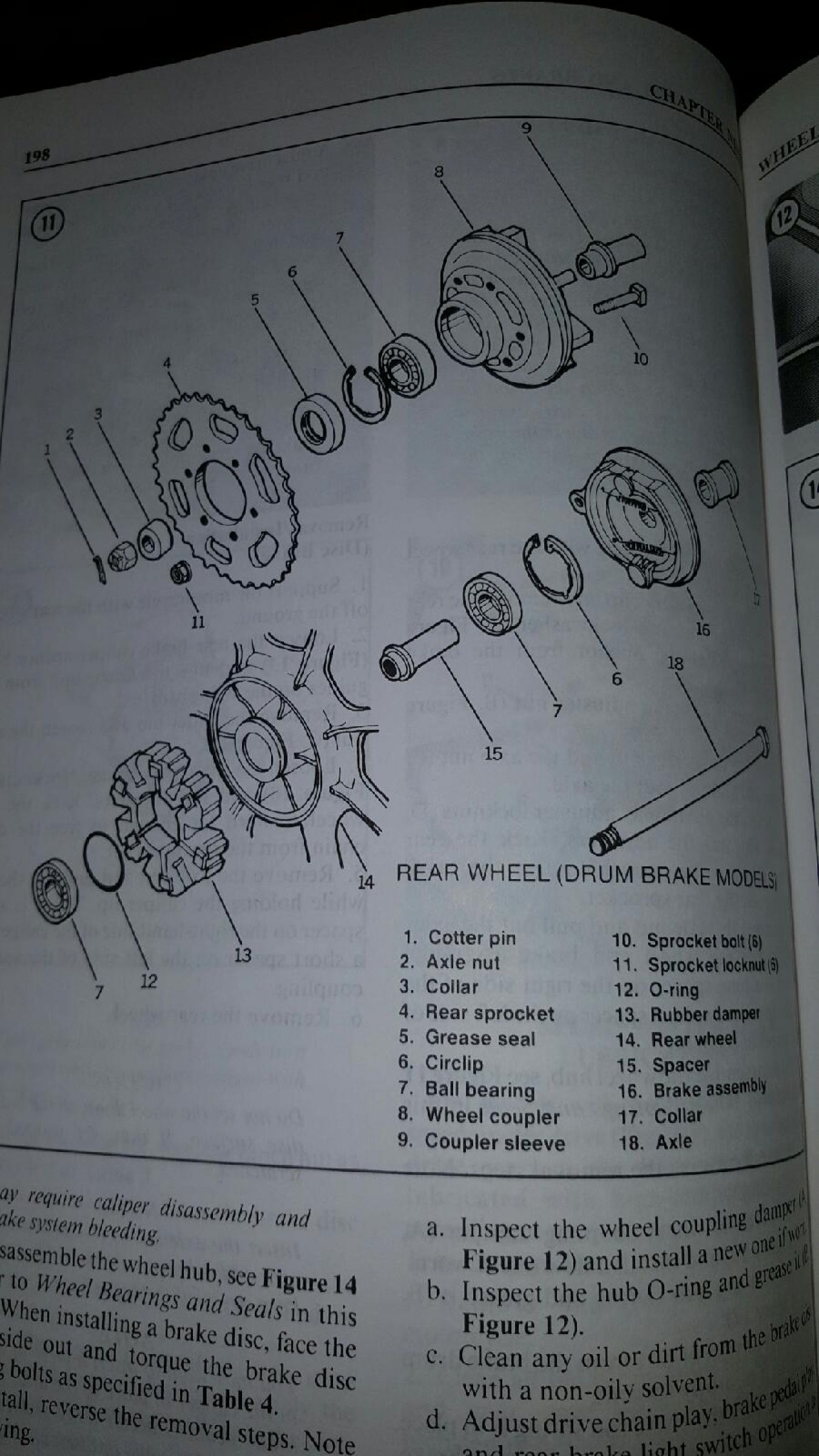

- wrenchmonkey
- Posts: 568
- Thanks: 75
Re: Rear Brake/Hub grinding sound.
12 Jun 2016 21:16Please Log in or Create an account to join the conversation.

13 Jun 2016 08:35
Thanks for the picture. I have a long day at work today, but when I get home, Ill try to pull the rear wheel assembly and get pictures for everyone.
I also noticed this morning on my way out the door, that one of the rear wheel tensioner bolts is missing. i, I will need to get a new bolt and lock nut asap.
