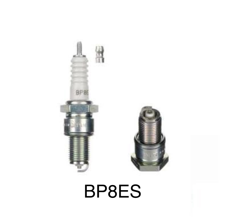

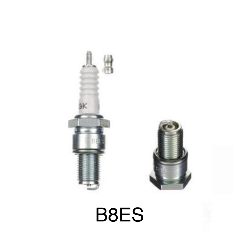

On the plugs...I swapped the BP out for the factory spec plug (not the best shape) after gapping to spec and the bike didn't have enough spark to fire. Swapped em back to the newer BP that are supposedly incorrect and it fired right away. I did notice later my + battery connection was loose from fkng with my push-button starter so it could've been that. Nbd, I ordered factory spec plugs cuz' I couldn't find em' locally but I also compared the BP to the correct plug and the length is exactly the same. Didn't seem to be a longer reach. Anyways, bike continues to impress and I'm still afraid to pull the carbs haha. Oh i've got my air/idle screws out 1 turn on all 4, seems to like it, possibly a touch rich, maybe 1 1/4 is the sweet-spot.

Here is the difference between the two plugs.
The 14mm thread appear same length, the ceramic and electrode extend.
