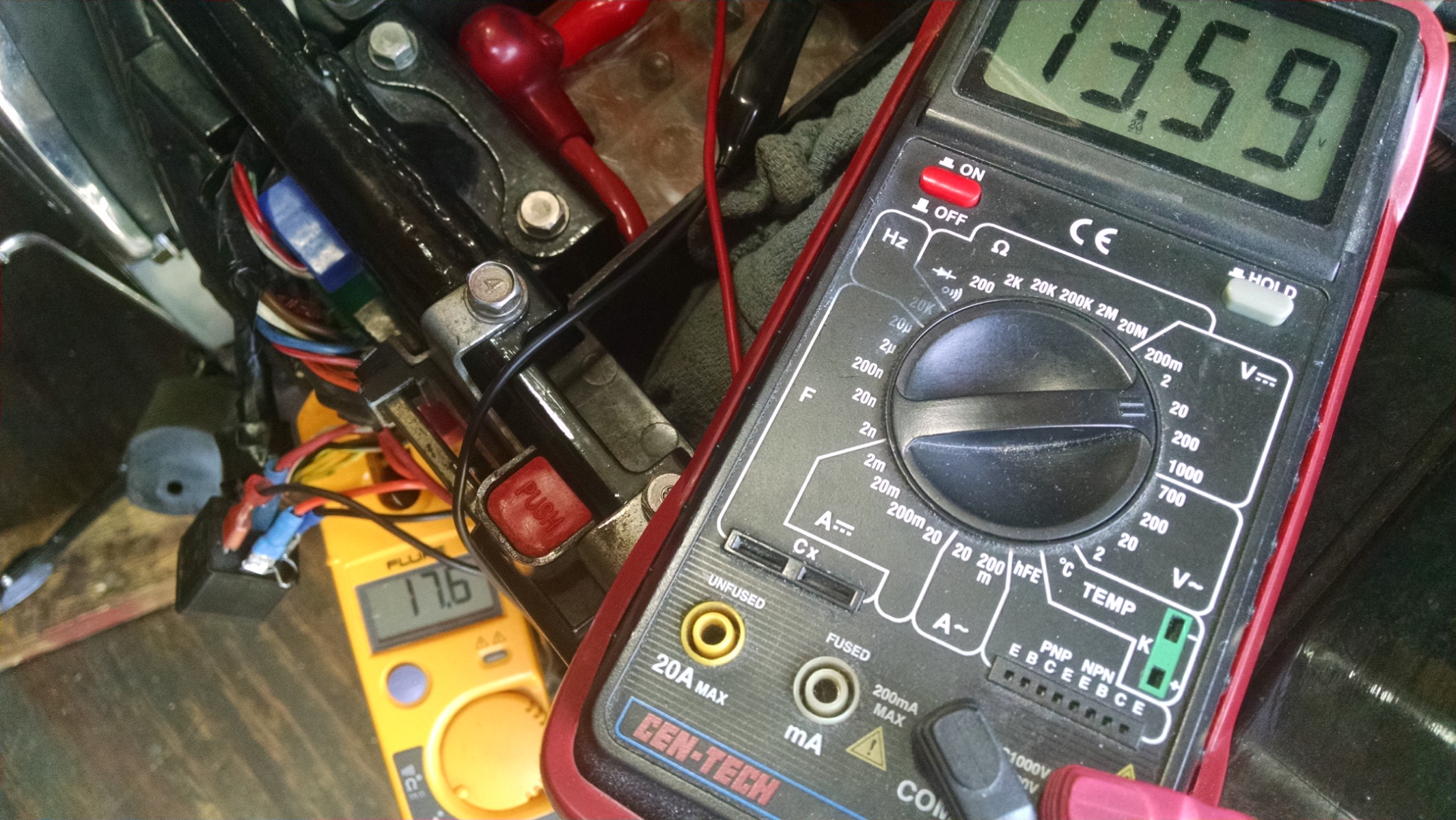

Annnnd, that HF 6 dollar meter got me readings didn't it? Only had to exchange one.

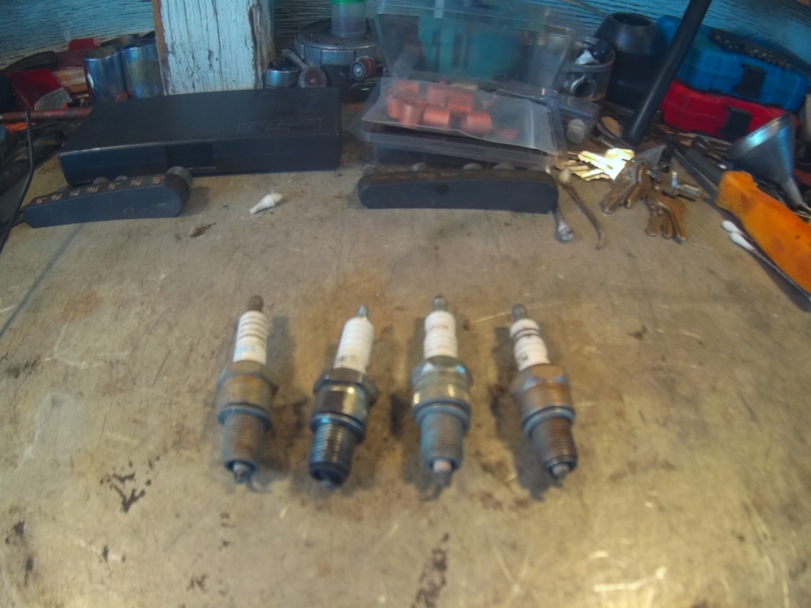

Hey on plugs I'm using ngk bp8es as I couldn't find b8es locally, that cool? I don't think it's a resistor plug. I like your stories, sometime I'll have to tell the one about how I taught myself how to start and ride a 76' Kawasaki 125 enduro over the course of months after school. A bike similar to that is on my bucket list of bikes for sure!

The BP8ES plugs are a longer reach not meant for your engine. I used them when I was fouling plugs but stopped using them when I installed new valve guide seals in 15. I wouldn't use them in a healthy engine. Champion and others have plugs that will work in place of the B8ES plugs. The NGK B7ES plugs will work for winter riding. The other brands have a slightly different heat rating. I've used most of them without ill effects. BP not withstanding of course.

Sounds good Swest the bike came with correct plugs that don't look too bad I'll regap and throw em back in. I may have the champions come to think of it too.

Yeah a HF freight meter.. and you might have the test light thing figured out soon now that you leaned how to ohm out a coil I see another west coast chopper on the horizon. lol This is a HF meter..
