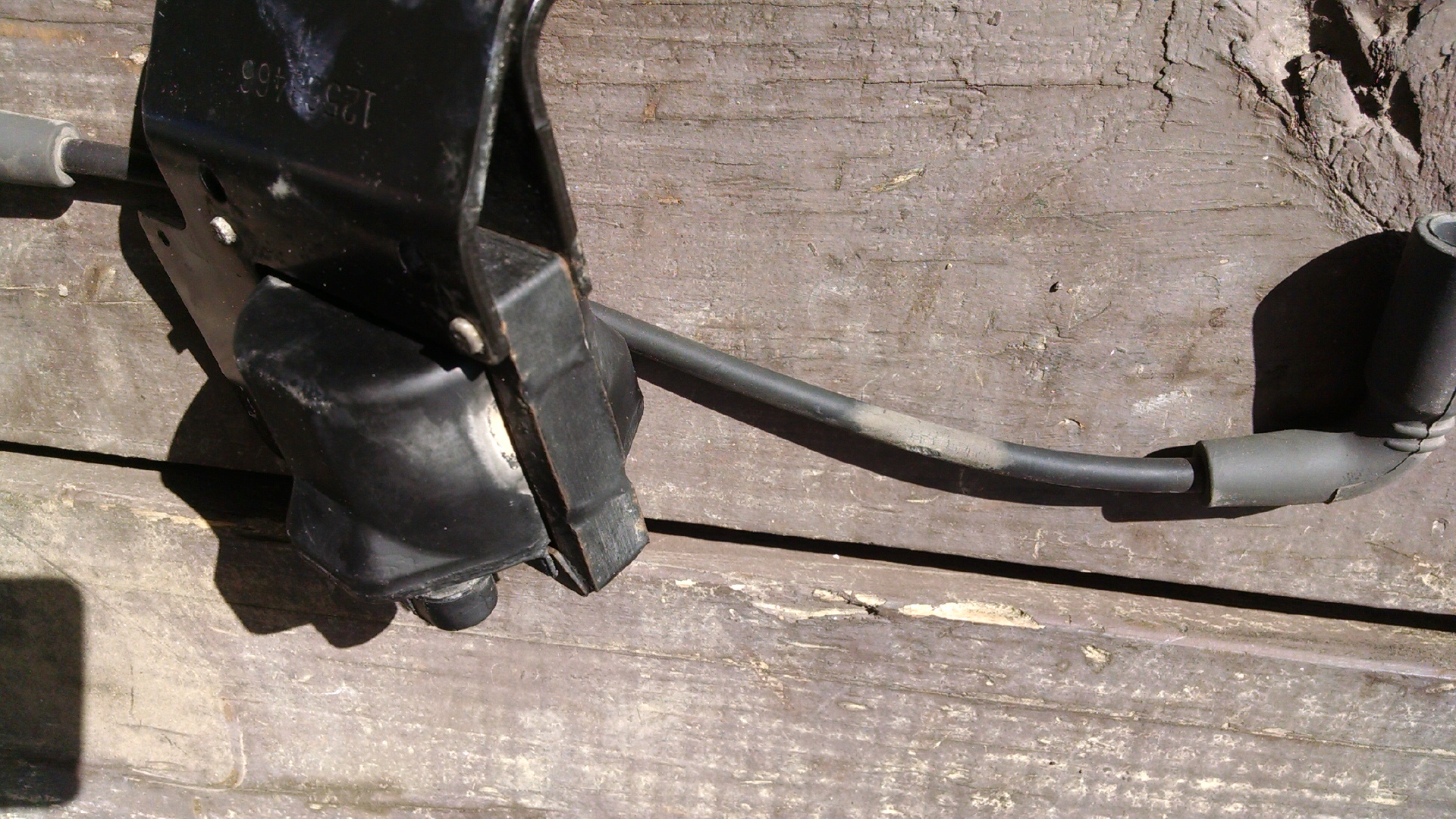

Back to the coils. You are obviously not satisfied that the bike is running strong now.. You can test the primary and secondary windings with a multi-meter. It is outlined in the service manual. One thing you may not want to do is start putting mis-matched parts on the ignition system, or you will open up a brand new can of worms, end up spending money on parts that you did not need in the first place until you "improved" them. This is a waste spark system, meaning two plugs fire simultaneously from the same coil. Both coils are designed to run with ~10K secondary resistance TOTAL in the plug circuit. Resistor caps, wires / plugs combined impedance.. If you start putting car wires, resistor plugs, etc, and you might as well plan on having ignition / coil problems the rest of your life. Coils normally go bad when they start arcing internally. The igniter can be damaged from a overloaded secondary.
Electricity is lazy. too much secondary high voltage resistance causes internal arcing. From my truck. First the coil wire arced open and had too much resistance, then the H/V coil started arcing to the laminated frame because the electricity had nowhere to go.
Your time would be better spent fixing some of the more obvious stuff like the fork boots and all that other thoroughly "improved" stuff.
The internet is a wonderful thing, Like a library in your living room.. just use caution as to what information you use. You will ultimately be the one to pay the price for bad info and botched "improvements" .

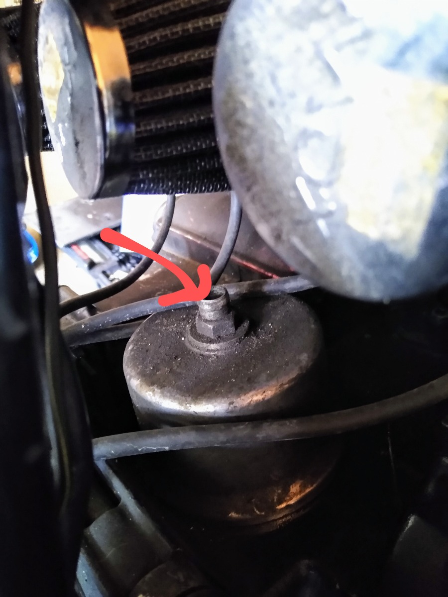

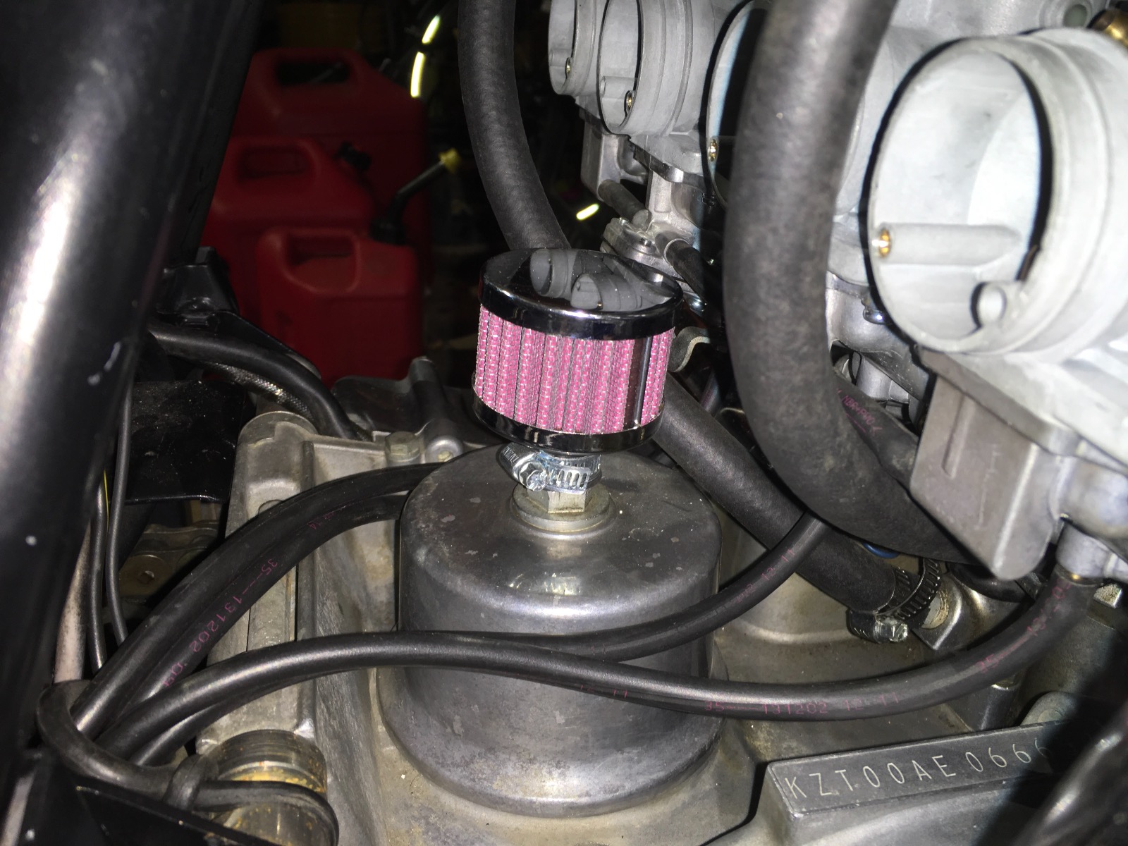

It´s the engine case vent that Need to connect to the air box to burn the oil mist. Ask Greta Thunberg for a solution!!!:laugh: :laugh: :laugh:

18 Mar 2020 05:10K&N makes a filter for that. Might have to use a short length of hose & let the filter lie to one side for it to fit under the pods.
www.z1enterprises.com/air-filter-kn-62-1...-crankcase-vent.html

Some folks just hook up a long piece of tubing and run it back along the upper frame rail to the rear of the bike with no filter.

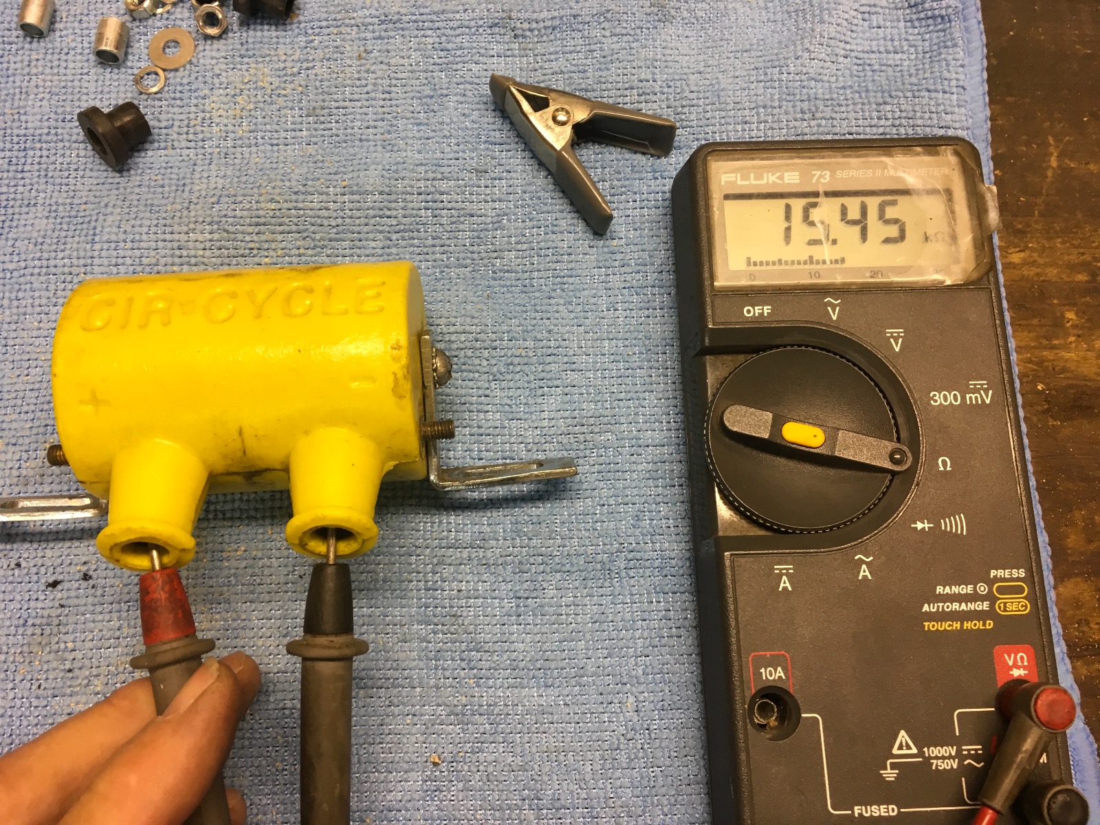

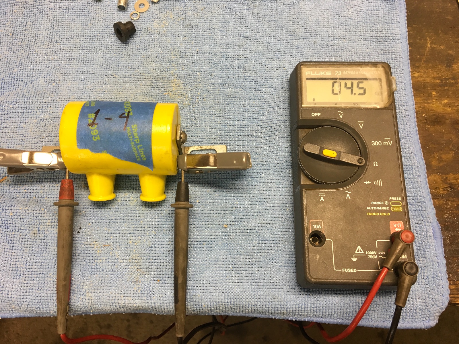

Test the primary of the coils
Then the secondary’s, meter set on OHMS
Check the FSM for acceptable values
