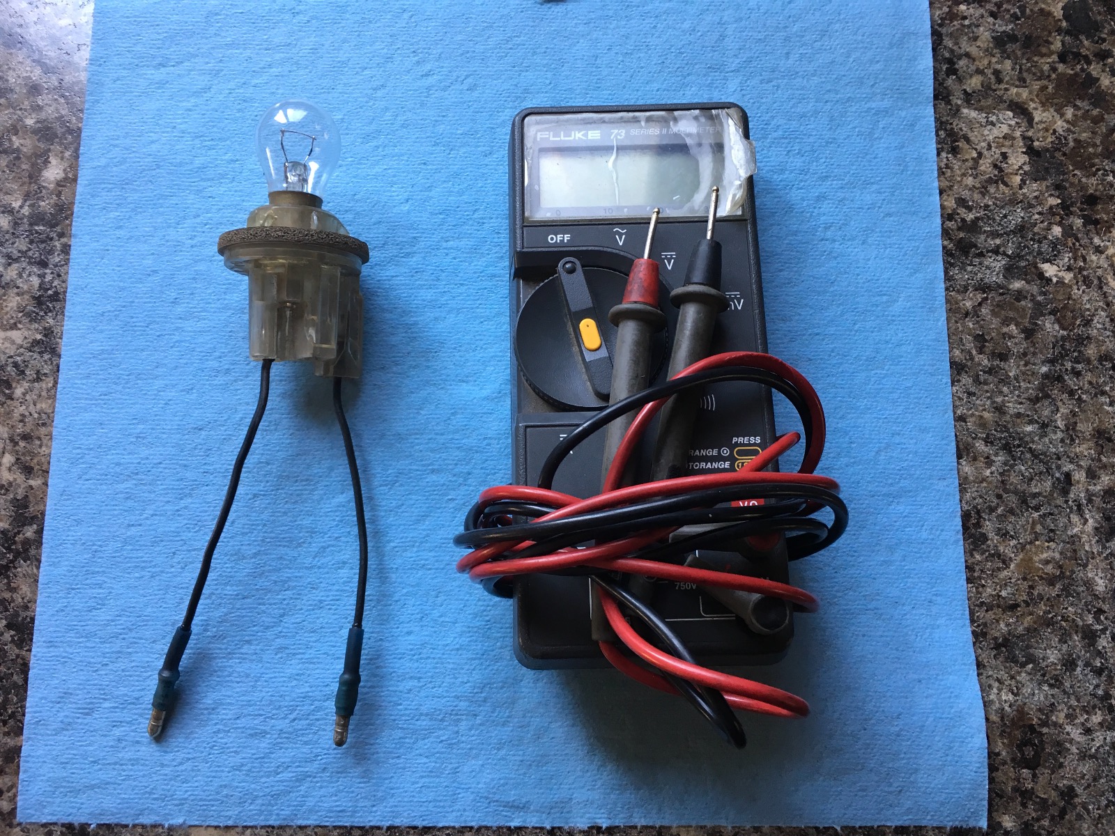

Both have their place in a shop. I put bullet connection on the test light and have different leads that I can connect I.e. alligator, ring, blade. That way I have one socket that I know is good. Just takes another variable out of testing
