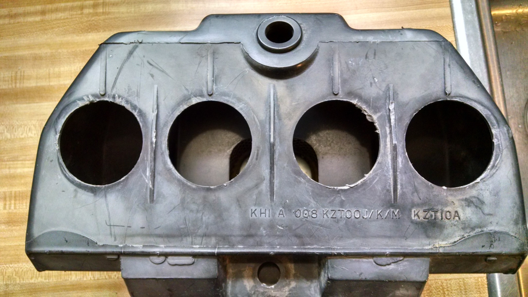

You should find an OEM air box that will fit your bike. It has a port for the crankcase breather for filtered air.
There is a rubber 90* for the breather connection at the bottom not pictured.

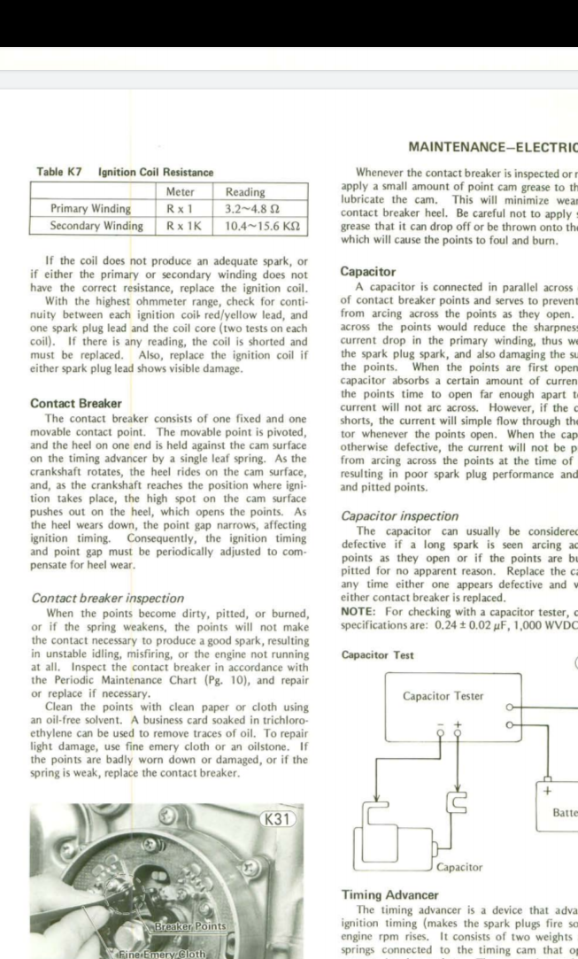

I'm halfway glad the site wasn't working for me past couple days cuz I had some trying times at the garage. I was able to get a primary reading on both coils which was 4.3/4.6 but I couldn't get a secondary reading at all. First day I was super frustrated trying to test cuz I didn't know what I was doing. Left side coil I put my meter on 200 and leads on both primary, 4.3, easy. Right side coil I was lost until I tested the yellow/green coming off the coil body, 4.6...the coils aren't the same design. Tried meter leads in both plug caps for a secondary reading and got no nothing for either coil. Switched my setting on meter and also took caps off/made sure I had fresh cut ends. I must be doing something wrong cuz I got no reading but have good spark on all 4 testing plugs against motor. On my first day all frustrated I had a random thought to touch the header and noticed 3 cyl wasn't running. Gave up pissed and went home. Had a better day next day but still couldn't get a secondary reading. Cyl 3 came back to life, my pod filter mesh was completely torn from the body and 1 other is not in the best shape either. Sprayed a bit of starter fluid in 3 it revved and gave it throttle all 4 cyl fine as of now. I notice plug 1/4 pretty black and 2/3 greyish white. I haven't cleaned carbs as I have no clue where to start for removal, still intimidating. Bike starts okay with good fuel flow to carbs, revvs like a raped ape on choke. That's where I'm at.

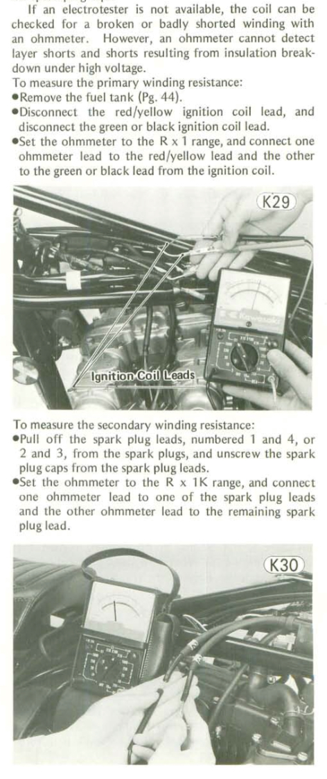

Mikaw you're still the man and your ENCOURAGING feedback is awesome. Forgot to share a couple pics. Also what am I doing wrong with the secondary reading? Isn't it just 1 lead in each plug cap per coil on 20k setting? I'm confused as the way the manual reads continuity vs. the spec k ohm reading. Happy to see the great primary reading. Again, I know the coils work, I wanna get the test right. Frame badge attached. It was 52 degrees in MT today I wanted to ride but not without a 3 carb air filter. I'll look in the manual about carb cleaning, any resources on removal of my mikunis would be great but I'll do some research.

You have a 1978 LTD1000 frame. Yes the secondary test is done by testing resistance across the two plug wires. If they are removable from the coil you get just the coils resistance. The plug wires should aslo be tested.

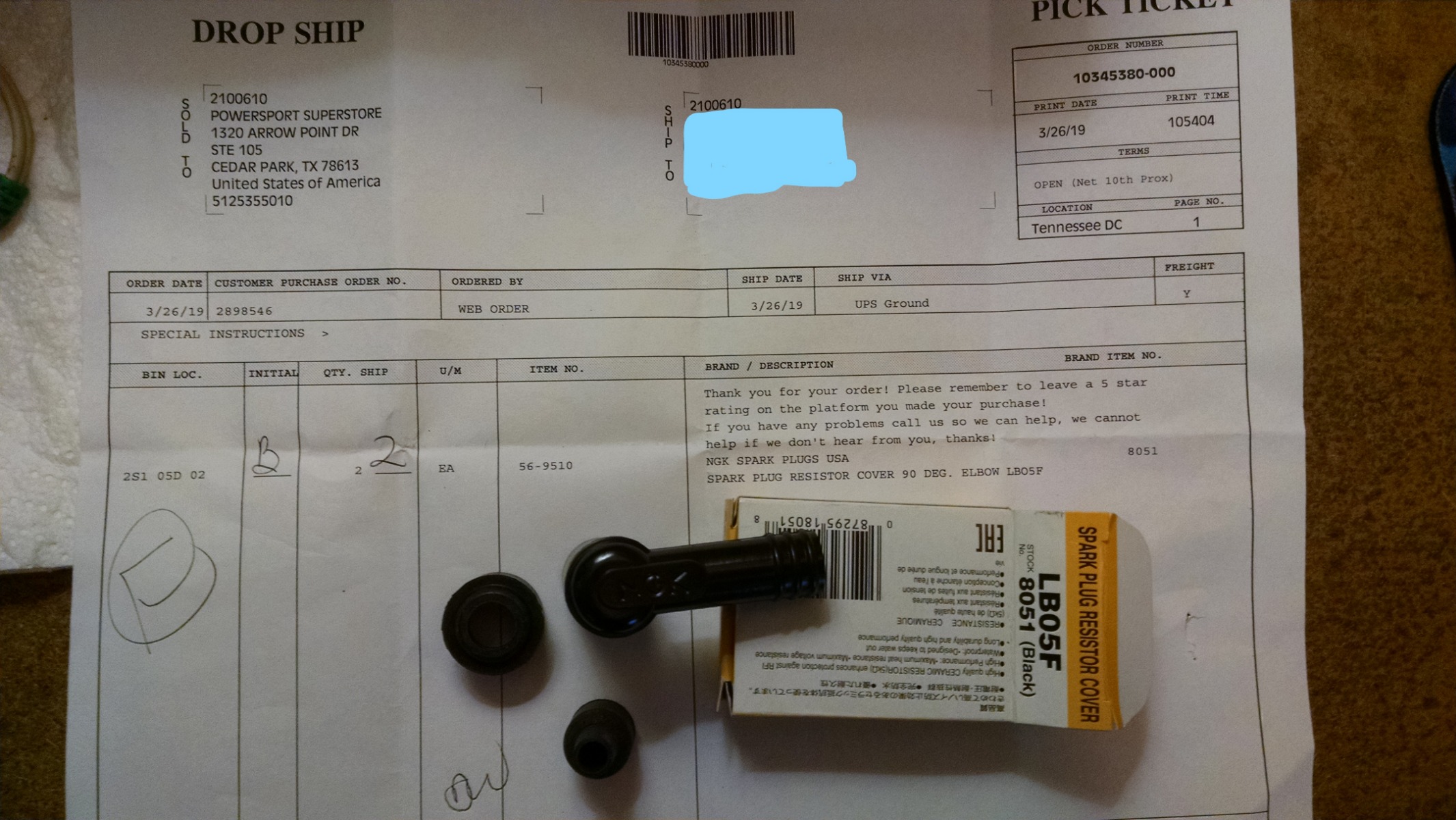

You should get 20K ohms continuity between the two plug caps.
Each cap should ohm ~5K, ( have found several of these resistor caps bad in the past).
The wires are solid copper core with -0- ohms per foot, which would leave the coils with approximately 10K ohms each.
It would be 20K total between the two plug caps and the the coil resistance combined.
The spark plugs are also supposed to be non-resistor plugs.
If the PO decided to re-engineer the ignition system it could cause the coils to fail and short / arc internally, as I pointed out previously.

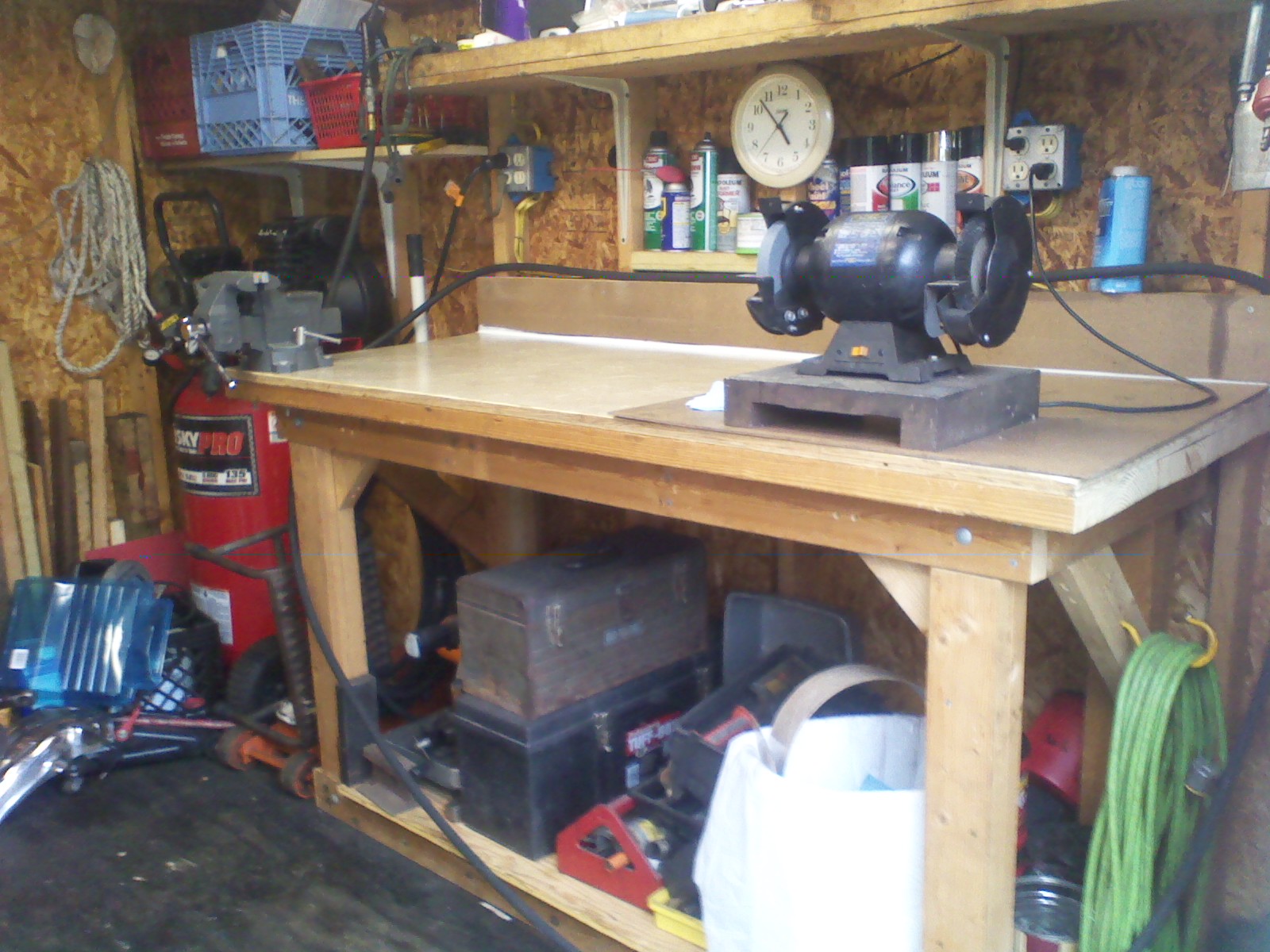

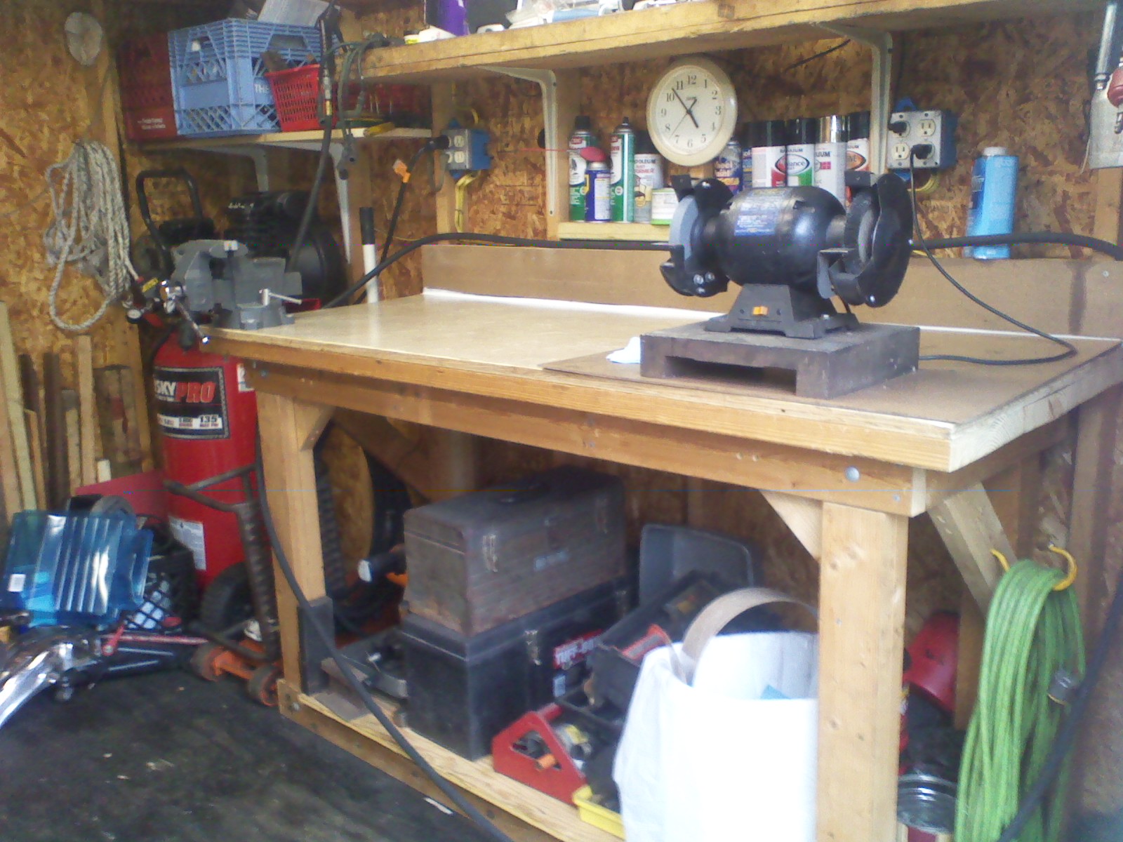

You wouldn't have like being born in my generation. We had to go to libraries, buy service manuals mail order, and had to actually take out loans and attend a trade school to learn. After graduation we had student loans to repay. Printed service manuals, magazine subscriptions and catalogs were the only other sources of info on the "latest' stuff. None of this point and click, YouTube crap! nope.. Researching anything was actually WORK.
Well, if you have flimsy meter leads, you aren't checking anything very good. If the leads are frayed and broken.. may be the FIRST place to start. HF has a half way decent test light for unter 5 bucks. Other than resistance testing, a test light helps immensely. I use mine frequently. I have one in my truck too so that I can check for power on my truck if it screws up. (very seldom does it let me down, starts every time) Good troubleshooting skills / habbits is not a one time thing, it is a way of life and transfers onto everything you do.
I have had several Kz1000's,, and I have rescued and sold many other bikes in the past. It takes years in some cases to get your bike to the point my "keeper" is in. I totally disassembled this bike, cleaned up every freakin part, then reassembled it piece by piece. In the mean time I still had my other Kz1000M1, so I got my 100 hp therapy from that, while building this bike. Take your time, and restore it to stock is my recommendation if you want a fast and >dependable< Kz1000. Those smart jap engineers are a tough act to follow. It's tough doing anything offsite. There are some guys on here that have done some awesome restorations in a second floor apartment. I bet management loved the paint work and the greasy stuff. Dishwashers work great to clean some things. I use mineral spirits and a part brush, then hose things off with a garden hose, and finally, blow dry with compressed air.
10' X 10' shed workshop.
BTW, instead of wasting more money on new pods, have you even considered looking for a OEM air box to fit that bike? There are reasons the air box was used. HS speed air flow being one of them. Some people leave them off, because they aren't smart enough to put a simple fkin air box back on. There is no performance improvement to be gained using those funky pods, and the air turbulence in the outside carbs screws up the fuel mixtures at speed.
