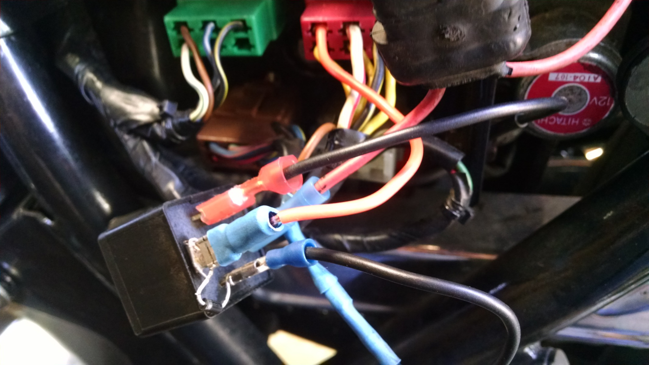

I woudn't sweat the coil voltage too much. The kill switch is fed from the brown ignition wire that also feeds the voltage regulator. My bike was overcharging because the brown wire was feeding the regulator low voltage, so it was compensating for it by overcharging the battery. I added the relay there,to feed full battery voltage to the regulator and curb the overcharging. Like I said, my bike is an animal. No sputtering or spitting. Ever. People start having ignitions problems when they use the wrong parts, resistor plugs,resistor wires, etc..

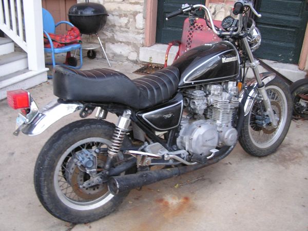

This M1 sat in the same place in south STL behind an old row house that I had to take the calipers off to move it. (brakes were stuck) Notice the rust stains under it on the concrete. And yet ANOTHER one with a title that was filled out but never transferred.. and EVEN a Kansas Bank lien release that had to be dealt with in the titling process.. It had an expired Kansas plate that this sly fukr had bent over so that the overworked STL police couldn't tell it expired 8 year prior. Another nut and bolt rescue. Ran like a striped ass ape the day I sold it.
Note the air box. There is a reason I put those back on.
