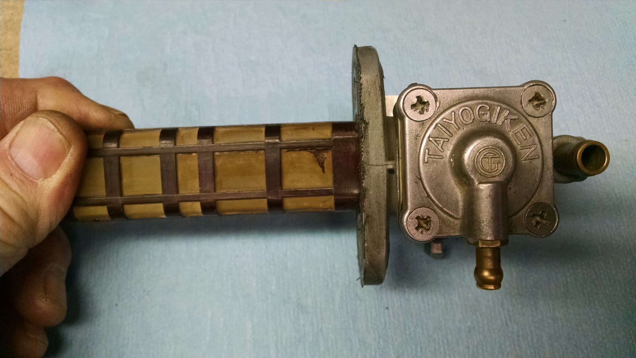

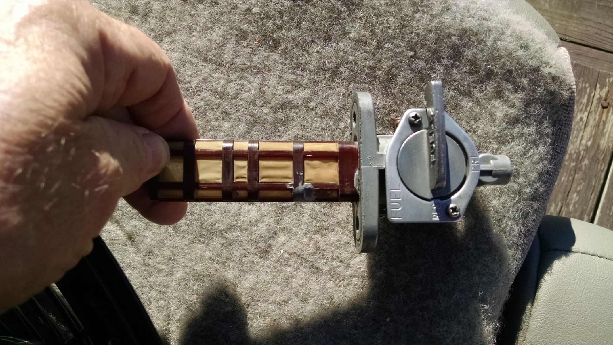

Your petcock isn't a vacuum operated type, so if leaving the gas on, it is probably flooding the engine overnight. My bike has fuel all over the place if I leave it in the prime position. The vac valve works great, when it works.

Ironic you mentioned leaving your petcock on. I did exactly that last night and went I went back today I notice some gas on the floor left side, obvs the way it leans and figured hey, probably flooded let's see...started 1 kick. So, if I shut the gas off at night and go back, no love from kicker but if I leave it on and it leaks, super easy 1 kick start. ?
Forum wouldn't let me post for a couple days. Got the starting with kick system dialed. Gas off at night and at restart gas on, couple twists of throttle and boom, 1 kick. Left side fuel line was too long also so the gas would just kinda sit in the line instead of downward flow. Bike is running great!

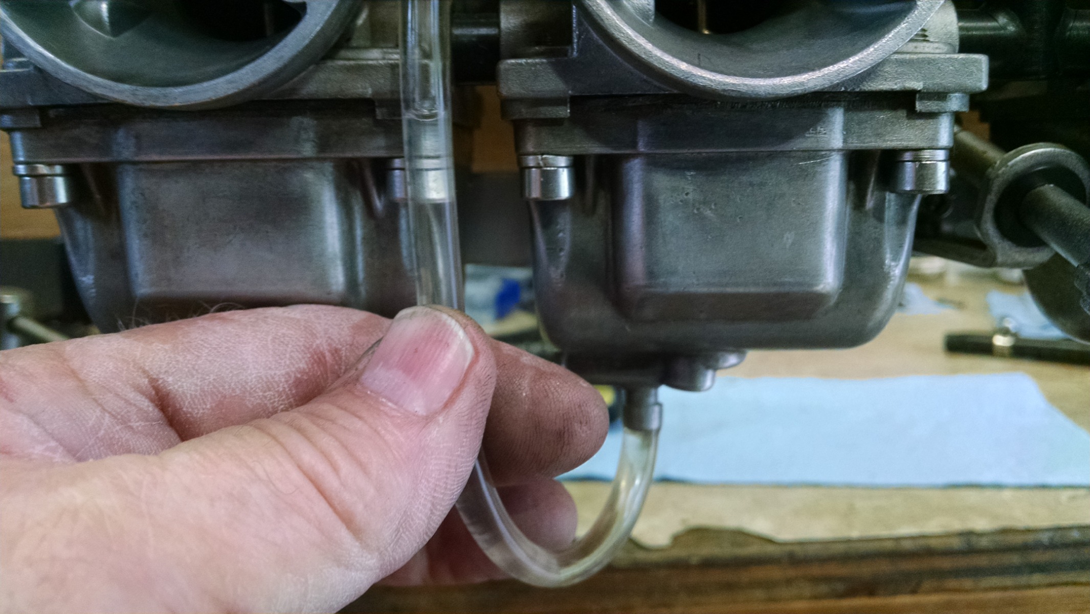

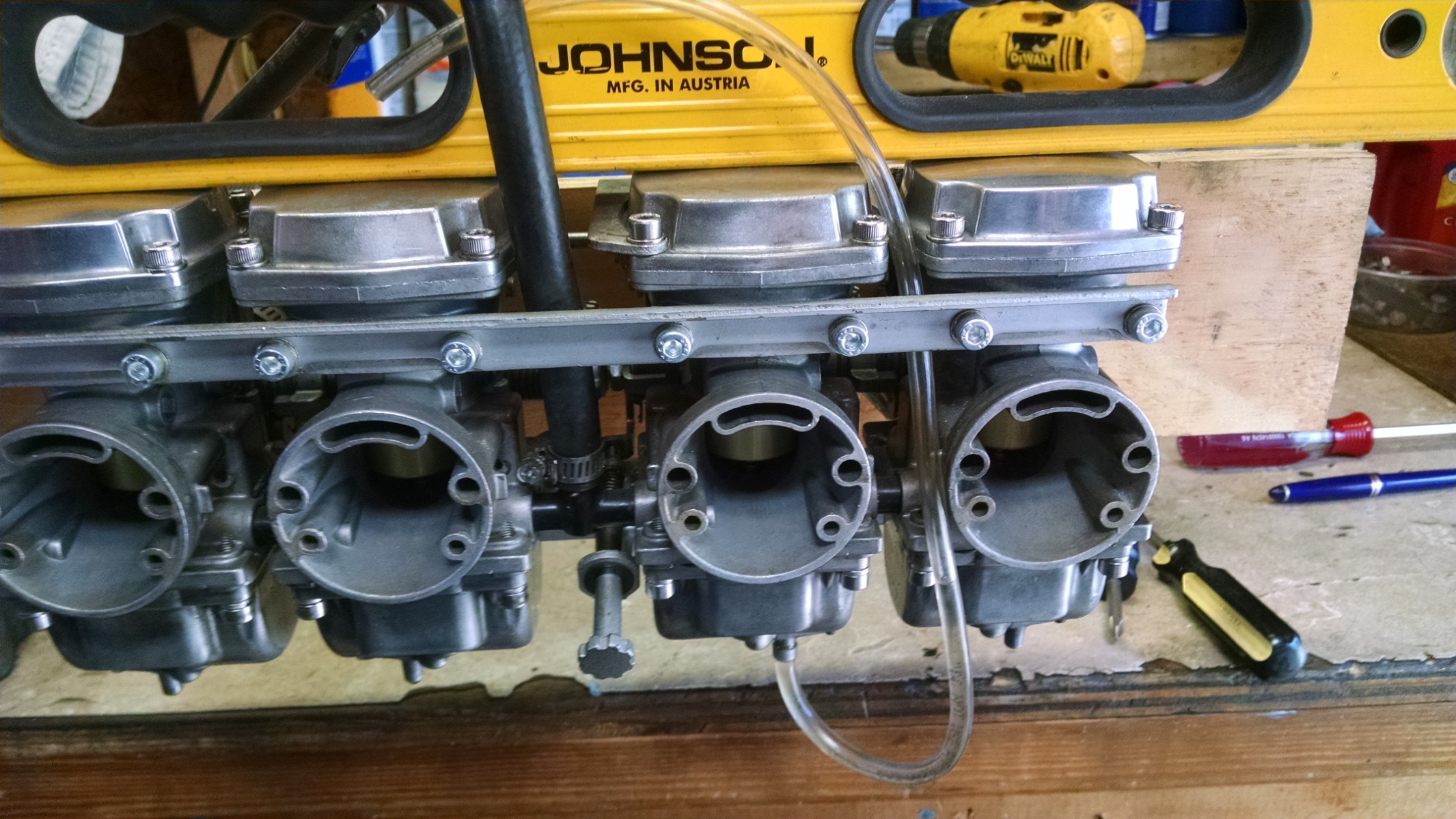

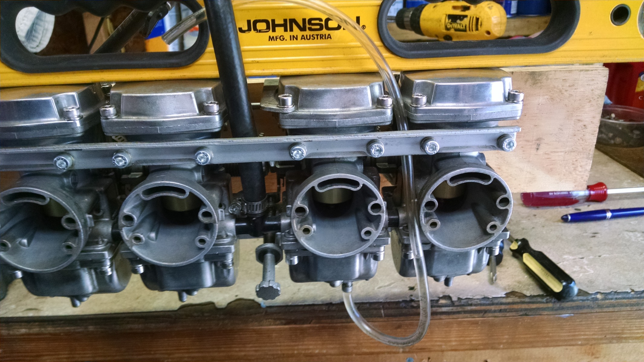

As long as the fuel in the tank is above the hoses, it doesn't matter how many loops are in the hose. Just simple physics my friend. Letting the bike lean too far can cause the floats to NOT seal off causing flooding. Prop is as close to level for several reasons, fluids tend to spill out.
It's close to impossible to get all 4 carbs not to leak.. the vacuum petcocks fixes that.
Static setting float levels:
Don't position the fuel tank too much higher than the carbs, to keep the static fuel pressure about the same as when mounted on the bike. Note that the clear tube is ~6" from the carb (looped out) If you move it in, up down, or curl it up, the fuel level will remain the same. Simple physics.

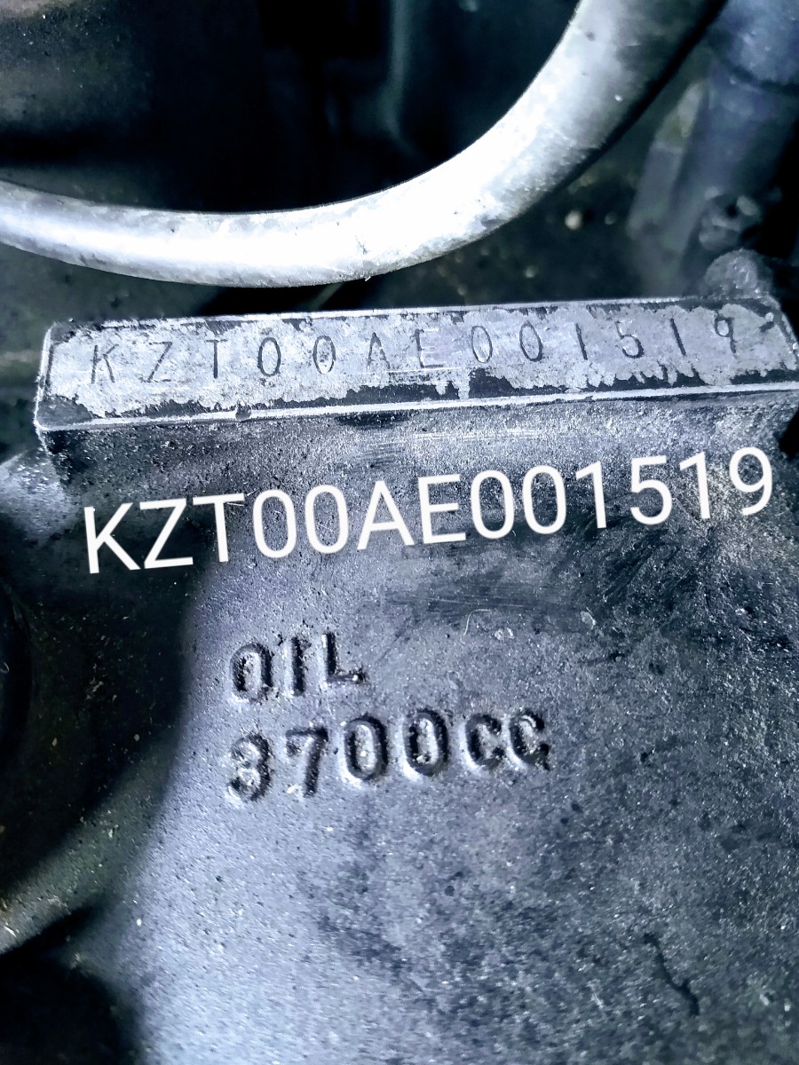

You have a 1977 Kz1000A1 engine. Look on evilbay for a factory service manual. Make sure it doesn’t say “supplement”
This might work. Maybe someone with more experience in the 1000A models can say yes or no.
kzrider.com/modules/ServiceManuals/Kawas...Service%20Manual.pdf
