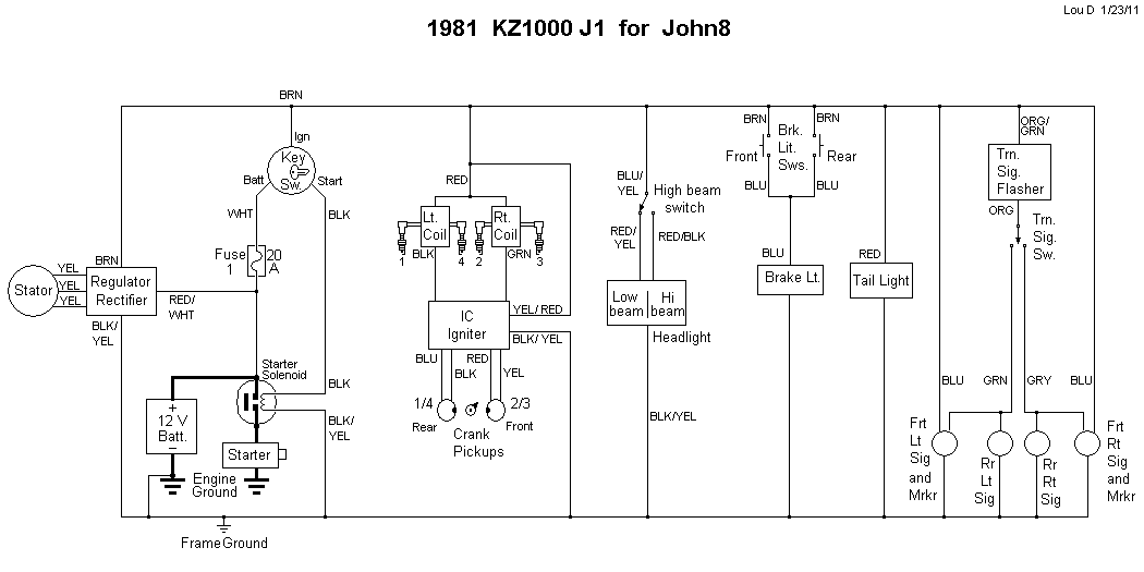

I am just not sure what wires go to what on the diagram you made for me go on the ignition I bought.Everything else is very clear.

Sorry...I meant to ask. What color wire goes to which connection on the ignition I bought. Battery, ignition, starter and acc? Thank's.

Thank you very much. I put new connectors and connected everything except for the rear brake lights. Your diagram is very easy to follow. The only problem I am having is the ignition. I cut off all the wires from the old ignition and spliced them per your diagram to the new one. I attached the white wire to the ignition, the brown to acc, the white/black to battery and yellow/red to the starter. Other than that I think it looks pretty good. I can weld but not wire. Thank's again for doing this for me. By the way, thank you for the advise on the cheap ignition. My wife says if I am good I can buy a fancy one.

john8 wrote:
john8 wrote:
john8 wrote:
john8 wrote:
The wire to the ignition is red, according to the factory diagram. This wire will go to the Ign as will the regulator sense wire as I mentioned above.
In drawing this schematic, I am assuming the configuration of the new key switch as follows:
Batt is 12v power from the main fuse.
Acc routes power from batt to accesories.
Ign routes power from batt to the ignition.
Start routes power from batt to the starter solenoid's coil.
Off position: nothing is connected.
Acc position: Acc is connected to batt.
Run position: Acc and Ign are connected to batt.
Start position: Ign and Start are connected to batt. (This position temporarily removes power from Acc.)
The white wire that originally went to the original key switch is where the key switch got its power. So, according to the diagram I'm using, the white wire from the main fuse should go to Batt on the new key switch.I attached the white wire to the ignition,
john8 wrote:
This should work ok. Brown originally powered many things including the sense line on the regulator. Since it is important for the regulator to get voltage while the bike is running, I'm altering the circuit slightly so the regulator is connected to ignition. This way, a failure on the new key switch won't melt your electrical system. The Acc position will now power the lights only.the brown to acc,
john8 wrote:
The black/white wire sent power from the ignition switch to the fuse block to power the lighting fuses. (Although, I suspect there may be some error on the factory diagram in this regard). Since there is now only one main fuse, the black/white wire is no longer used. The fuse wire goes to Batt, as mentioned above.the white/black to battery
john8 wrote:
According to the diagram, the wire to the starter solenoid coil is black. That wire will go to the Start connection. The red/yel wire is no longer used if the kill/start switch are removed.yellow/red to the starter.

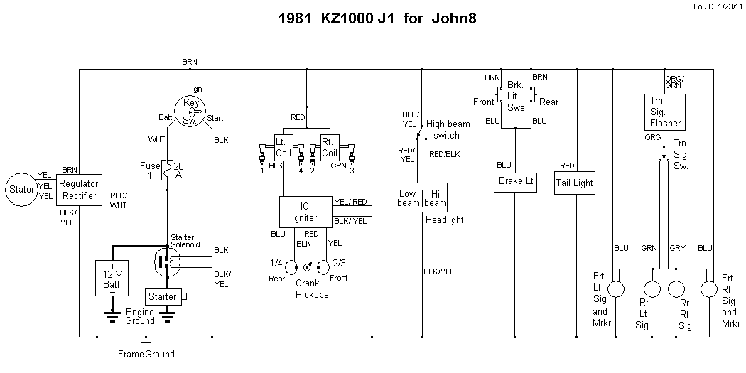

Or, to simplify it, you could just leave the Acc connection unconnected. (Make sure to cover it to prevent shorts because it will have 12v on it.) The lights will come on with the ignition (as it did from the factory).
Here is the simplified version.

If I wanted to still keep the start kill switch could I put the yellow/red to brown and red from the coils and black to the black from the starter solenoid?
