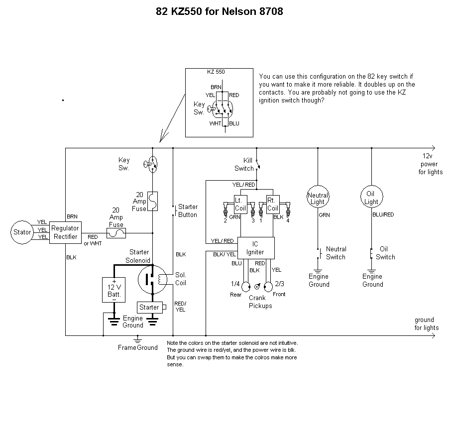

EDIT 1/9/2019:
Mattylight Barebones Bare Bones Wiring Diagram
1982 Kawasaki Kz550 for Nelson8708
Kz 550
Are you going to try a stock starter?
EDIT 1/9/2019:
Kz 550
