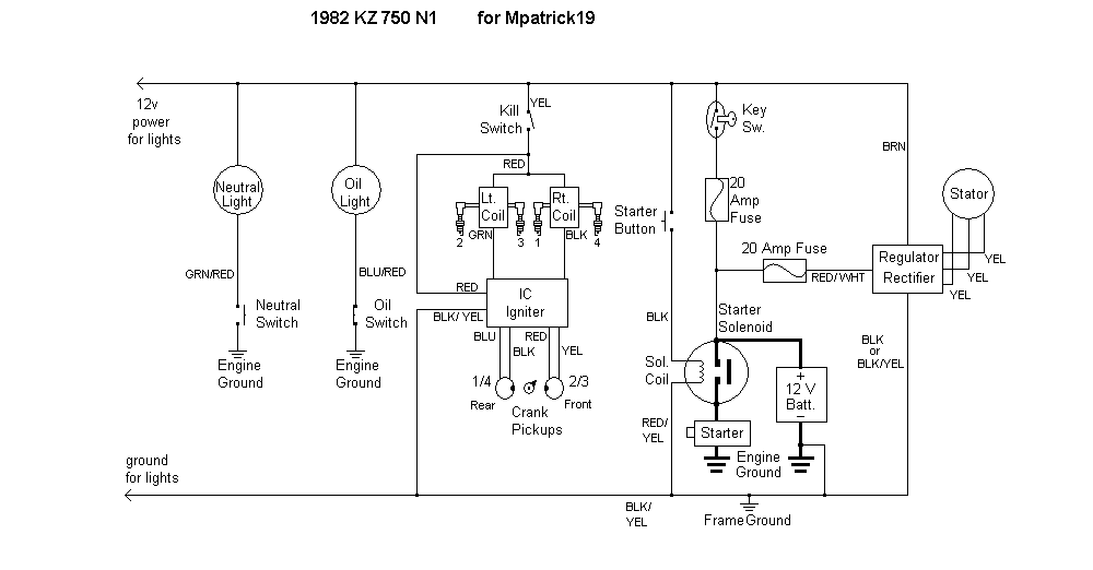

i have a stock electronic ignition, could i just use the diagram for the dyna s for reference? Its an 82 kz750 n1.

mpatrick19 wrote:
1982 KZ750 KZ750N1 bare bones for Mpatrick19
EDIT 1/9/2019:
Mattylight Barebones Bare Bones Wiring Diagram
1982 Kawasaki Kz750N1 for Mpatrick19
Kz750N Kz750 N1 Kz 750 N 750N1 750N
There are a few differences such as which coil is mounted on which side and the reg/rec is a single unit. some of the wire colors are different.i have a stock electronic ignition, could i just use the diagram for the dyna s for reference? Its an 82 kz750 n1.
EDIT 1/9/2019:

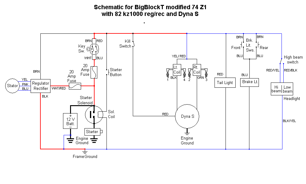

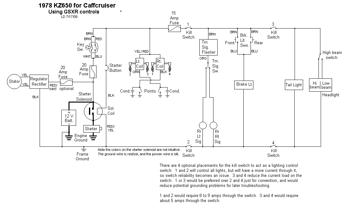

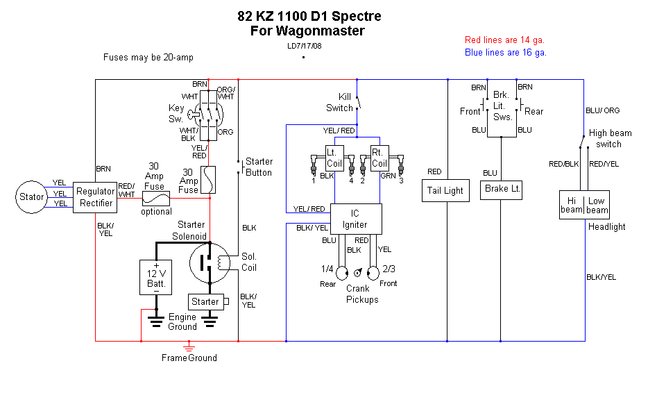

I don't know where else to put these, so I'll put them here. They were probably in other threads originally, but chronologically, they would go about here if they were in this thread.
1974 Kawasaki Z1 with Kz1000 reg/rec and Dyna S for BigBlockT
Kz900 Kz 900 Kz 1000
1978 Kawasaki Kz650 with GSXR controls for Caffcruiser
Kz 650
1982 Kawasaki Kz1100D1 Spectre for Wagonmaster
Kz1100D Kz1100 D1 Kz 1100 D 1100D1 1100D
Kz 650
