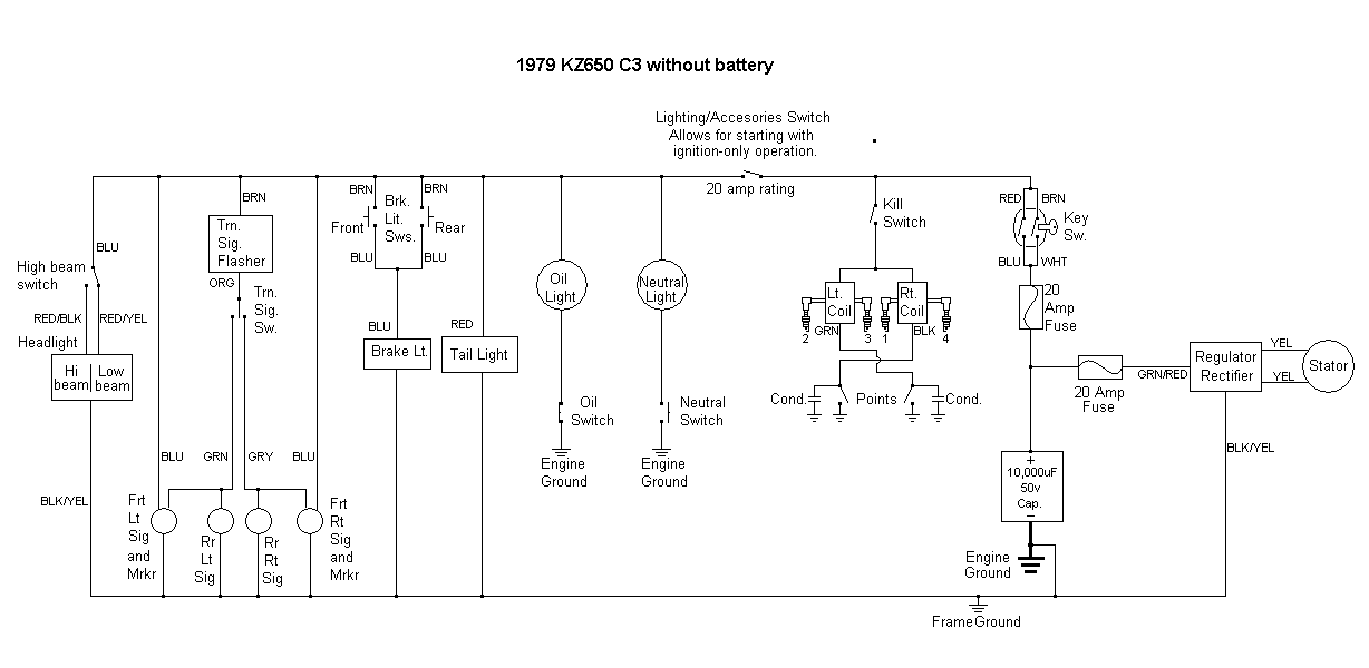

There are many differences in the 1977 kz650 C model from the 750 and 550. Mostly charging system differences. Luckily, I have a bare-bones diagram for that bike as well, but I need to know if you will keep the starter or go kick-only. Unfortunately, the 77 650's must retain a battery, even if going kick-only.

I appreciate your offer to help, but I need to clarify that I have a 79 650 C, not a 77. I don't know what difference if any this makes but I thought I had better clarify. Also, a little background information might be useful. I am having a charging issue and the bike will kick over just fine for the first several days after I remove the battery and charge it on an external charger, but sooner or later the battery gets drained down to the point that even the kick start won't turn her over. If the 79 is different than the 77 and I can get away with changing a few things around and eliminating the battery, that would be great and I will ditch the starter and just go kick-only. If I have to keep the battery in the loop though, then I may as well keep the starter in place. Also, I know that this is a "bare-bones" thread, but I'm really not looking to get rid of anything (other than the battery, if possible) rather I am flirting with the idea of trashing the rat's nest of wires that I have and starting from scratch. Has anyone pulled off a 79 650 C with no battery? If so, is ther a wiring diagram out there that I could follow? I'd appreciate any help you can give me.

Sorry, I don't know what I looked at that made me think you had a 77.
The 79 650 is definitely a candidate for going battery-less, but I haven't actually done it on the that bike. The charging system is similar to the late 1970's KZ 400's, and I know they can go batteryless.
The most important thing is that the bike must be well tuned, and beable to start reliably on the first or second kick. Going batteryless will only make a hard starting bike harder to start.
All you need to do is setup a switch to kill all of the accesories and lights other than the ignition and regulator/rectifier. That way, all of the electrical energy from the kick will go into the ignition.
You need a capacitor wired in place of the battery. It should be from about 5000uF to 12000uF, and be about 50v.
If you want a simplified diagram retaining most of the stock components, I can draw that too.

Thank you so much for your help loudhvx. You seem to be one of the bike gurus that make this awesome site such a crucial resource for us guys that are just starting out. I would love to take you up on your offer to draft up a diagram showing the stock components and where I could put in the switch and capacitor to go battery-less. Also, I needed to know what kind of switch to use. Any suggestions?

Well, if you're going to keep the bike close to stock electrically (except battery and starter), I'm not sure if it's worth the effort just to fix a charging problem. I have started on a diagram, I'll see if it will post.
It would be a lot of work to re-do the whole thing. We should get the charging system fixed first anyway just to know what the problem is.
