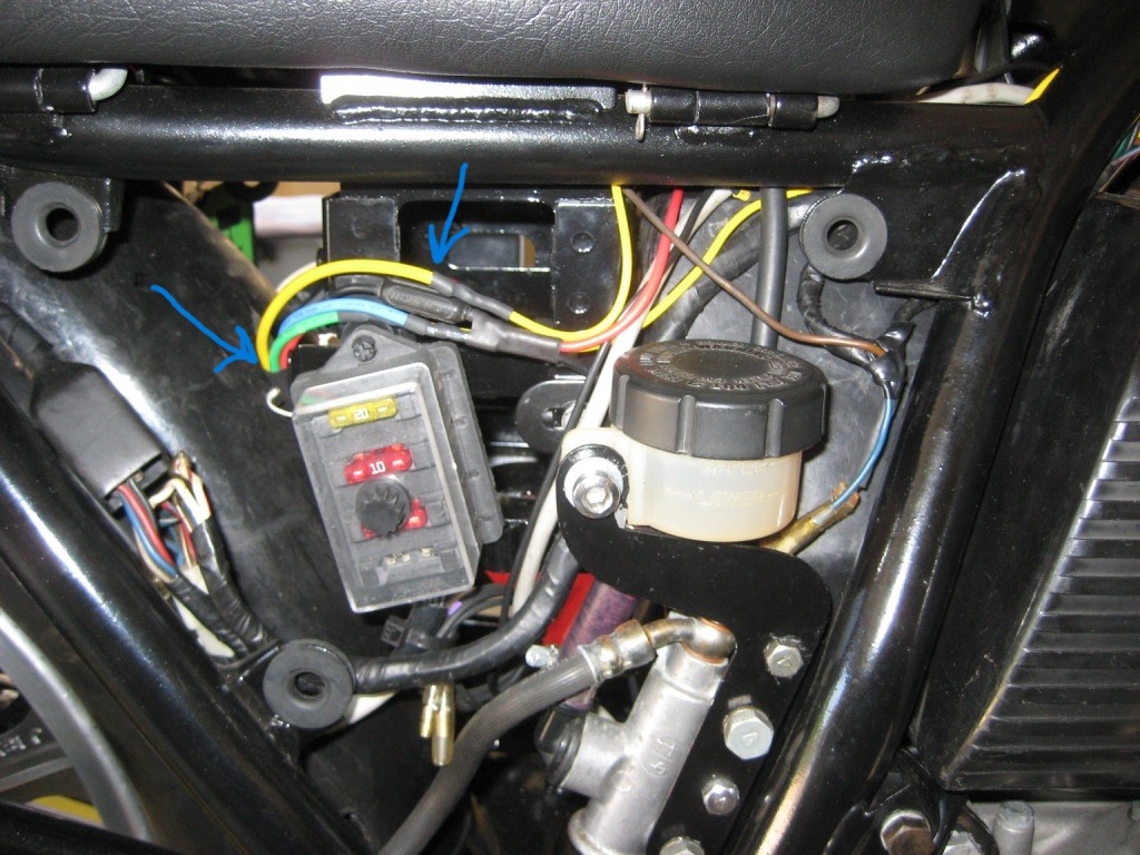

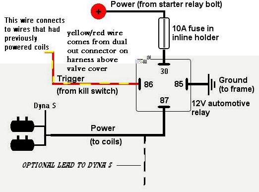

20 Jul 2025 18:32 - 20 Jul 2025 18:48www.kzrider.com/forum/4-electrical/297304-wired-george-coil-modWhat coils mod are you using?
kzrider.com/forum/4-electrical/231761-wg...-is-it-to-accomplish
Get a multi meter and check your power output at the coils first.
I have one on my bike that has a original wire harness on it. Its just a splice in and a relay that fits under the side cover, took mine from 10V to 12V.
Are you up in Quebec? I am in Ontario.
1978 KZ650B2 modified project
1981 Z50R Honda tow bike
Last edit: 20 Jul 2025 18:48 by Injected. Reason: pic
The following user(s) said Thank You: Gdizard, Wookie58

21 Jul 2025 05:28 - 21 Jul 2025 05:31With the ignition on without the the engine running.Yes im in quebec!! So I need to start the bike and test one of the 2 wires that coming to the coils ?
The coils each have two wires.
One is the live feed the other is the trigger to "fire" the coil.
Find the live feed and measure the voltage the coil is receiving from the battery via all the loom, kill switch etc.
Multimeter to volts, red to live coil feed, black to battery negative.
Ideally it should read the same as if you were reading the battery voltage across the battery terminals. However after 40 odd years of old wiring loom, corroded switch terminals etc it'll likely be a fair bit lower.
The coil relay mod allows full battery voltage to feed the coils but still maintains it being switchable with the ignition key.
Try not to leave the ignition on for more than a few minutes without the engine running or the coils can overload and burn out.
