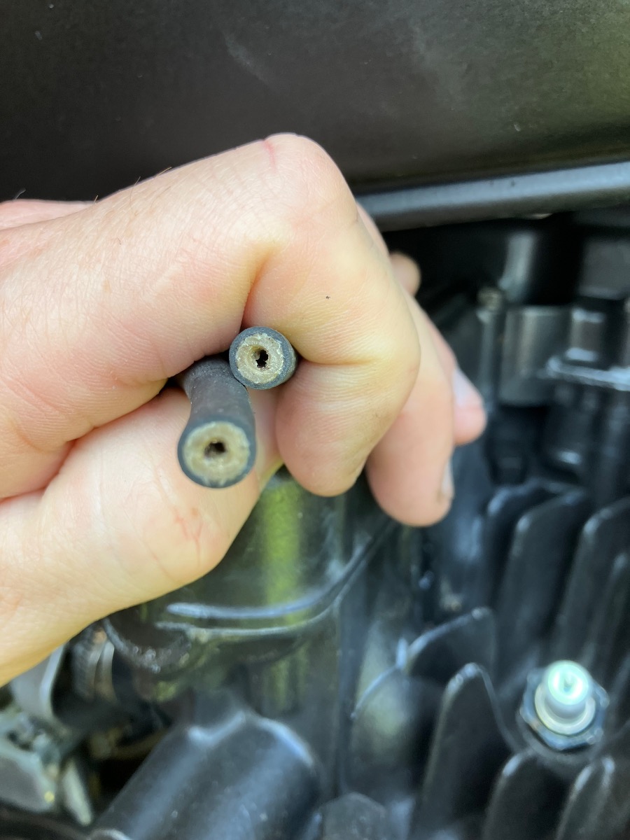

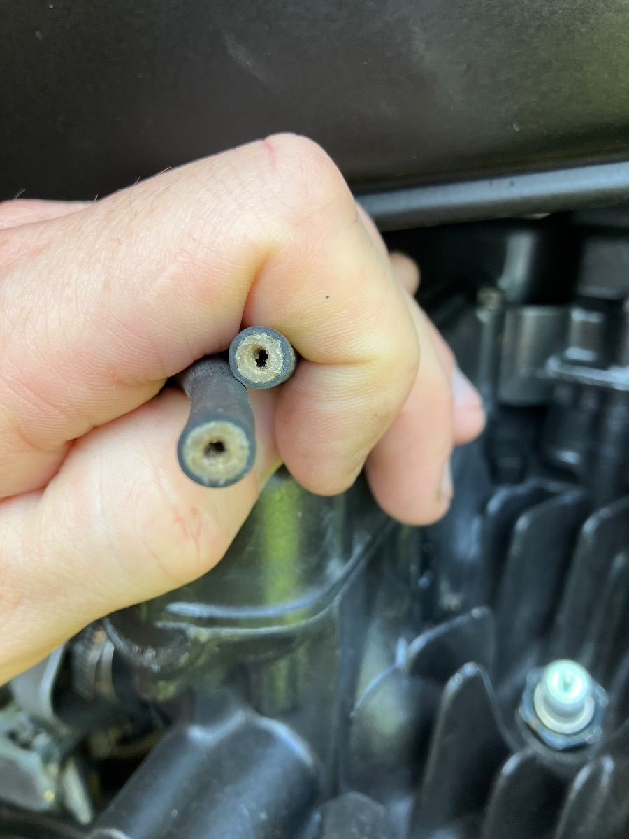

Remove the spark plug caps on the center cylinders, and measure resistance. They unscrew from the wires. Should be something in the range of 5000 ohms. Inspect the spark plug leads, and snip off about 5mm off the end, before screwing the caps back on. If the cap shows high resistance, you can use a flat blade screwdriver, and open up the cap, for checking the resistor inside.
- Maxbou92
- Posts: 301
- Thanks: 14
Re: New plunger black plugs
22 Jul 2025 08:40
4600-4700 ohms on each one!! But I cant see clearly wires inside .. do I need to remove some rubber to see some wires?!

As Nessism said, snip off a finger width from the coil end of the wire, thus allowing for fresh new snug contact, over time the connection will get molded to that form inside the wire, then road/engine vibrations loosens that molded form just a smidge, causing an intermittent connection issue. Put a small dab of dielectric grease on the end before screwing back into coil.

Thank you!! Its done. Plugs are still black a bit, but the bike runs great
