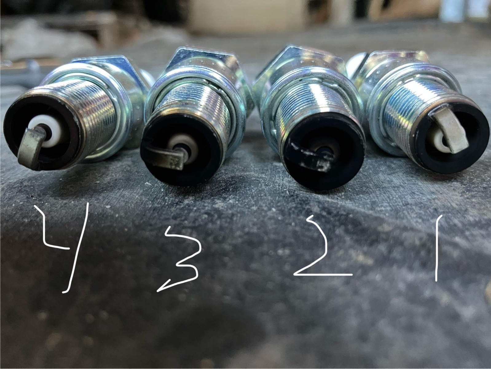

New plunger black plugs

I have 12.54 battery and 11.93v at coils. Each one is 11.93

If you have full voltage to the coils then the black plugs are a over fuel situation.
Your jetting looks to be good at #15 pilot and #105 main (typical pipe and pods 650/750 jetting) so its not rich there. Float level is correct is not rich there.
Put the needles at #3 clip as per Zed1015's suggestion, then adjust air screws.
I would set the air screws as lean as you can (2.5 turns) a Color Tune kit would come in handy at that point. I have never seen a 650/750 that needs a #12.5 pilot jet.
You could try running a B7ES plug to see if that makes any difference.

Just an observation but you seem to be hanging everything on the AFR readings from the dyno print out - It would be interesting to see those readings at a "constant" 3k,4k,5k etc. The graph shows "lean" 3500 -4500 and a little "rich" 6000 - 7000 - however if the guy is "snapping" the throttle open at 3500 a momentary "lean" condition is normal as the jets need to catch up with the sudden increase in "air flow" (hence why some carbs have accelerator pumps to fill the hole) - just my opinion

I Will try it this afternoon . Cylinder one 1 1/34 turns out, 2-3 cylinders 2 1/4 turns and last one at 1 1/2 turns out!! I appreciate it guys, youre awesome

Have you still got the staggered jetting installed ?

Yes, Ive only play with air screws !!

22 Jul 2025 00:52You need all the jets the same .Yes, Ive only play with air screws !!
There's no point messing with the air screw settings or anything else if they are different.

Yess, hope it won’t be too lean with 102.5

22 Jul 2025 03:131 and 4 aren't too lean on 102.5 so why should 2 and 3 ..Yess, hope it won’t be too lean with 102.5

I was thinking about air fuel curve!! Thank you so much
