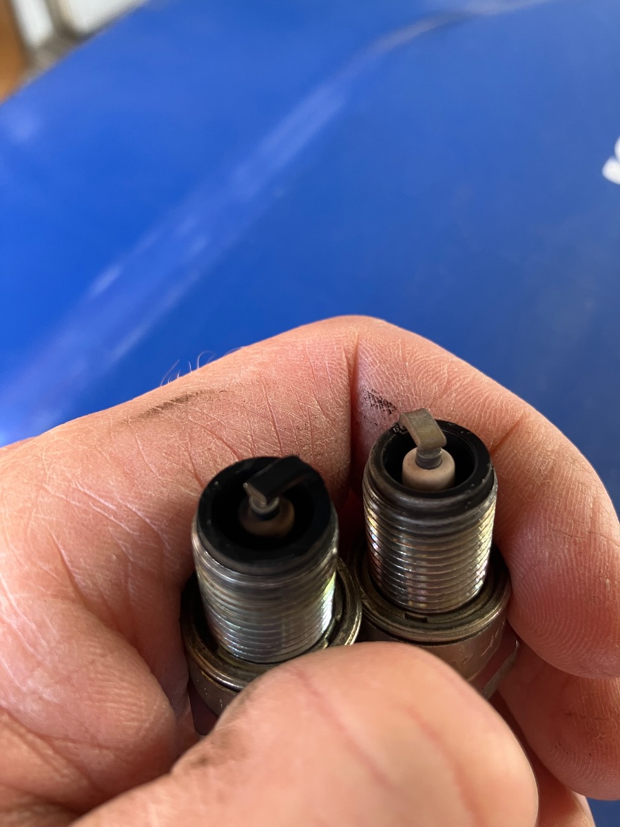

Hello everyone, I tried my bike with new plugs(b8es), new plunger, carb freshly Synchronized and I stil have 3 black plugs (1-2-3) the last cylinder(4) is almost perfect. Some bug like before in 3-4000 rpm!!?? I tried to put the air screw on my Vm28ss at 2 turn for the 1-2-3 cylinders and the other one is still 1 1/2 turn out !! What do you think ?

Float level all set at 3mm with clear tube. And they are black sooty. Bike is surging 3-4000rpm the left one is one of the three that are black like that!! The screw on the Pod filter side, is it a Air screw right? More turns out; more air?

That looks dry sooty which means those three are running far too rich.

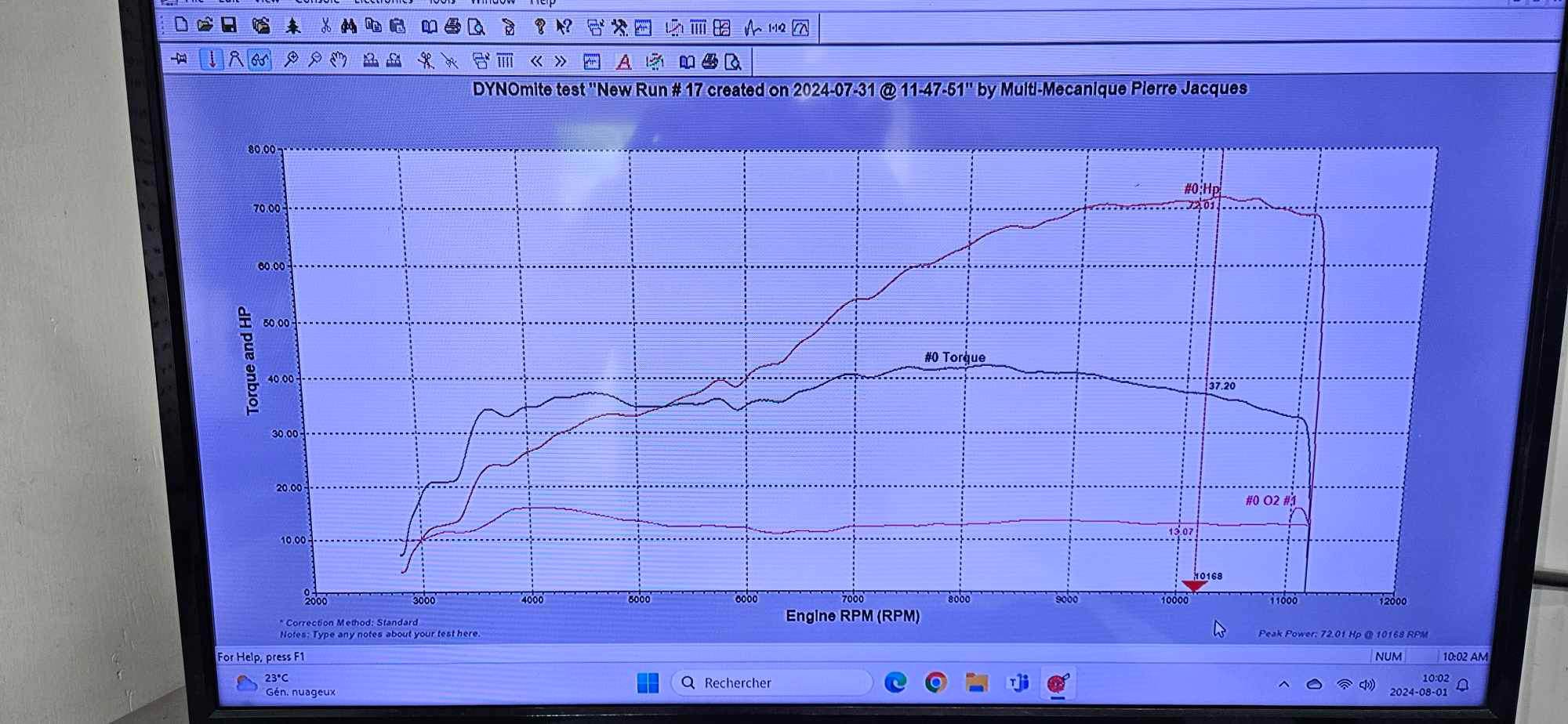

The jets are mikuni one, new engine 150psi on all 4, new plungers, 3mm fuel level all set, valves clearance, carb are set mechanically with 1/8 drill bit.. needles are one notch down I guess (dyno guy has play with it!)

I'd start with checking what the dyno guy has said.
Needles, assuming they are stock should be 4th slot from the top.
I.E. second up from the bottom.

I haven’t checked the voltage(oem coils), the wire are 7mm with no resistcap (ngk) . The dyno guy says thats nothing to do.. I run b8es

Needle clip slot position has everything to do with how the mid range fuel supply is delivered!
Take what you want from what he says but I've over 50 years experience with these carbs.
Dyno testing and tuning is about setting the whole package to perform at its optimum which begs the question why did he give back set up so wrong? Give back to him to sort.

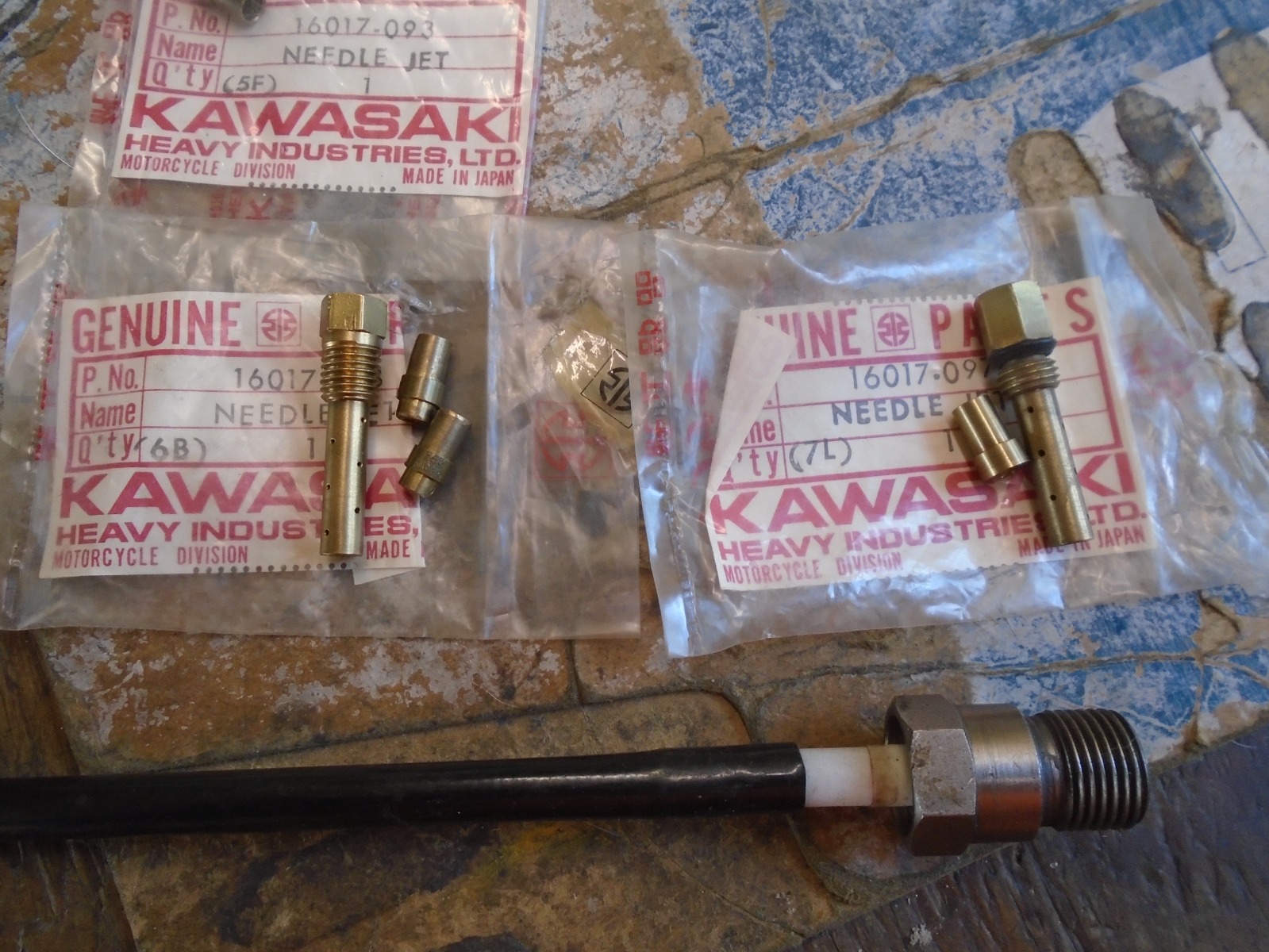

Perhaps helpful? What version of the VM26SS's do you have? If you have the 76 KZ900 1200's they had unique needle jets and jet holders. Photo shows to the left the correct components for the 76. The 1977 KZ1000 had a different combination. KZ900 had a 243 series O-6 and KZ1000 Had a 258 series O-6. KZ900 had NO oring on jet holder, KZ1000 did. Don't know if you'd cobbled-up bits to make a set or not?? And a handy tool that fancy AF Dyno won't tell you is each individual cylinders A/F at the sweet spot your lacking in real time per cylinder, not as a whole which adds to the confusion.
