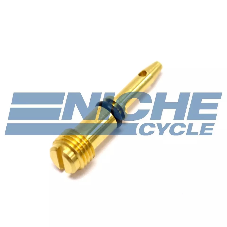

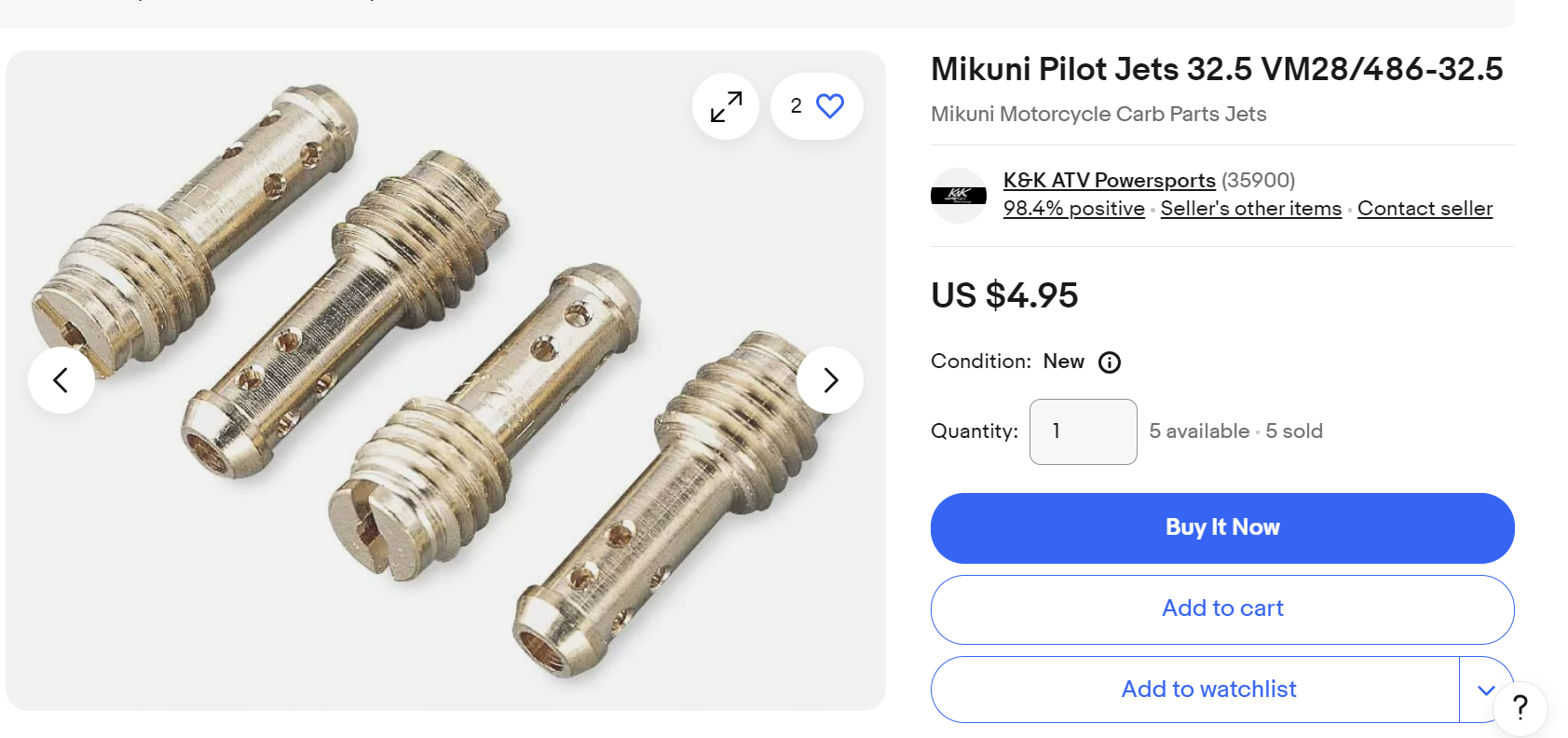

I order only genuine Mikuni jets on eBay or jetsRus.com. Are you sure you're not fighting that hole in the air screw?
BTW EBC and other aftermarket jets are drilled differently. I tried EBC and the bike fell on it's face while trying to dial in jetting.
Use only Mikuni for this reason.
