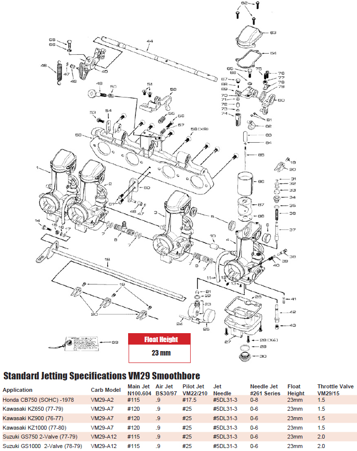

There's no listing for the Honda DOHC. What slides do you have. 1.5 or 2.0? The air screw adjustment isn't like the other VM's. Could contact Mike for details on your model.

16 Sep 2024 21:30Same with my 33's. Do they have a hole in the center if so the turns are 1/4- 1/2 turn. Miller soldered them shut and tapered the screws to act more like other VM air screws. I bought new ones and they work well. I wouldn't go more than 1 full turn. That would be way too rich. I'm running 17.5 pilot jets 1.0 air corrector jets and 125 main jets. It was still a little rich in the mid range so I opened two more holes the moron drilled in them. They were all over the emulsion tubes and that got me in the ball park when I first got them. I kept the stock holes and the two more helped. I'm now going to drop the needles one more notch. PO's suck.It has 1.5 slides. All the specs are the same for the sohc

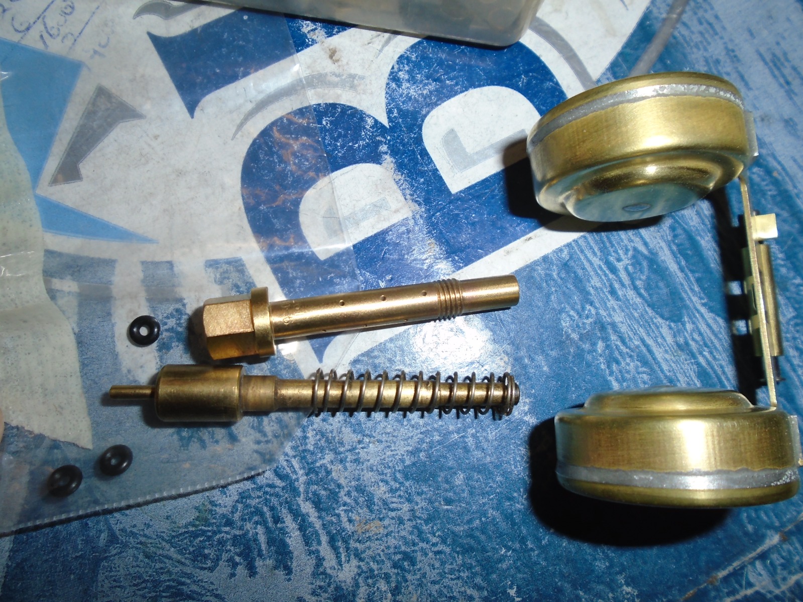

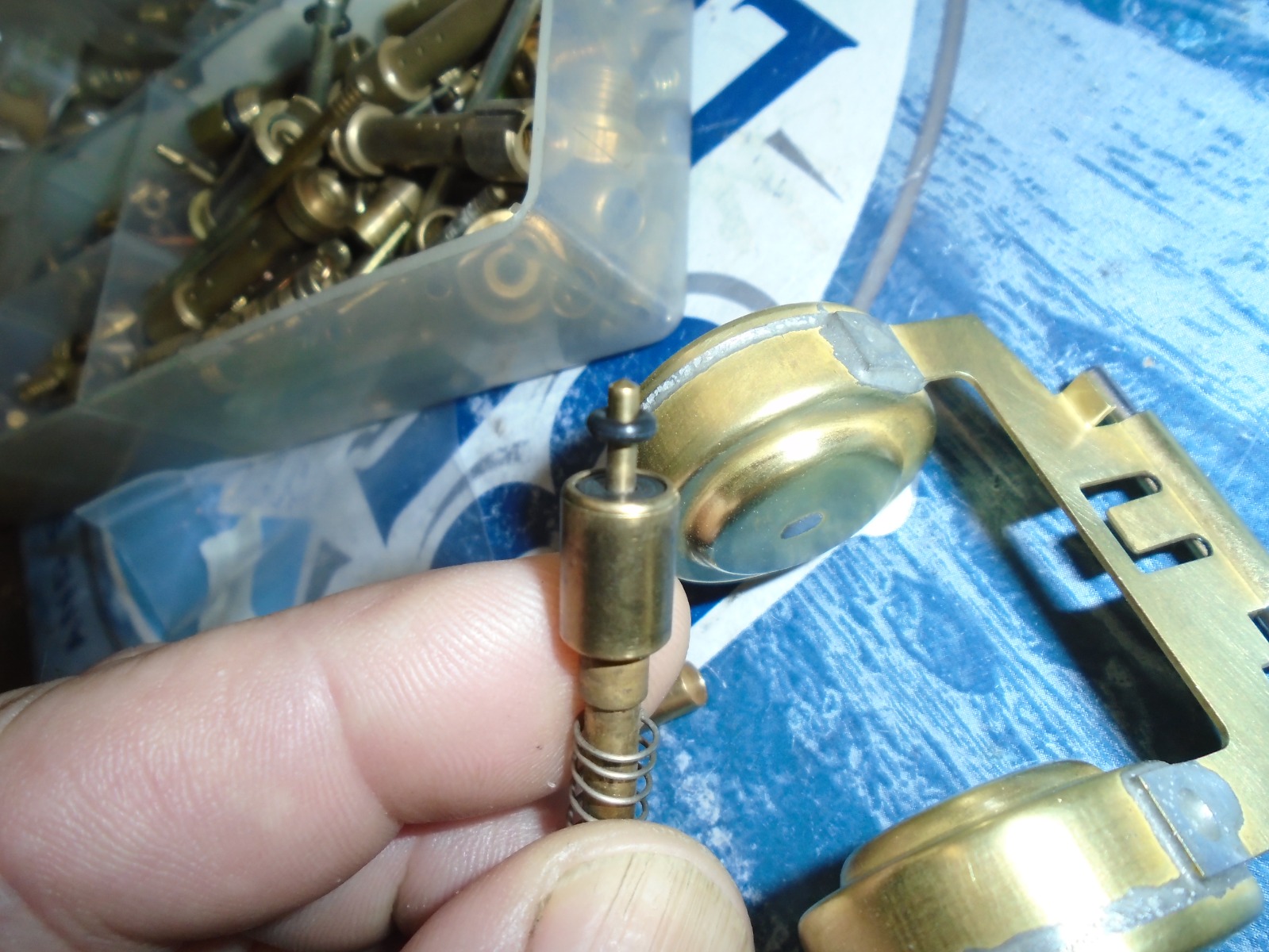

By chance do You have access to a Color Tune or know what that is? If you suspect the choke plungers, try sliding a 1.5mmID x 4,5mmOD x 1.5mm CS oring over the tip of each plunger seating it on existing flat pad. I know i'll get spanked for bringing up such a thing here probably but it works remarkably well. Gives the casting to plunger new life, you want that "port" closed or you're wasting your time tinkering with all the other stuff. Yes those "Air" screws are hollow and unlike the other VM's but Keihin has been using the same thing for years in their slide carbs. Did you verify all the brass floats are pin-hole free? That thin little jet/slide block gasket can be a pain to install and "new" ones available seem to be smaller in diameter then the originals. I always use an appropriate sized twist bit thru the pilot hole on jet block thru gasket into casting to correctly index alignment. Then install the singular M4 screw lightly then emulsion/jet holder. Be SUPER careful not to over-tighten the jet holder into block!! Although you had not mentioned it, check your valve clearance. Couldn't count how many of these 750/900/1100 and CBX's i've done that persons neglected to check valve clearance! They all use the same
25mm shim.

Hi for your info i am running VM 29 on my Z 1015CC with 117,5 mains, 20 pilots, needle mid position, air jet .9, air screw 1/4 turns out. Big big improvement were the new viton choke plunjers. Now sparkplugs are Coffee Brown, bike pules and rides very good
