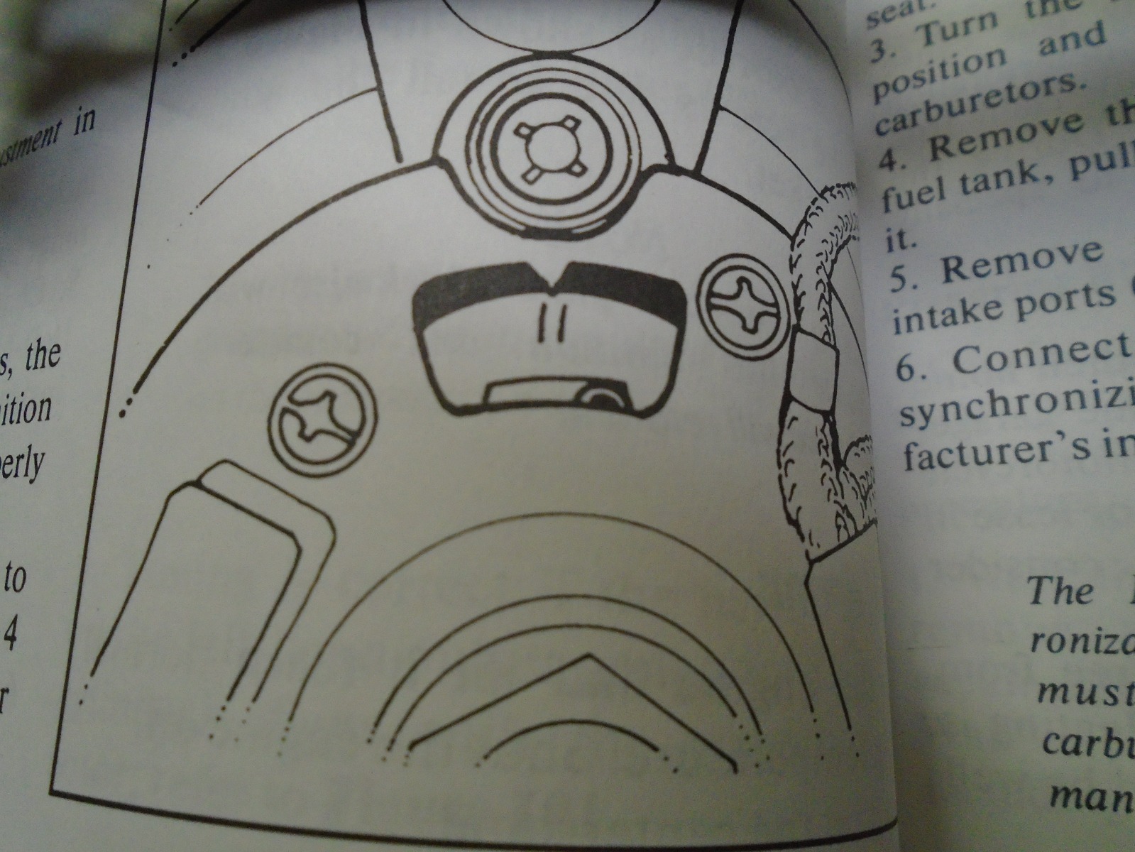

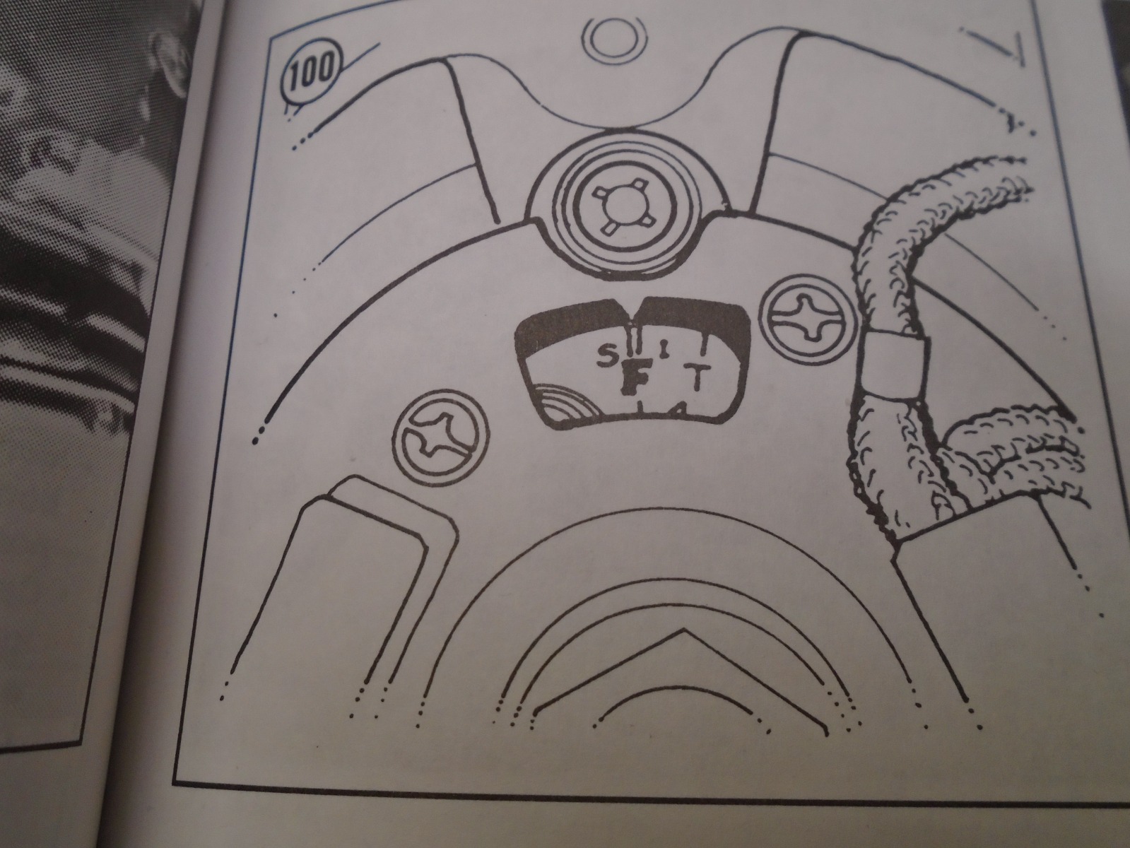

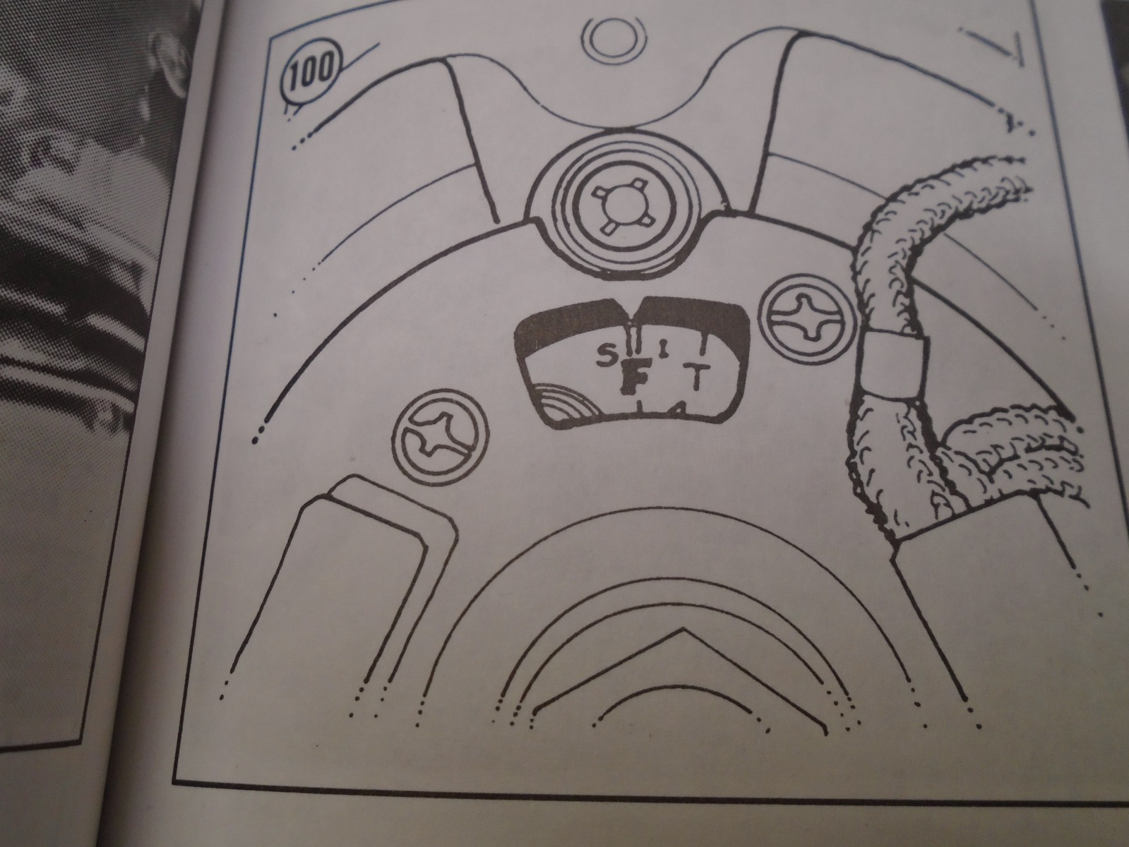

More stuff. If those slides "are" sticking it'll create some weird running for sure. Generally reassembly of the slide block requires the chrome slide installed before tightening the little screw and emulsion tube. This way alignment can be verifying, smooth action of slide thru it's travel is the result. Timing..a couple pictures. First is advancer at idle. Second is the advancer at approx 6000rpm or full advance. Believe this for #1-4, 2-3 automatically follow because pick-ups are 180deg out of each other. I don't know what 30* meant, you might have a readable timing light? The book says 170psi compression but that can vary with type of gauge you are using. That 90psi one would be cause for concern though provided same checking procedure was used on all cylinders. Also a picture of those Gunson Color tune tools. You don't need an adapter for the 12mm, only the 10mm thread. They come in 14 and 12mm ready to use.

30 degrees btdc timing when at idle. I did not see what full advance was. I don't think there is the double line on my wheel. Just 30 to 45 degree graph on each side. This is dyna 2000 electronic ignition. One thing I found strange, when I removed the cover for the ignition to reseal it I marked the pickup wheel and mount plate. When assembling it using the same marks I found the timing was out about 5 degrees. At this point I had to max out adjustment to get back to 30. Kinda strange in my eyes since the cover is on dowls and I lined up the indexing exactly. Really pulling out hair at this point...I wasn't supposed to be bald back there!!
