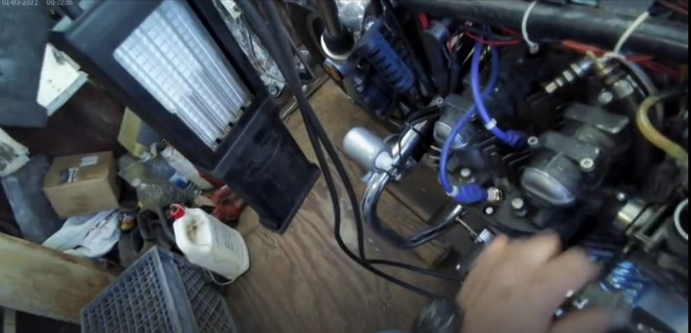

- Moose1800
- Posts: 299
- Thanks: 284
Re: Vm29/cb750 dohc (I know.....)
03 Oct 2024 07:28
<iframe width="560" height="315" src="" title="YouTube video player" frameborder="0" allow="accelerometer; autoplay; clipboard-write; encrypted-media; gyroscope; picture-in-picture; web-share" referrerpolicy="strict-origin-when-cross-origin" allowfullscreen>
