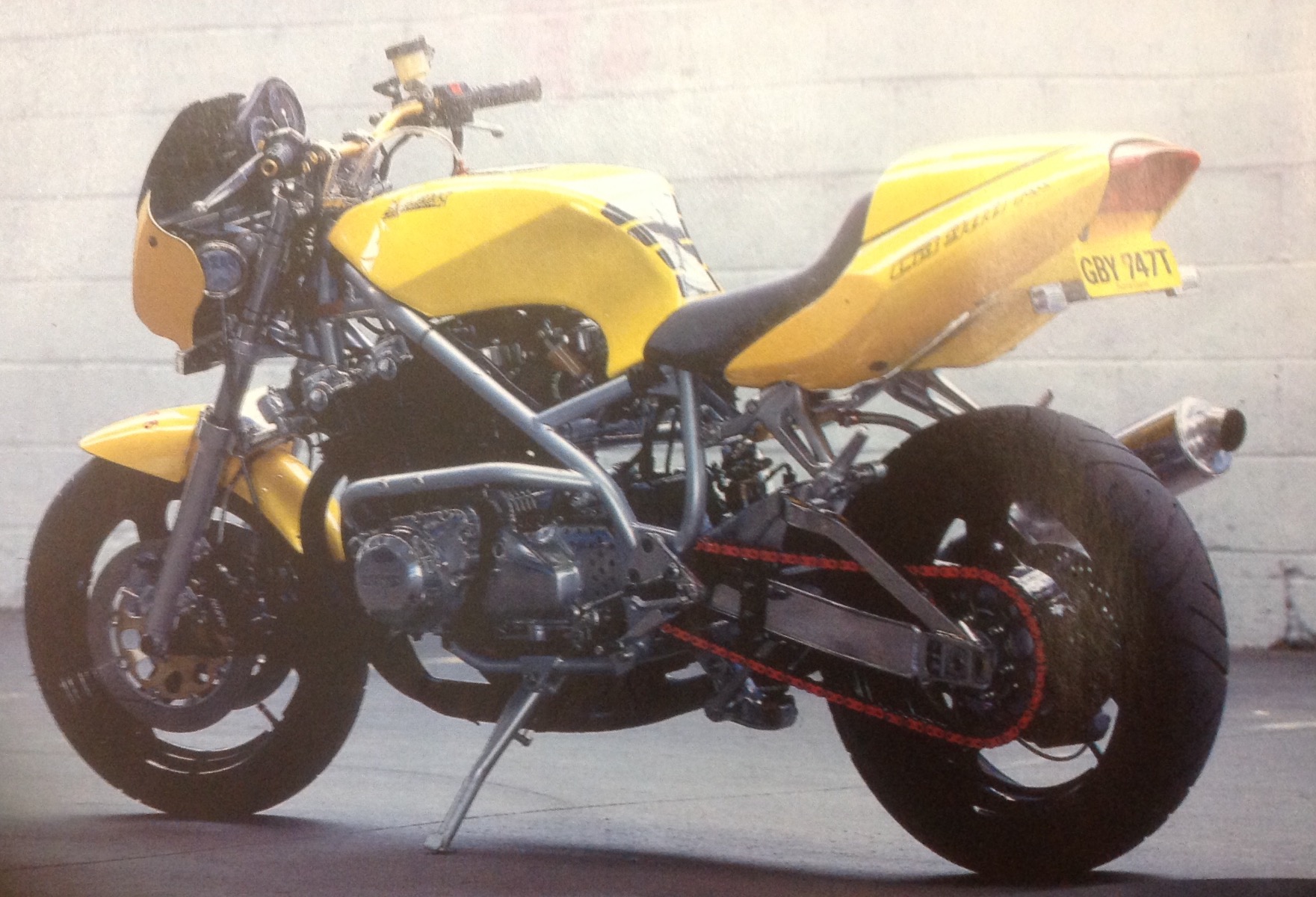

It certainly looks rich ? not sure why you think grinding valve seats is a problem (this is standard practice when overhauling a cylinder head)
Not sure why you moved away from the stock carbs, I used to run a Harris Magnum with the 1100 version of your motor (1123 Wiseco's, ported, pods, free flowing exhaust etc) the standard carbs with a stage 3 "dyna-jet" kit worked perfectly and it pulled strong
