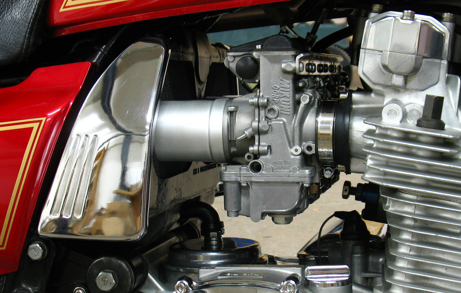

In case anyone is on the fence on getting the RS series carbs, do it. I just installed the RS34 onto my KZ900 and what a difference in power, Wow! I was running a set of VM26 bored to 29, the bike ran great but it just felt I was leaving some power on the table. I bought the 34 and dialed them in today, judging by my butt dyno I swear I gained 20HP. It carburates clean and pulls really hard from idle to redline. It feels like the bike is "uncorked" now. It'll rip my arms off when I really get on it, it's pretty addicting. I've run a set of RS36 on my ELR clone and was not disappointed with those either. Here's my jetting and mods to the engine.
1075cc MTC 10.5-1 comp pistons
Head porting
Yosh drop in cams .395 intake .385 exhaust
Vance & Hines 4-1 exhaust
Oil cooler
Mikuni RS34
125 mains
22.5 pilots
Needle in the middle slot
P-4 needle jet
Needle PDZH1
Float level set with the wet clear tube method at the top of the float bowl. That is 23mm float setting. Mikuni recommends setting them at 17mm but to me that seemed really high when I clear tubed it that set the fuel level about 2mm below the overflow tube so I lowered it. Haven't found a running issue with lowering it.
Idle mixture screw 1/4 turn
This gets me just about perfect. I've yet to vacumm synch them but they idle pretty good.

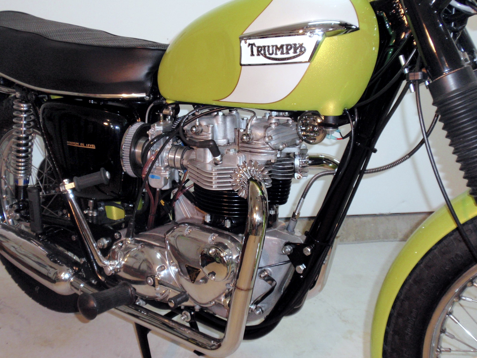

Another vote in favor of the Mikuni flatslides. I have a rack of RS34's on my warmed over KZ1000 LTD. Also, have a pair of RS34's on my '70 Triumph Bonneville (now 750cc w/ported head and cams). The throttle response is crisp on both setups. And the KZ really comes alive at higher rpms. No complaints here.

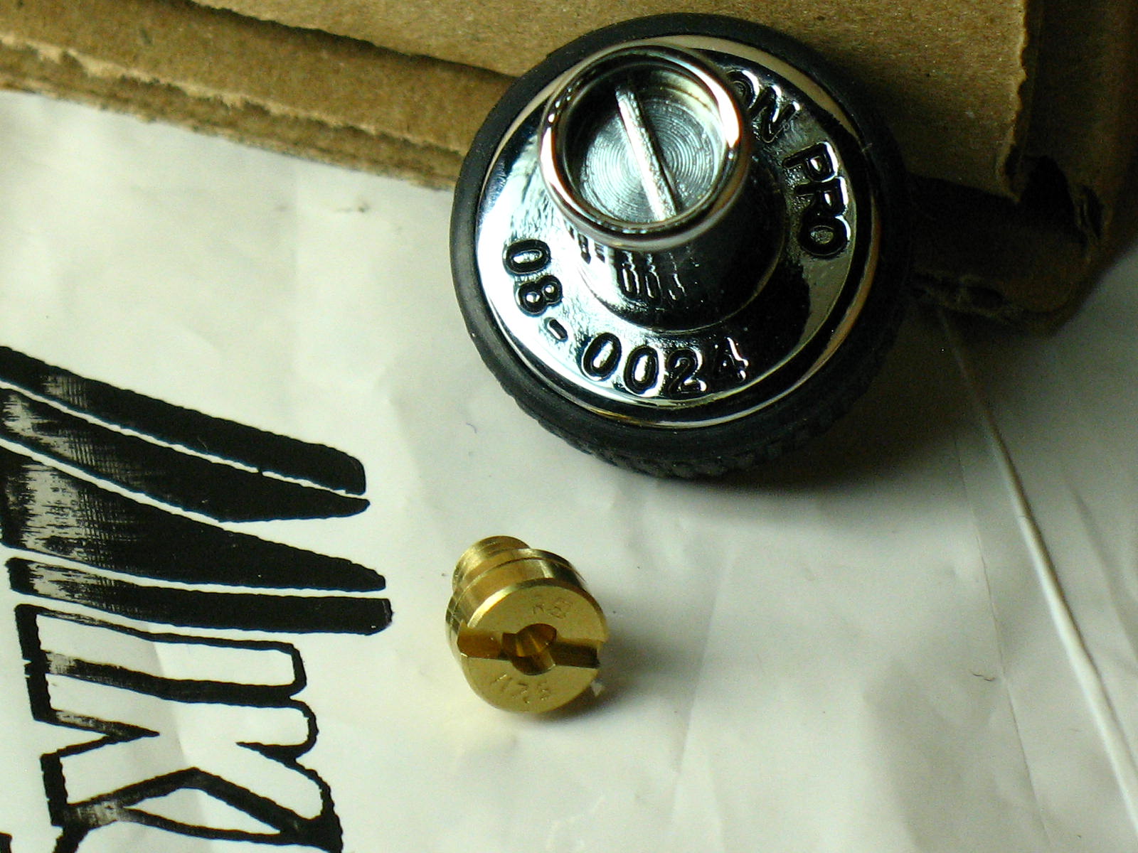

I found this nice little tool that makes on-bike main jet changes a breeze:

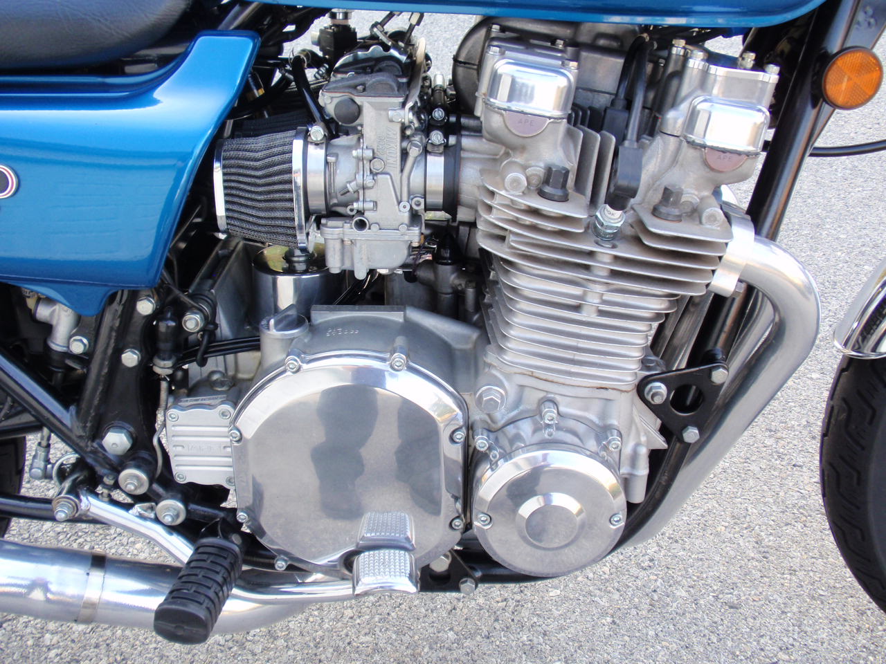

Yeah the ease of tune-ability is a major bonus. Changing the needles can be done with the carbs on the bike rather than dissembling half the rack. Heres RS-34s on my kz750 twin. The stock carbs on the twin are terrible in comparison.
