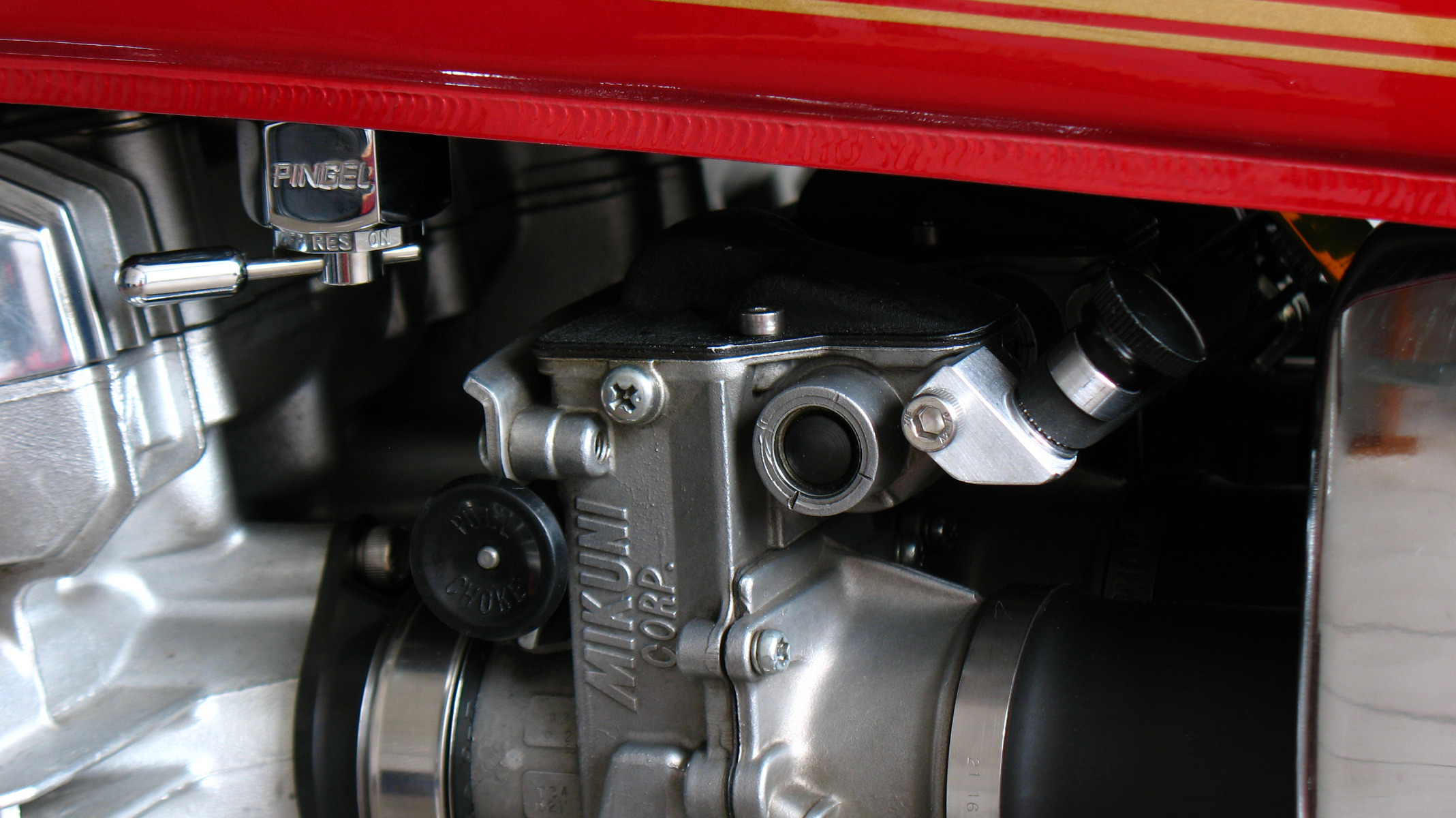

21 Mar 2020 11:02 - 21 Mar 2020 11:20SWest wrote: OK ya got me. MORE PICS :woohoo:
Reference to post: kzrider.com/forum/3-carburetor/611781-mi...arbs?start=12#815241
Took another dive into the remote idle adjustment giZmo, and rectified the issue.
It works!
:woohoo:
1982 KZ1100-A2/1170 sleeper 😀

24 Mar 2020 09:25baldy110 wrote: Very tidy Looks OEM, good job.

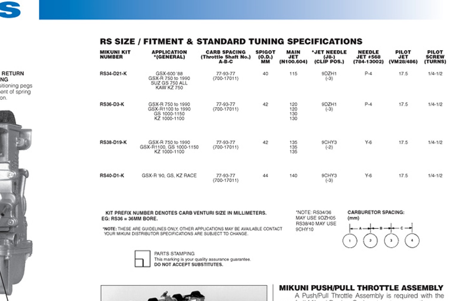

Need help. Are the settings for RS34 cabs I'm setting it up on my kz1000 p.. the bike is bone stockÂ

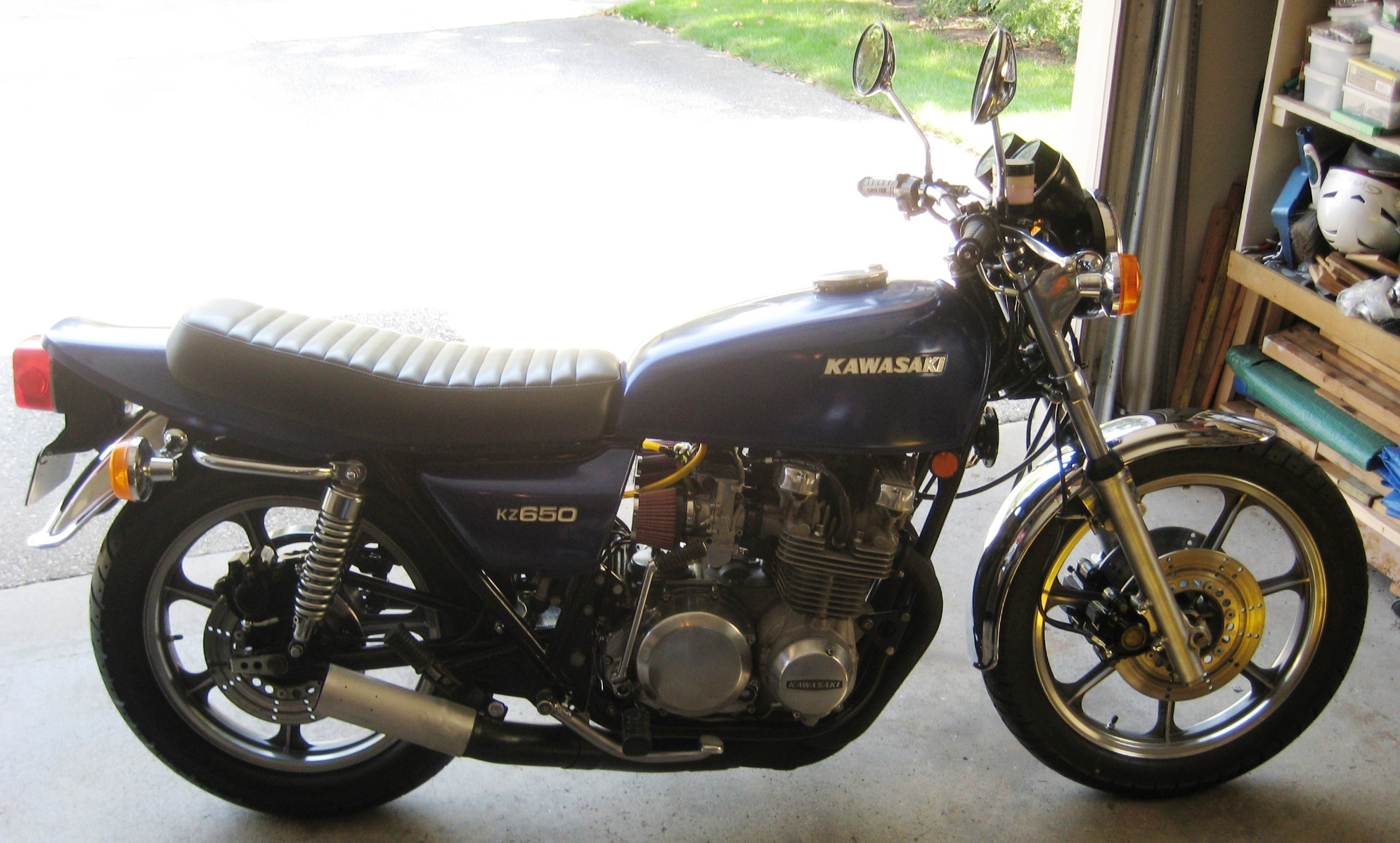

04 Jan 2024 14:14 - 05 Jan 2024 05:59Maybe someone running them on a 1000 will chime in.Need help. Are the settings for RS34 cabs I'm setting it up on my kz1000 p.. the bike is bone stockÂ
When you say bone stock you should also specify what you have for exhaust and filtration.
In the Mikuni Manual there is no jet listing for RS34's on a 1000 with because they start with a 750 (race carbs) there are jetting recommendations for the 1000 but for RS36/38's
I have a set of RS34's but they are on my 650 which runs a 831cc engine. It runs good with #20 pilots and #122.5 mains. These carbs would not run well on such a small engine but I have extensive cylinder head mods which makes it flow more than a GPZ1100.
Â
1978 KZ650B2 modified project
