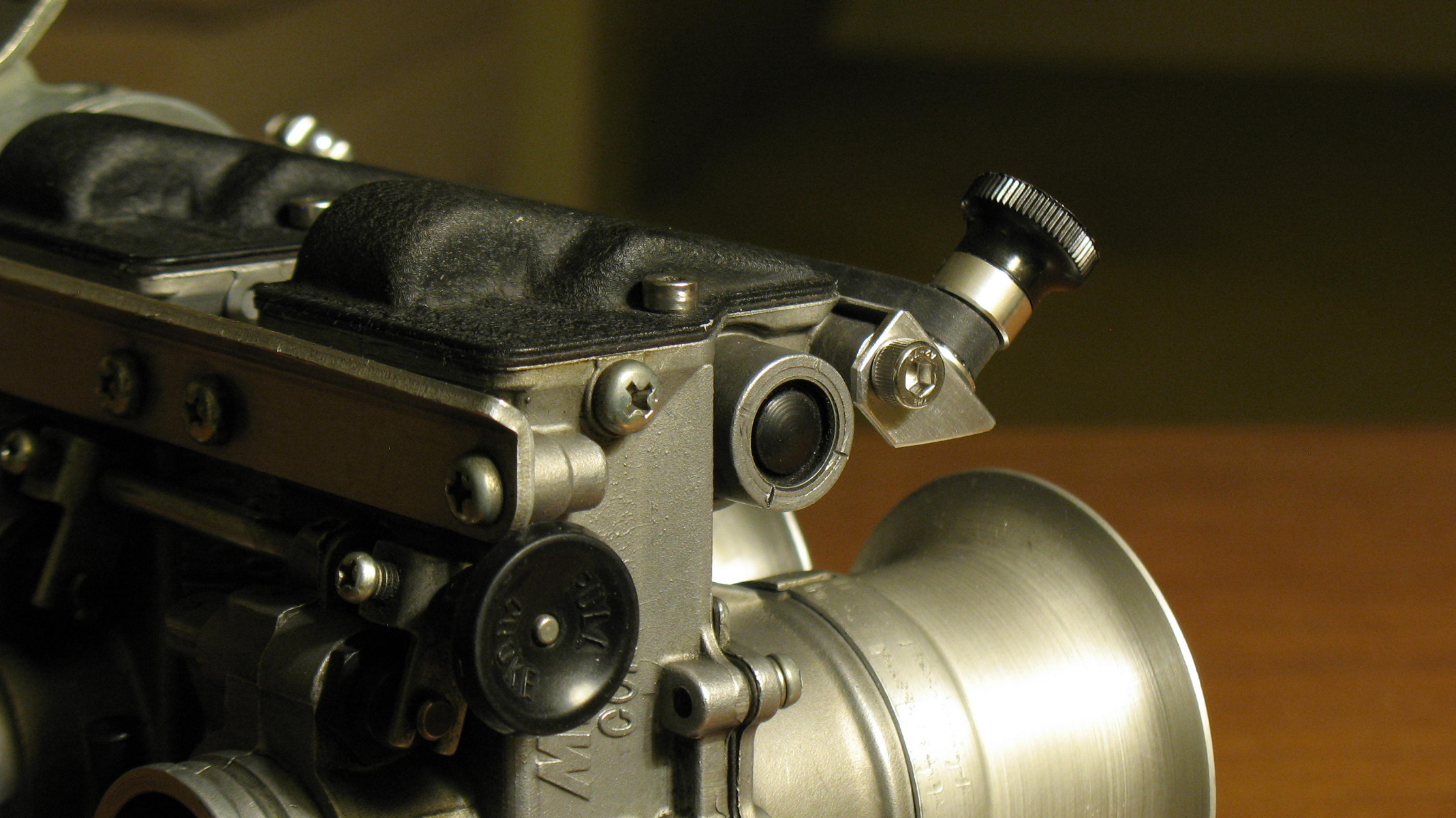

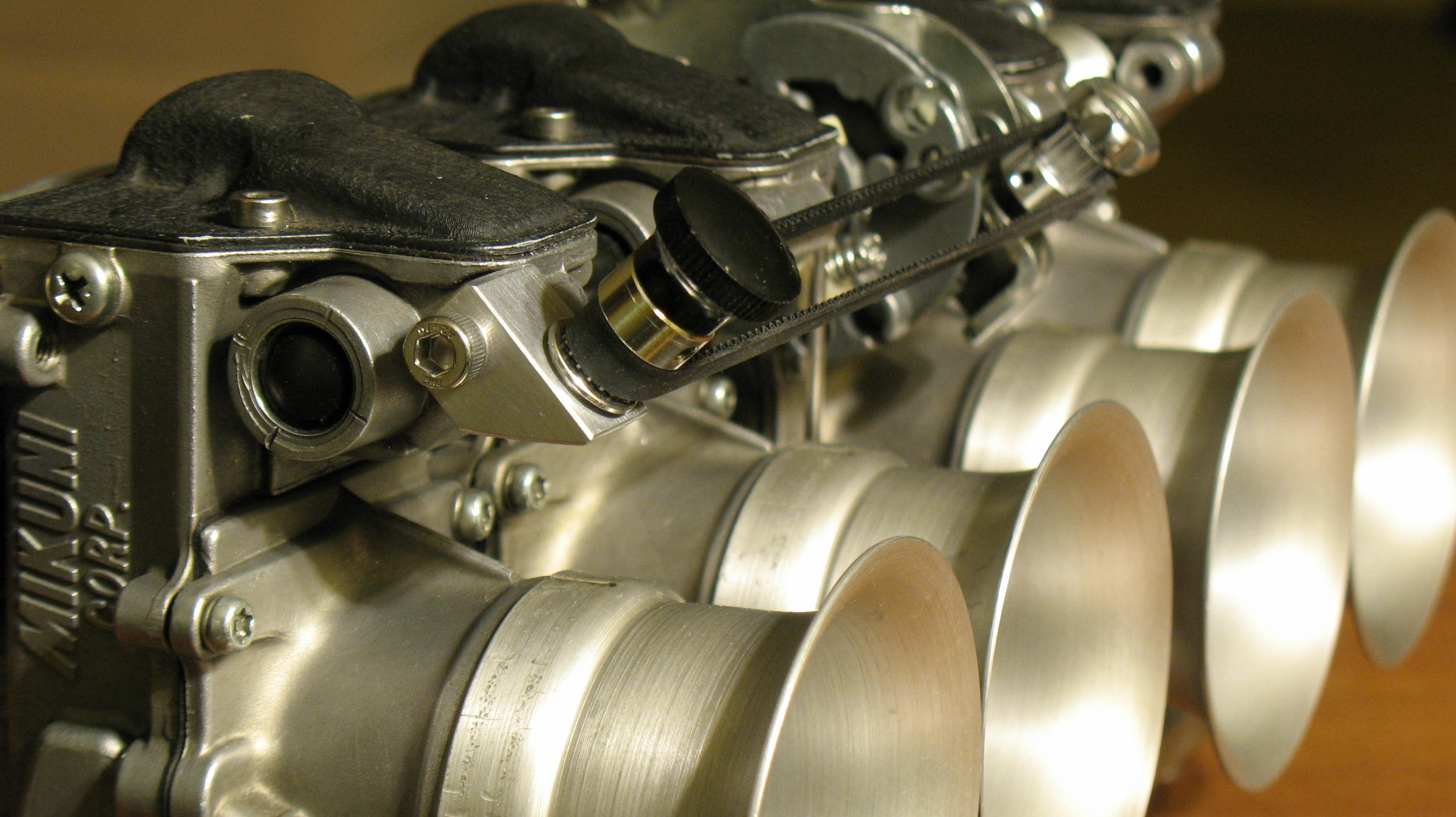

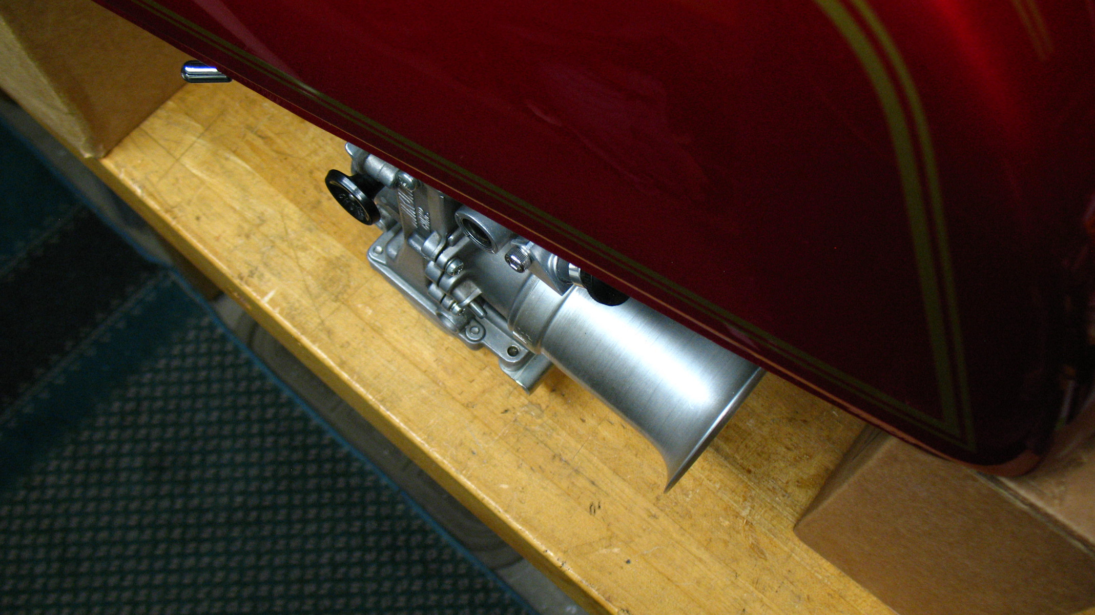

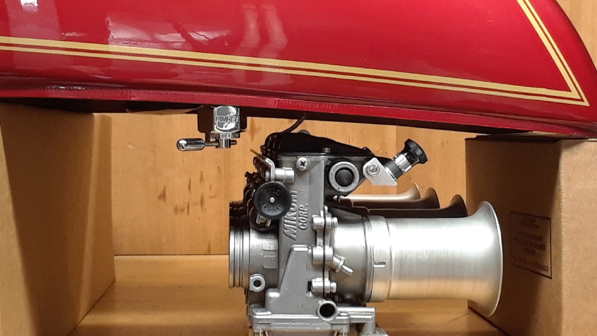

Finally grew tired enough of reaching halfway under the gas tank for idle adjustments, and decided my flabby problem solving muscle was due for a long overdue workout.
Any feedback on this idea is welcome and appreciated in advance.

Did you make the parts?
- daveo
- Posts: 3174
- Thanks: 899
Re: Mikuni RS34 carbs
11 Dec 2019 22:20 - 12 Dec 2019 07:45SWest wrote: Did you make the parts?
It is a conglomeration of parts from several sources, except the support bracket which was fabricated from aluminum angle.
Installation is simple. The original idle adjustment screw is replaced with a new one, then the drive belt is fed around both pulleys as the bracket is positioned and snugly bolted down with the cap screw. Then simply start the engine and set idle.
