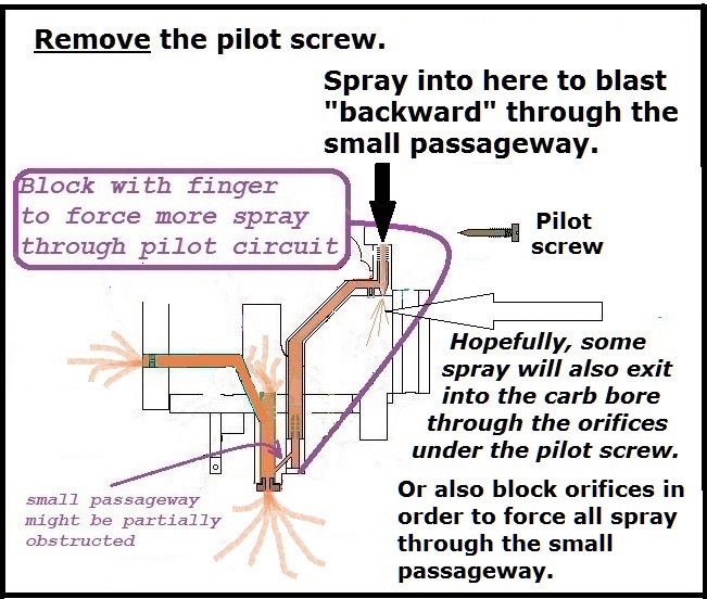

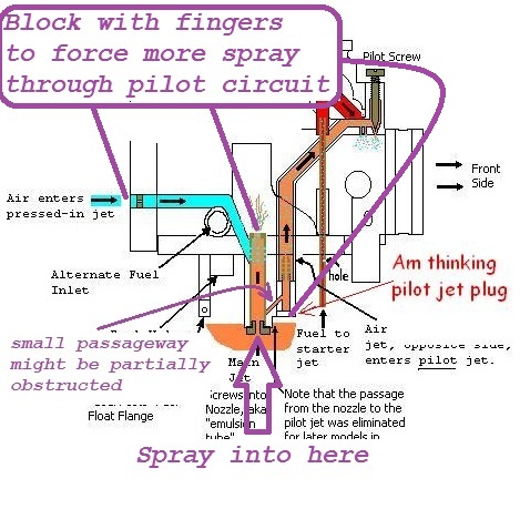

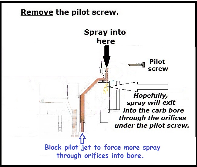

Would find and study the pilot circuit in the particular carbs at hand.
In each CV carb, regardless of exact model, there are probably several paths whereby carb cleaner may be force sprayed through the various sections of the pilot circuit.
Try to block the already clear exits before spraying so that full spray pressure will go through the target unclean area.
And be sure to clean the small orifice(s) into the main carb bore.
Here are some examples to help explain the idea.
And also be sure to wear eye protection when spraying carb cleaner, because the spray always backfires. ALWAYS.

Patton, thank you for the extensive drawings. Took the carbs apart today and will blast out tomorrow. I had previously (should have mentioned it before) replaced the #4 carb with one that did not have the "Coasting enricher" and I'm not sure if that makes a difference. The other 3 carbs are numbered with "1356". Before removing the carbs from the engine, I set the external Pilot jets to 1-1/4 turns as you suggested. The engine started and ran without the choke on and sounded really nice and even accelerated when the throttle was twisted but I believe only on #1 and #2 as those pipes got hot (500, #1 and 450 #2) and the other 2 didn't (you could hold your hand on them). Definitely NOT GETTING FUEL as the spark is great. Upon disassembly I found that #1 and #4 main jets were labeled "R210" and #2 and #3 were labeled "R217". I do have 2 more spare carbs that have "R210" jets. I have no idea of the difference but think they should all be the same lol. Attached is the picture of the 2 carbs, 1 with the "Coasting enricher and 1 without. I can't thank everyone enough and please keep the info coming. Thanks, jon

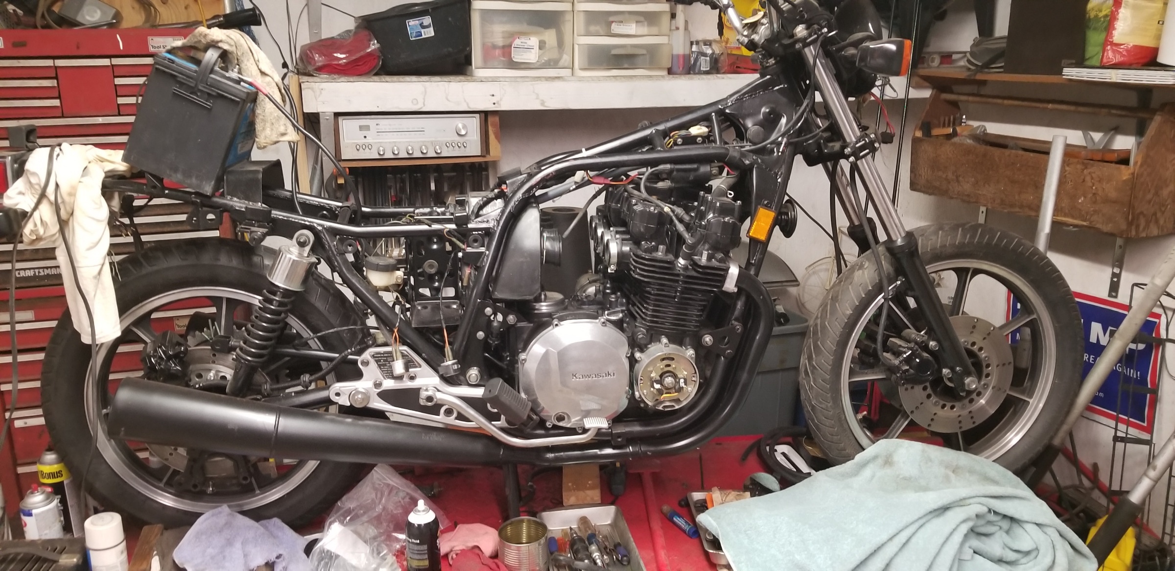

Hey Steve, Attached are 2 pictures. One is the bike with the carbs removed while being rebuilt and the other is a picture of SOME of the plugged exhaust debris coming out of the right side. It was about an inch thick where it piled up in the corner lol. Thanks for your interest. Have a great day, Jon

Looks like baffle material. Can you pull the baffle out? I wonder if there's critter in there.
