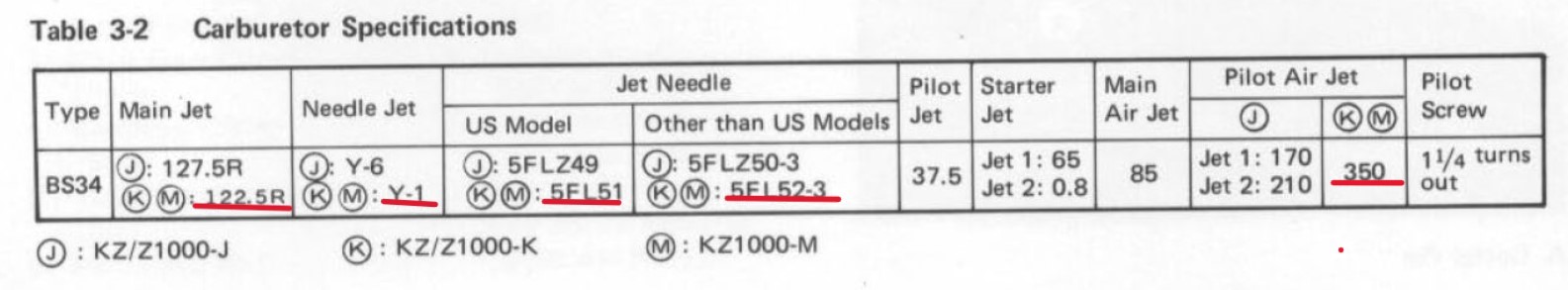

Re: 1981 KZ1000J CARB ISSUES NEED ADVICE
04 Nov 2024 11:36 - 04 Nov 2024 11:56
Carlos are you using the jetting and needles from your original carbs or the replacements, you posted that your mains are 127.5 which according to the info Daveo posted is for a "J"
"J2 jetting and needles are different because the "J" uses bigger cams to produce the additional horsepower over your "K" model (CMNSL's data also suggests the adjustable needles you have are possibly not right for your model ?)

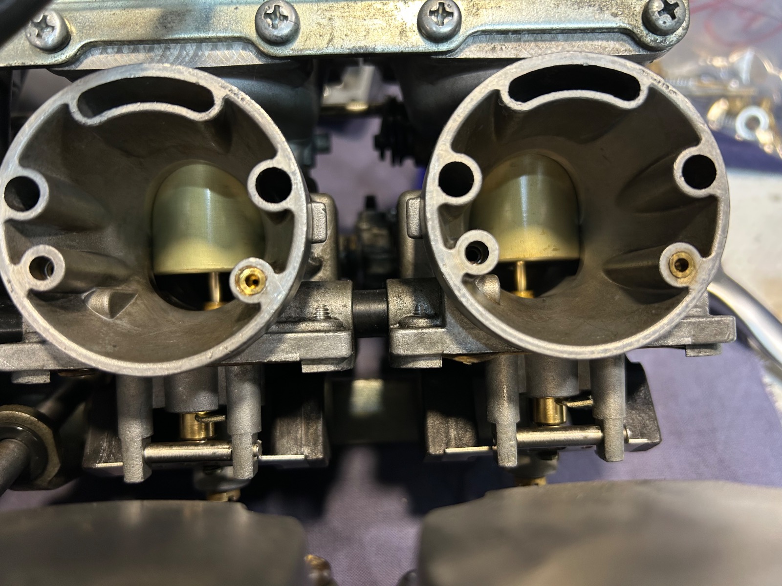

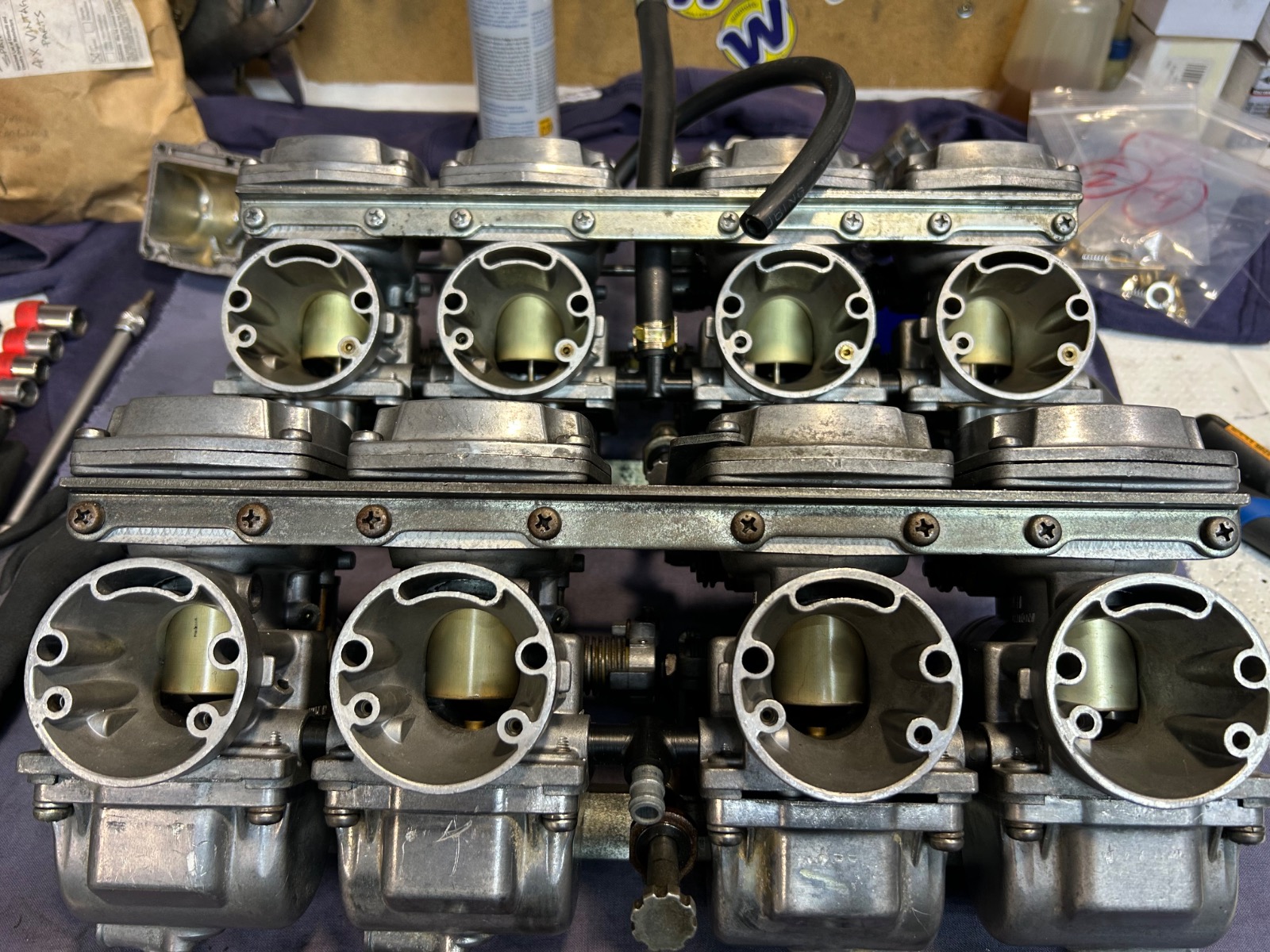

01 Jan 2025 23:04
Guys, happy new year!
Back to the thread, I have to apologise to the entire community, as I’ve been making you waste your time.
i have been running 127.5 jets all round, so no wonder the bike was running rich. For some reason I wasn’t in my mind, but obviously I was wrong. These were the plastic ones
i will be ordering today a set of 122,5, and possibly try on the 120s I have.
I am already in touch with Zed1015, and I will still do the plunger thing.
By the way, comparing my old set of carbs with the “new” ones, I realize they have some additional part that looks very much like the restrictors Zed1015 sells for pods.
is this right? I am using a standard airbox and filter. Please see pics for reference. Upper in pic new, lower old.
again; sorry for the bother and running around like a headless chicken
- Posts: 8115
- Thanks: 3495
02 Jan 2025 06:56
Hum, those brass metering jets are very curious. I've never seen anything like those on an OEM set. They are almost certainly air restrictors, which will increase how rich the bike runs. One of our local carb guru's, Clay (asphalt900), mentioned to me that restriction jets like those have been around for quite some time (no disrespect to zed1015, who sells them currently). There is no slot that I can see in these, which suggests they are pressed in place. You could remove them and see how the bike runs. Hopefully, removal won't destroy them.
